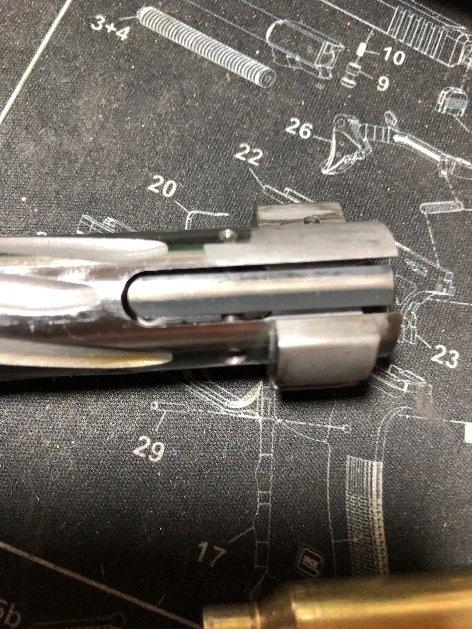

I just got this in from MidwayUSA.
The bolt and extractor are PTG 308 bolt face. Is the fitment correct? It seams to work here in my loading room, it just looks like a lot of room.
No, that's not right.
Also, check to make sure the bolt face is concentric with the OD. There have been several reports of bolts being shipped out that were machined off-center.
Ok, looks like that’s my problem. Went back and looked, it is a mini. Midway doesn’t carry anything thing but the Badger. Will that go in without much fitting? Or should I go with something different?
