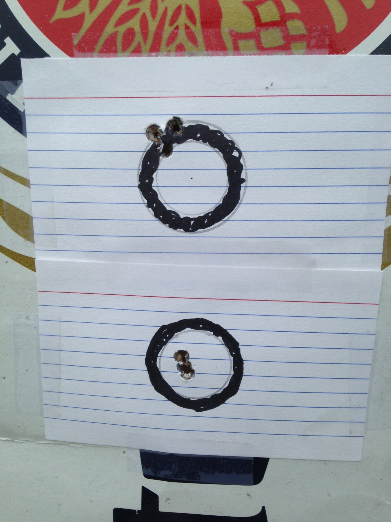

    I'd catch the rem 700 on sale for under $300. Here's my junky rr prefix $296 bone stock 700 action with a criterion barrel and zero load development. 6 consecutive shots at 100. 870 is as far as I've had it and it's sub there also. If I was gonna spend more that 300 I'd get a Origin and throw a barrel on it. Don't know how cheap your wanting to go but just thought I'd try to help out.
    I'd catch the rem 700 on sale for under $300. Here's my junky rr prefix $296 bone stock 700 action with a criterion barrel and zero load development. 6 consecutive shots at 100. 870 is as far as I've had it and it's sub there also. If I was gonna spend more that 300 I'd get a Origin and throw a barrel on it. Don't know how cheap your wanting to go but just thought I'd try to help out. View attachment 7064365
    Ya I did a remage .224 Valkyrie with a criterion and I’m pretty impressed. That’s damn impressive though....I’d like to do a custom switch barrel with the WTO recoil lug and with all that said I think a stock action won’t be best for this one......I’ve found a place that sells trued/blue printed rem actions and a person can get more done but by that time the origin still is on top for price, versatility, ect.
