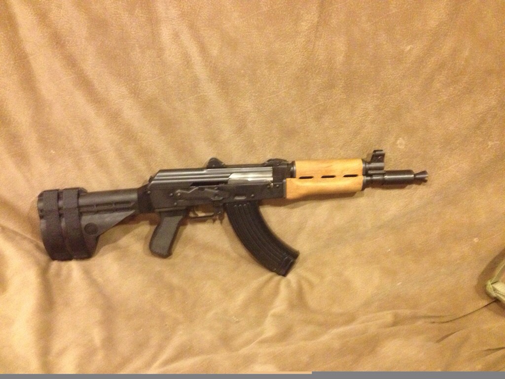

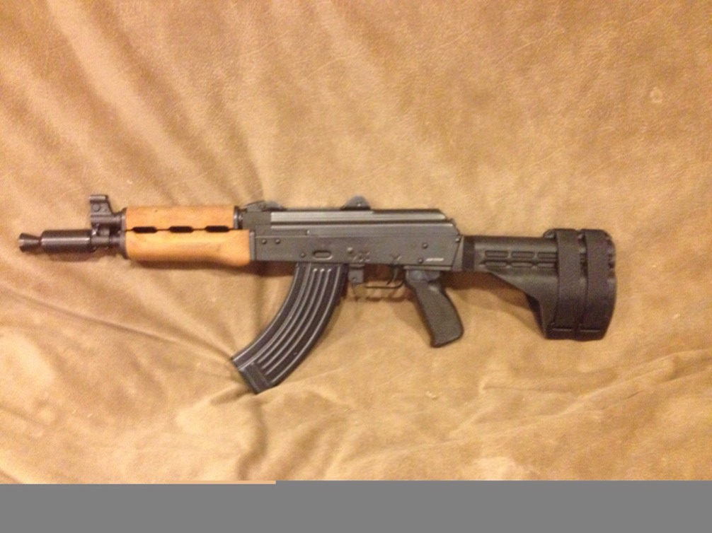

Hey guy you can do what you like but give one of these a look. After testing it was and I have checked this myself, even with just a 10.25" barrel the7.62X39 still has a muzzle velocity of 2100 to 2150 FPS. With good ammo shoots 1-1 1/2" groups at 100 yards.
Sent from my iPad using Tapatalk
