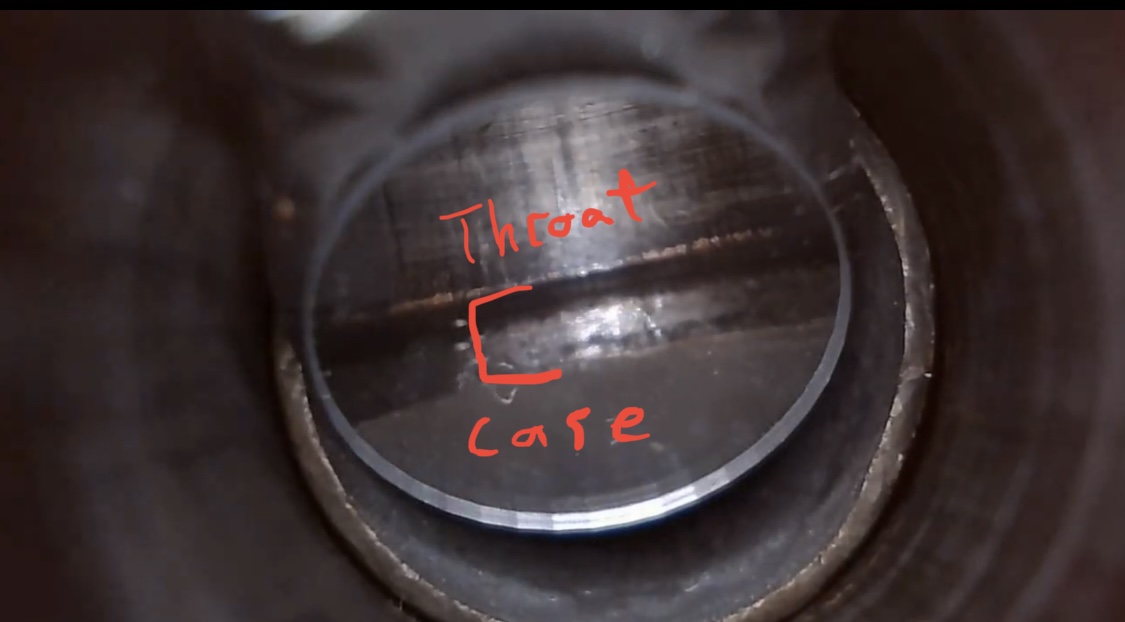

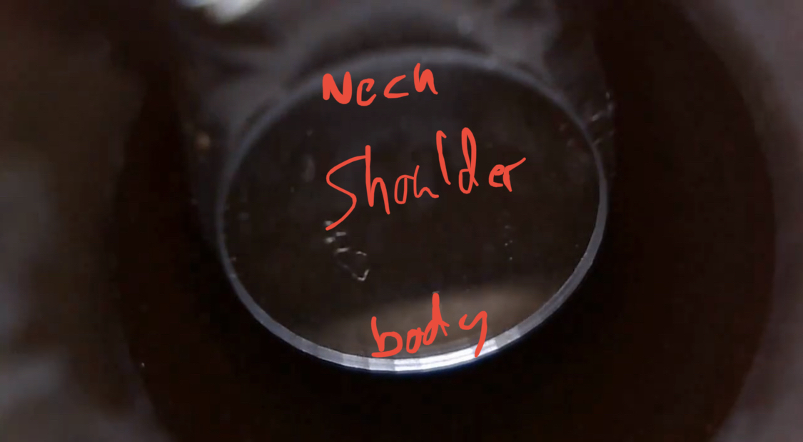

Thanks for the help I’m gonna try this. I got a Borescope and here is a pic I’m guessing this is the carbon ring

thanks man how long would you let it soak/sit in there for? Also never looked into bore before can you help me interpret the pics
Soak it for 10 minutes, scrub and check
Stick a fired case in the chamber and feed the camera in from the muzzle end. You’ll see where the case ends etc and the exact relationship of where you’re cleaning.
But you have a build up of crap just beyond the case mouth. You want that heavy black brown crap out.

Ok got ya. What about the lighter silver band? Is that part of carbon ring I’m looking to remove? Thanks in advance

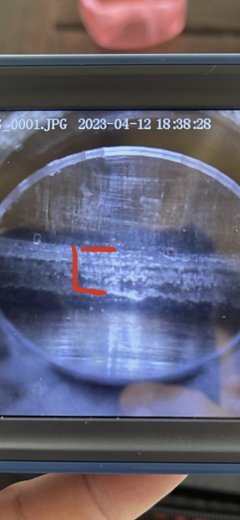

I couldn't make heads or tails of his pic....not even sure which direction is the chamber vs the muzzle.

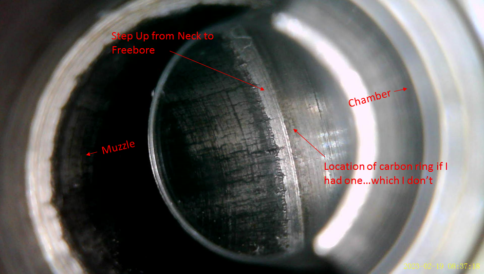

I get it about the step to the throat, but where exactly in this picture do you see his ring (if anywhere)? I couldn't tell.

I don’t really. I’m just assuming what he could be describing is this section which is already clean.
Reactions: Baron23

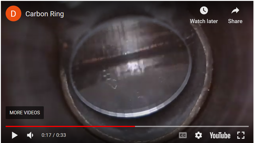

Ok so i was not even taking a picture in the right place. I put an empty case in and recorded where the ring is. Looks pretty thick with carbon

Below is a pic of my chamber on a 6.5 CM barrel with 2,400 rounds on it. It was just soaked in BT Eliminator for 36 hours using a PVA Muzzle Jimmy then JB Bore Cleaning Compound (the blue...not the red label) on an oversized patch (1 3/4") wrapped around a Parker Hale style jag like rolling a cigarette (or I guess a joint if that's what you are into! haha).
This is how @Frank Green told me to apply abrasive cleaners (and any errors are mine, not Mr. Green's). There is no carbon ring to show...cause I cleaned the fuck out of it... but you can see the faint markings in the pic below where it forms, if there was one. This is between the end of the case neck and the angled step up to the freebore (step up is shown on those chamber drwgs I sent in our PM thread, right?).
I just got the JB recently and used it on this older barrel figuring if I screwed it up it was not a big loss as its a reasonably high round count barrel. Turns out I did absolutely zero damage to the barrel so I feel confident in using this technique on my much newer and rather expensive Bartlein 400BBMOD barrel.
Hope this is at least slightly helpful to you and I'm more than willing to be schooled by my betters here on the Hide if I'm wrong about any of this (which is quite possible). Cheers

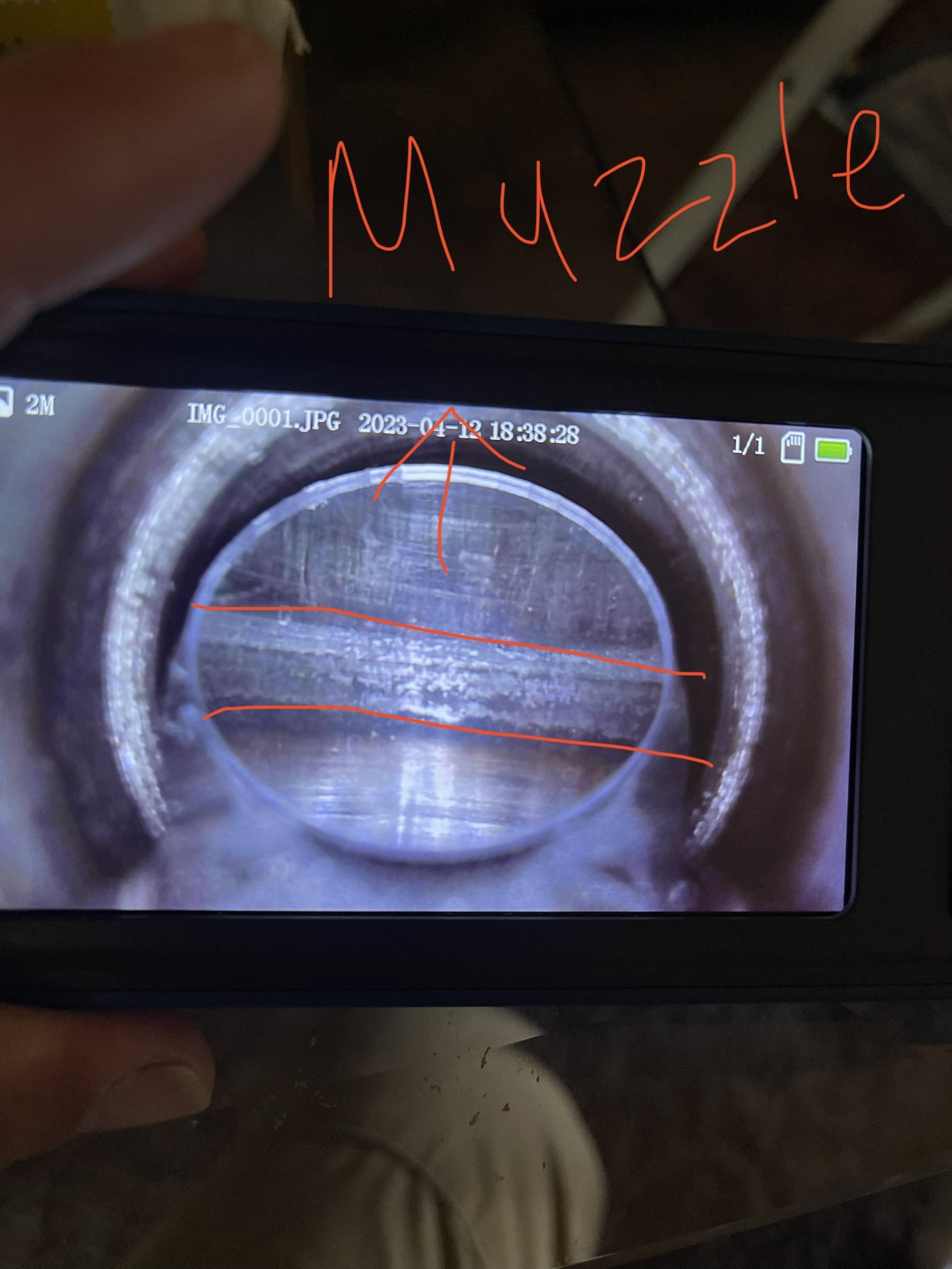

You were taking fine pics in the first seconds of the video. Then you stuck the camera into the case body and spun it around for the a bunch of the time.
You can see where the case mouth ends.
If the barrel is holding onto your bullets you need to clean the throat where the bullet would be held at beyond the end of the case.
You also need to clean your chamber.
Soak it and scrub. Is the black stuff gone? No? Then do it again or try something else until it is.

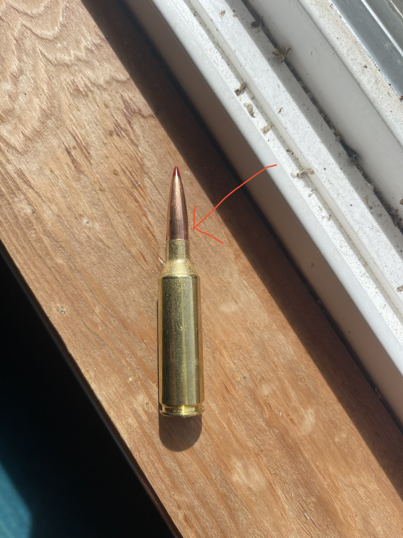

When im spinning the camera i thought that was right at the edge of the casing and i thought that black ring was the carbon ring. The picture below is a cartridge that I chambered and ejected and it left a ring around the projectile so im guessing that is where the carbon ring is grabbing it

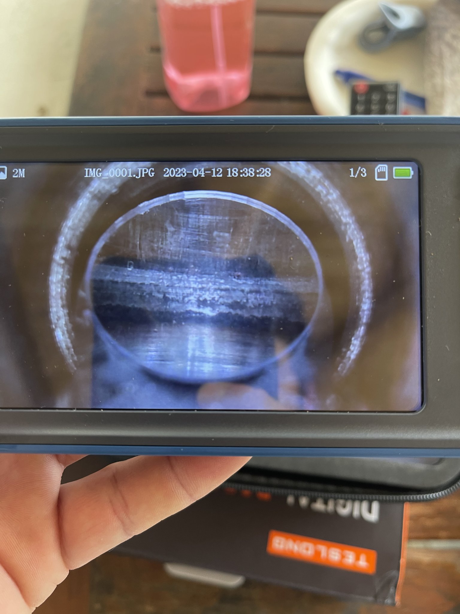

Ok I took a better video I think I chamber the casing while im recording so I can see better where it ended. Looks like the carbon ring is right in front that especially since it matches the live cartridge with the ring on the bullet. Thank you @spife7980 and @Baron23 for helping me and answering my noob questions

@lose_money another thing to consider now that you have a bore scope…..use it to set your trim length as close to where the chamber meets the free bore. After firing your next batch put a couple fired cases in the chamber, and use your bore scope and find one that is close to the freebore and use that length as your trim length. It will help prevent the next carbon ring from developing
