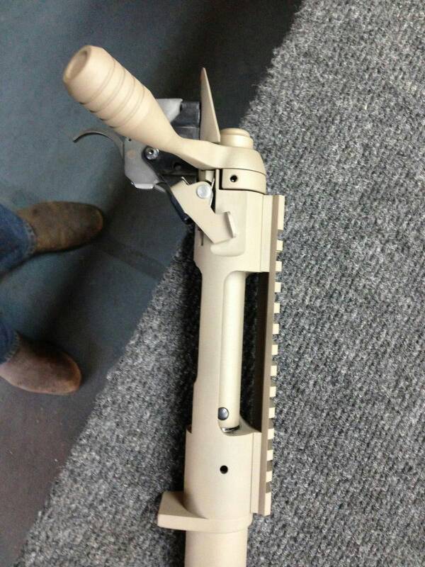

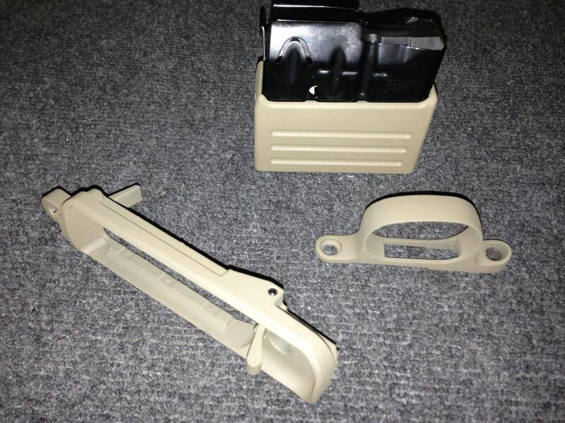

Oh, also, look up Phoenix custom rifles. Excellent quality and i believe they are getting caught up on builds and are only a few months out on their complete builds. They just did a rebarrel/brake install/misc machine work and cerakote for me and I'm am very pleased with the quality
