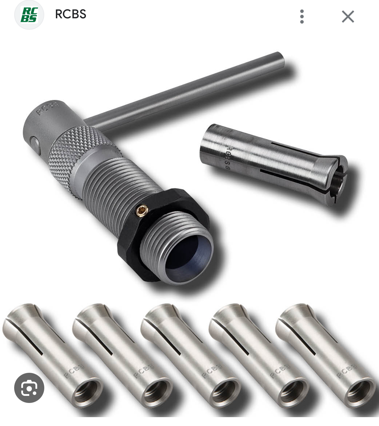

As long as you use a collet puller, you can safely pull the bullets, and even reload them when you fix the mistake. This is the setup I've used for 15 years, and it's been great.

If you're looking to buy a collet puller, I much prefer the Hornady Cam Lock puller over the RCBS / Forester style collet pullers. Much easier to use. I have used both.
Another vote for the Hornady , I have both and the RCBS never gets used .

You don't have to spin the collet screw clockwise with a long pin lever to lock onto the bullet and then unscrew it. With the Hornady Cam lock, you pull down a lever to lock onto a bullet and lift the lever to unlock the collet. Just ergonomically better / quicker.
I agree with this.
I have both and so I might add that the RCBS tends to over torque the grip on the bullet causing some deformation, where the Hornady's cam lock makes it a little easier to control the amount of grip. I use the Hornady in my Forster Co-Ax, and though it's a little awkward with the way the cam lock handle not quite fit in it's fully vertical position, it does make quick work of pulling a bunch of bullets when needs be.
Reactions: supercorndogs
That does sound nice as opposed to the RCBS which is the only one I have used. How is the condition of the bullets after pulling? Have you ever ran into one it wouldn't pull?
The Hornady pull collets are similar (But not interchangeable) to the RCBS collets. From the various bullets I've pulled, I haven't noticed any nasty pull marks.
Most of the bullets I pull are reloads with reasonable neck tension and no crimp. I did pull about 150 bullets from some WW1 M-1906 ball ammo to salvage the bullets & powder since the primers were hang fires. No marks on them.
Pull marks will come from ammo that has very heavy crimps.

Get a grip-n-pull.
You can run the expander ball extra long without the decapping pin to remove the crimps.
That's what I use. The cam lock is probably better for doing a lot of rounds but I normally don't have to pull more than 50 at most so the grip n pull is super fast. I had a guy here 3d print me a block that also had a recess for me to install some magnets so the block locks right onto my press and I don't have to remove the dies from my turret press. As long as I have an open spot, I can always pull bullets, then take the block off and go back to whatever without any changing of anything. It's a nice set up I must say. Wouldn't want to do more than 50 or so that way though.
