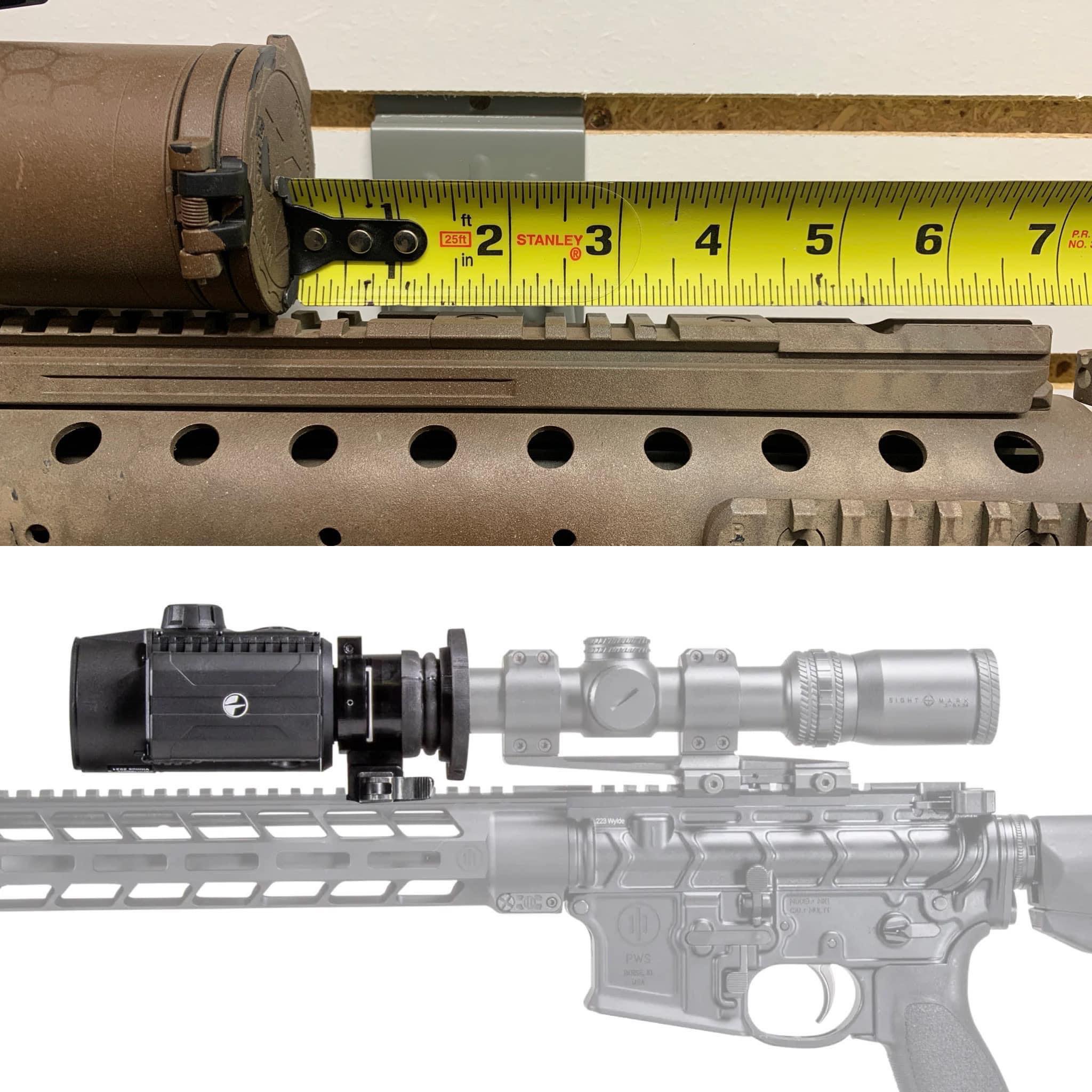

I'm trying to get into the thermal game, but its been a HELL of a time talking to different companies, reps, and Pulsar to try and get any actual dimensions or info to see if it this thermal will work. All they seem to be able to say is the overall dimensions I can find everywhere.
I hope someone here with one can do some measuring or can actually give some legit input.
Wanting to put a Krypton on my MK12 with a NF ATACR in a 1.3" badger mount. It has the SPR rail that is about .450" thick so Its effectively a 1.75" optic height and I'd like to avoid going any higher because of the already less than ideal cheek weld.
I got a measurement from a friend on the height of their pic mount and he said its about 1.480... will that offset make viewing the display shitty or even possible?
I saw someone else selling one on here that looked like a NF scope ring in place of the Pulsar Pic Mount, what is the OD of the eyepiece on the thermal? Is that a viable mounting option? I could just buy a scope ring at the 1.3" height and use it?
The other question I have is because of the weird spacing of the pic slots on the MK12 rail, how much does the distance from the scope to the thermal matter? Obviously different scopes have different bell/lens depths from the outer physical bell housing, but how much can you get away with or how close can the Krypton mount?
I'd happily pay someone to take some measurements for me or help me out if you can.
Thanks gents!
