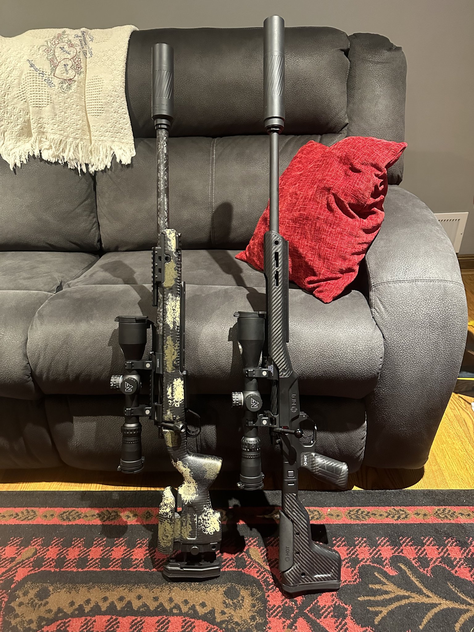

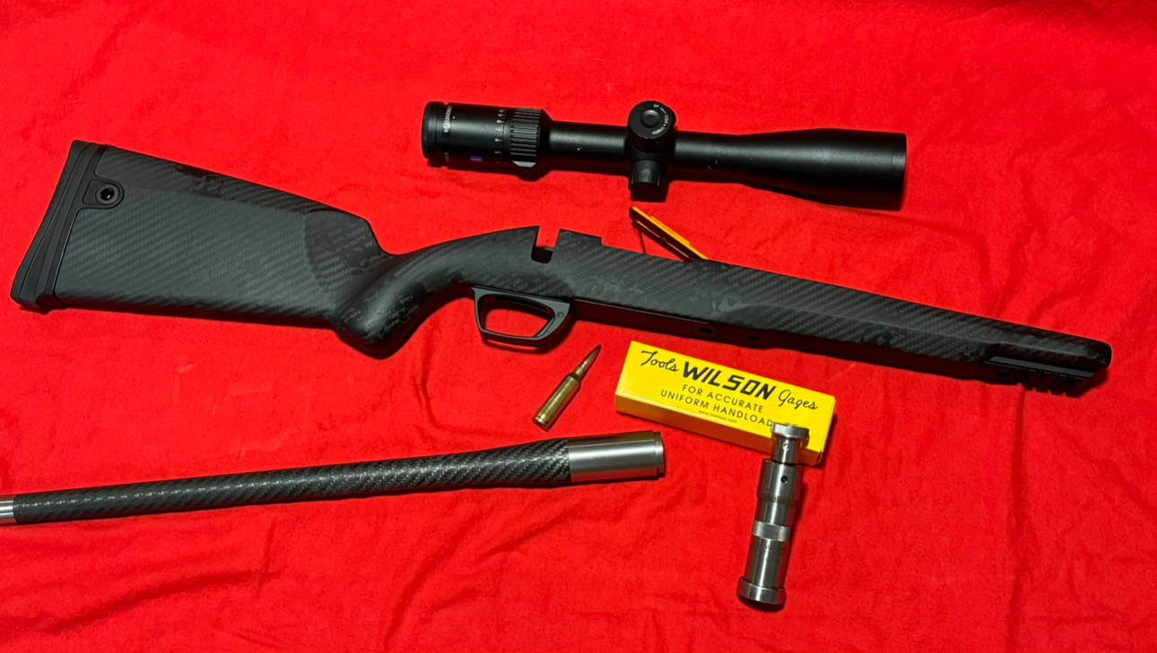

My gunsmith and I just bought 2 SA mag bolt face SKLTN’s for 7-6.5 PRCW builds, it’s very much like a Defiance AnTi but has a 75deg bolt throw, It weighs the same weight as a Defiance XM length AnTi action, 21.9oz
Hopefully my rifle is together in the next cpl of weeks and can give you a better review on some practical use.

What stock is that?
I've handled several, both steel and titanium. I think they are fantastic. I'm still partial to the BAT vampire/bumblebee, but have seen no reason not to like the skltn.

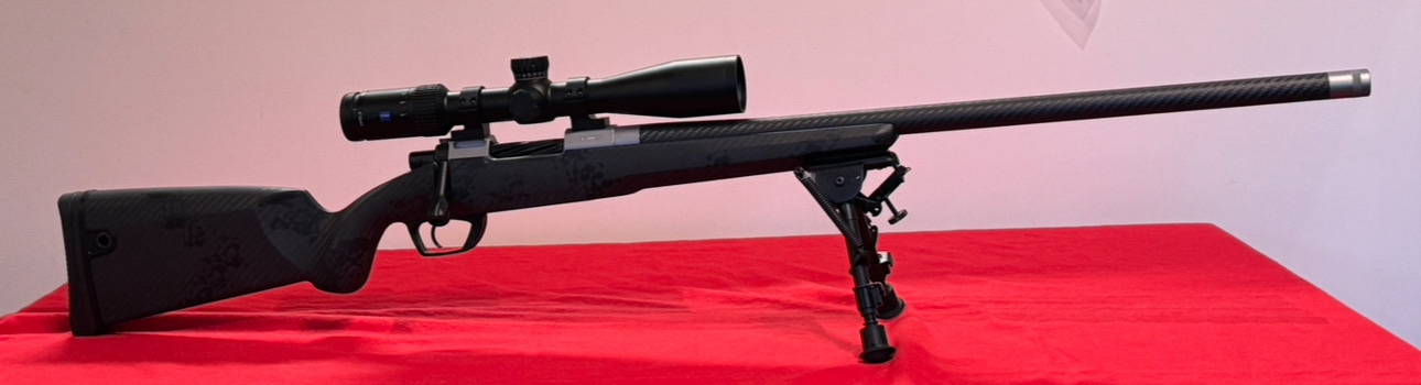

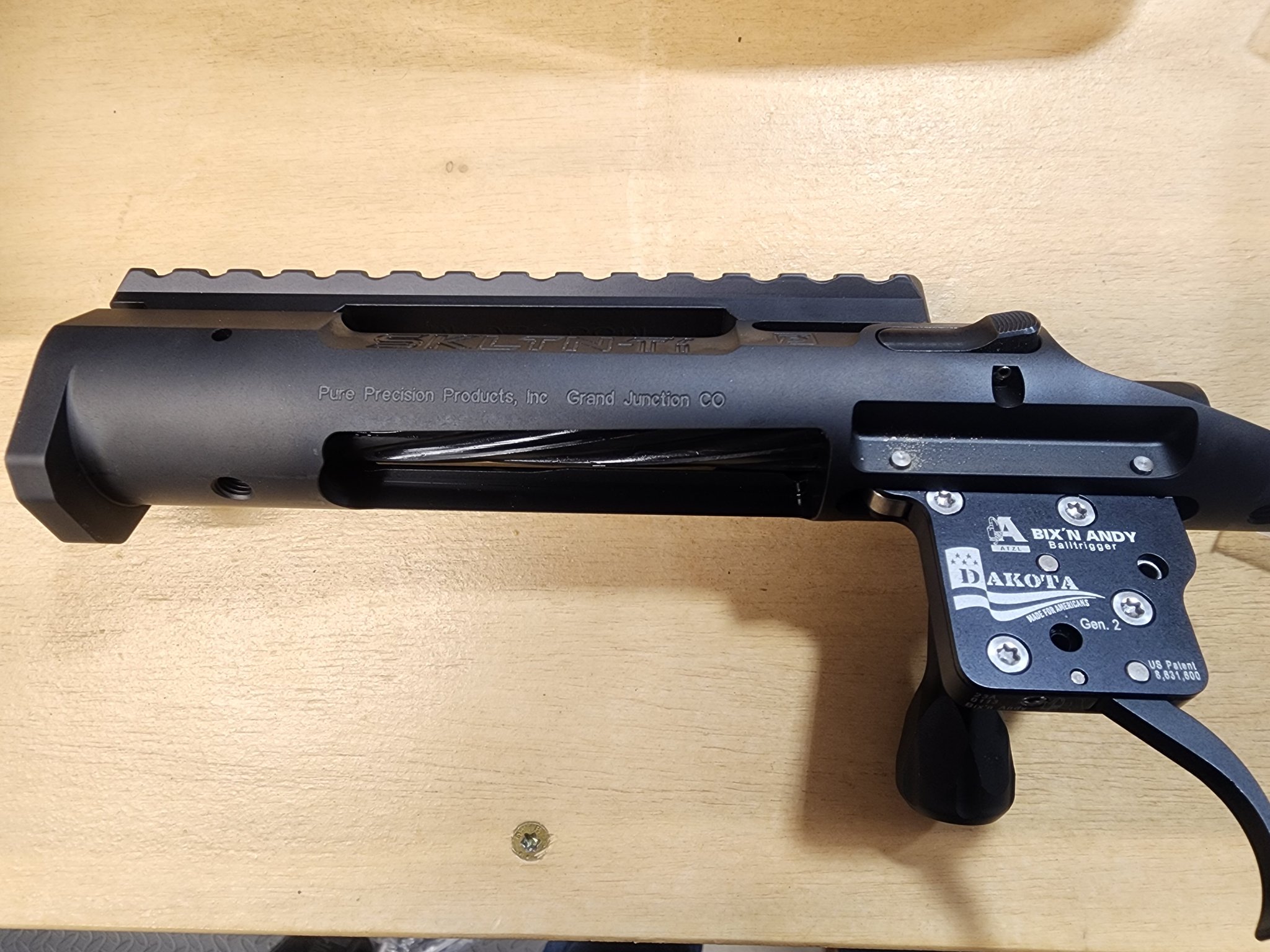

I ordered the Ti Summit. At first I thought it was heavy and rough, greasing it good and cycling it a bunch over the course of 2 weeks helped it a bunch, on e I got it barreled and 2 dozen rounds thru it, I'm much happier with it. It's pretty smooth, some binding but only when I don't ring the bolt straight back. Overall, I call it good enough for a night hunting rifle. I will admit, in spoiled by my Zermatt TL3s and Ti3s. But it's far from apples-to-apples here due to the bolt throw.
1100$ or so vs the Ti3 at $1800, you decide, I'm not giving up any Zermatts for this, but for the guy who looks at these and says a barreled action or just the action at about the same price...this is a logical choice and a good one at that.

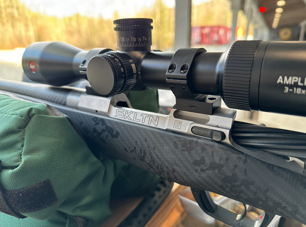

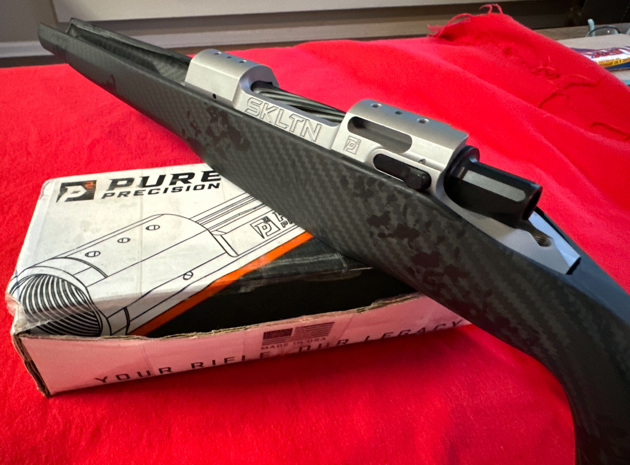

A little review on the Pure Precision SKLTN action, overall its an excellent action, I really like the 75 deg bolt throw and the tool less firing pin assembly is a nice option as well, I have about 200 rounds through my 7-6.5 PRCW and fires and feeds perfectly, both our SA were a little weak on extraction of loaded rounds or fired cases, you definitely have to be firm with your cycling of the bolt,
I've chambered barrels for at least 10 of them. The headspace and thread pitch is prefit compatible. The firing pin assembly is tool less for removal; which I really like. The customers have been extremely happy with them.

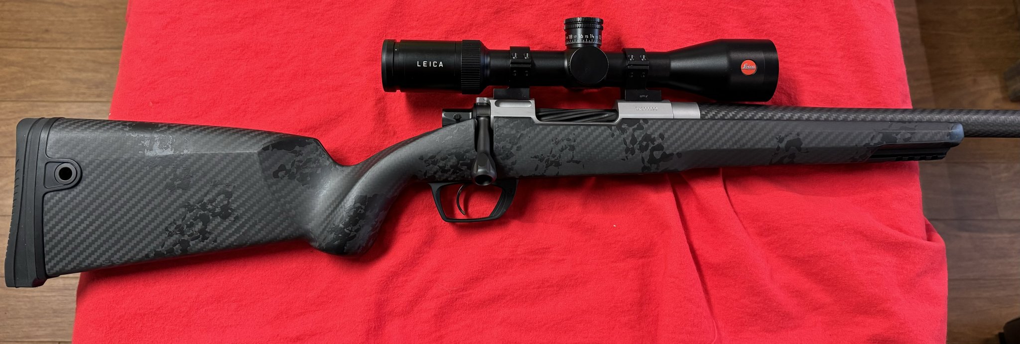

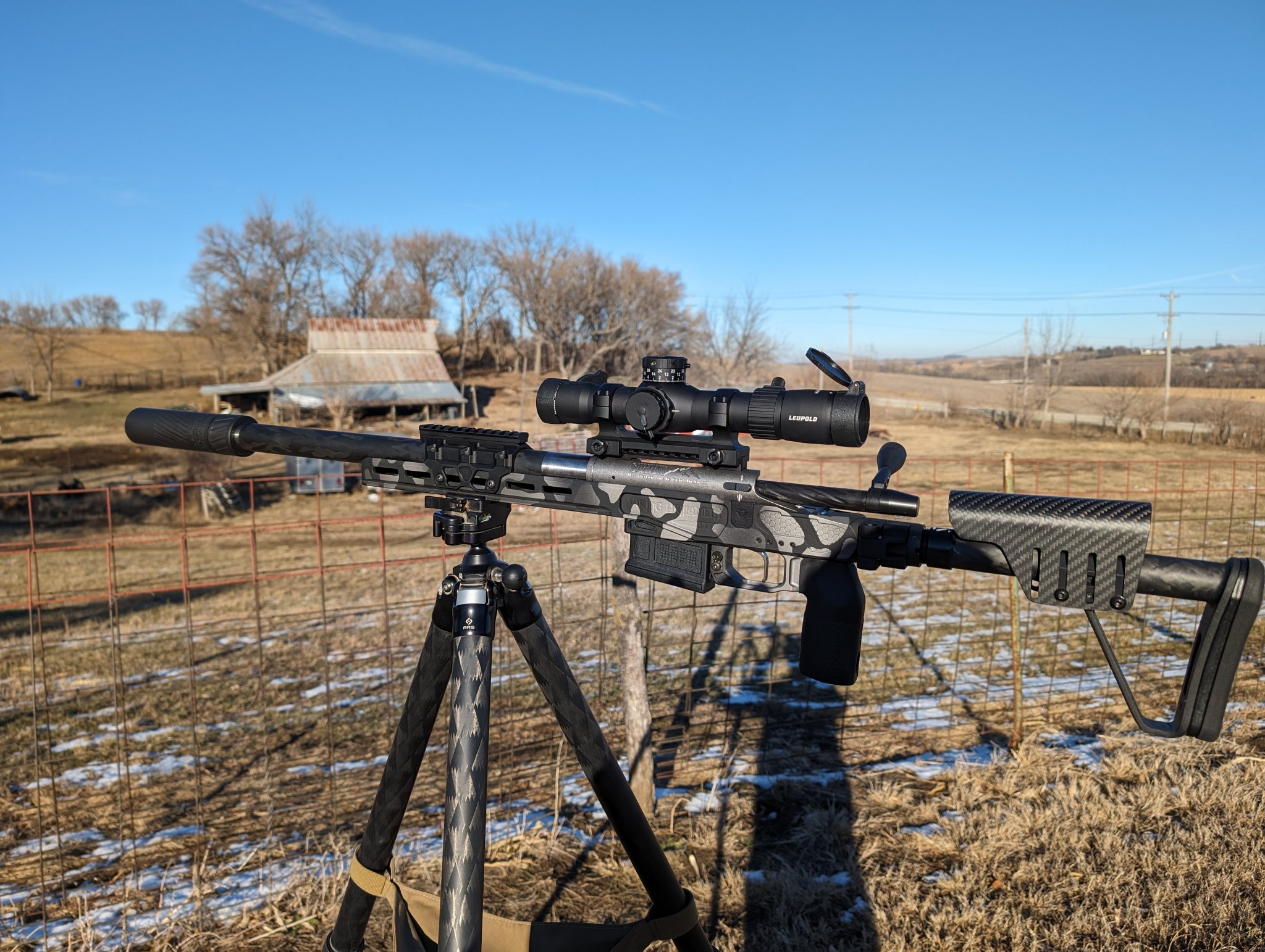

To help revive an old thread here- I've been running a skltn Ti for the past couple months on a coyote rifle and I've been very happy with it. Pure is currently running a sale, so I went ahead and ordered another action for next year's deer rifle. They're some of the lightest actions you can get, so I'm hoping it pairs nicely with a XLR element MG and a carbon barrel.
I had pure spin up a carbon 18" barrel in 22gt and that thing can shoot. I'm very happy with it.
The only thing I'd like to change is the bolt knob because I'm used to the dumbbell style. Otherwise, I'm a big fan. The thing is dumb light for what it is.

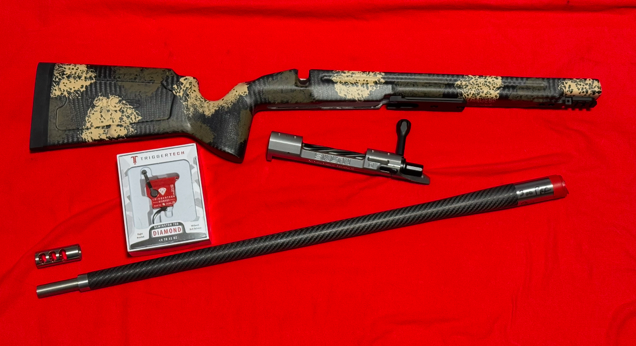

Did you get your night stalker stock for the pure precision skltn action or did you get it in Remington 700? I’m a little confused why it matters if the skltn action has the Remington 700 footprint. New to this stuff, trying to figure it all out.
My gunsmith threaded the barrel but I don’t see why they wouldn’t be standard R700 threads.
I got the mini chassis and just ordered it for an R700 short action. Some actions have different features that may keep them from fitting a standard R700 inlet even tho action screw spacing is the same that’s why some are listed but it’s pretty impossible to list every aftermarket action. I asked manners before ordering since the SKLTN isn’t listed but it doesn’t have anything crazy going on so I figured it’d fit the mini chassis fine

They now have the PP skltn action listed. If you were me and planning on going with that action would you order the stock in rem 700 still or go with the skltn inlet? Maybe it doesn’t matter, I’m not sure? I’d like to keep it easy to re sell if that scenario ever arose.

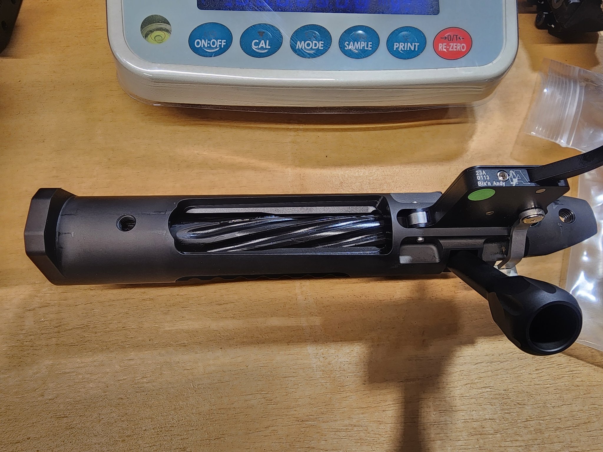

did manners say anything to you about the SKLTN action not being a great fit for the mini chassis because the bottom of the action has those cuts machined out to save on weight?
Wether you order for an r700 or SKLTN you’ll likely get the exact same stock regardless
I’m sure if manners was concerned about an action not fitting properly in their at the time current chassis/inlets then they wouldn’t offer it or they’d advise you not to run that combination. Instead of asking random Internet people about manners builds you should probably call and ask them some questions

I really like the action and was set on it until I found out I couldn’t run it “or shouldn’t run it” in a mini chassis. I really want to go with the mini action so I can use the same stock and swap out different barreled actions depending on the season and what I’m hunting and or shooting. The coup de grace has my attention now but it seems like it has potential to need some tinkering. This being my first custom rifle I don’t think I have the knowledge to be trouble shooting issues whether it be the SKLTN or the coup de grace. Anyways, I appreciate your input.

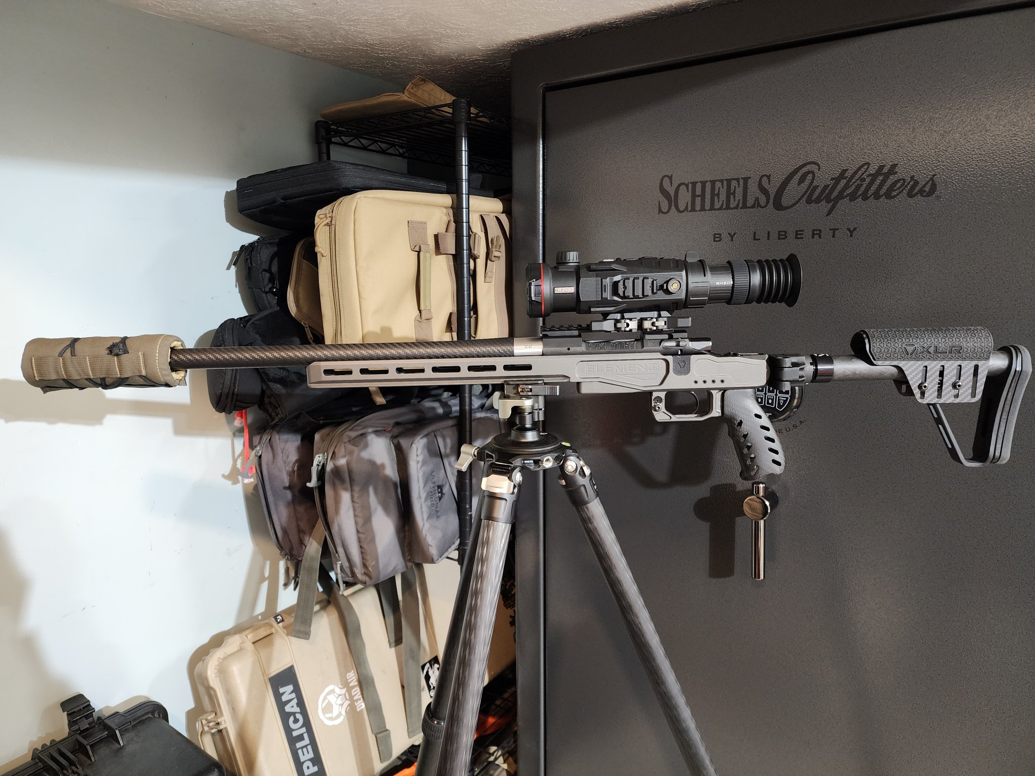

I don't understand why you wouldn't be able to run it in a mini chassis. It's a standard R700 footprint. I currently have kine sitting in a R700 XLR element MG and the thing shoots lights out. Stocks/chassis that are universally cut for a R700 will also hold resale value better. Go compare how much a stock that's been bedded for a specific action compares to a stock.

That’s exactly why I want to go mini chassis in the r700 footprint. If I absolutely had to I could re sell it without completely losing my ass. Especially being a manners night stalker. I was told by manners that the weight reducing cuts on the bottom of the bolt don’t allow a great mount up point in the mini chassis. Jnull is running that exact setup and hasn’t had a single issue so obviously it can be done. I’m very very tempted to do it anyways. I just really don’t want issues that I’m not capable of trouble shooting either.

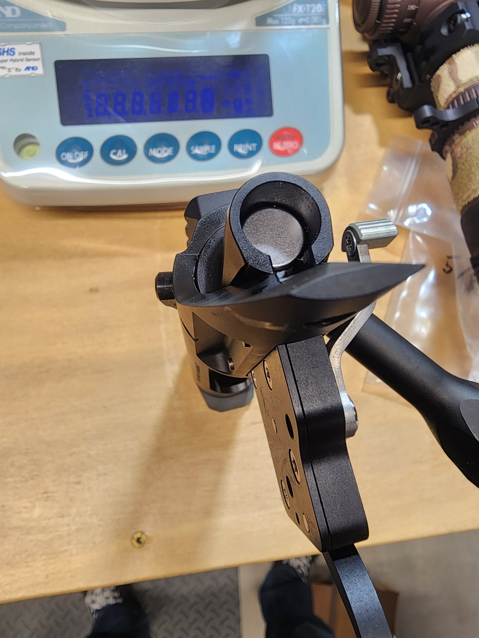

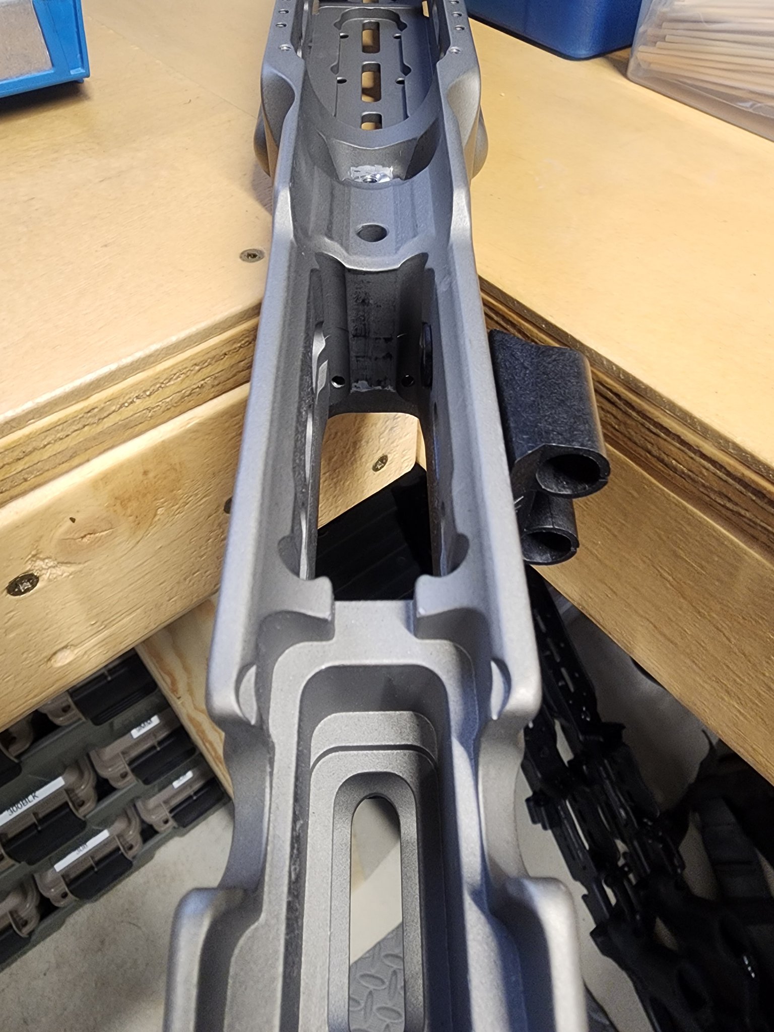

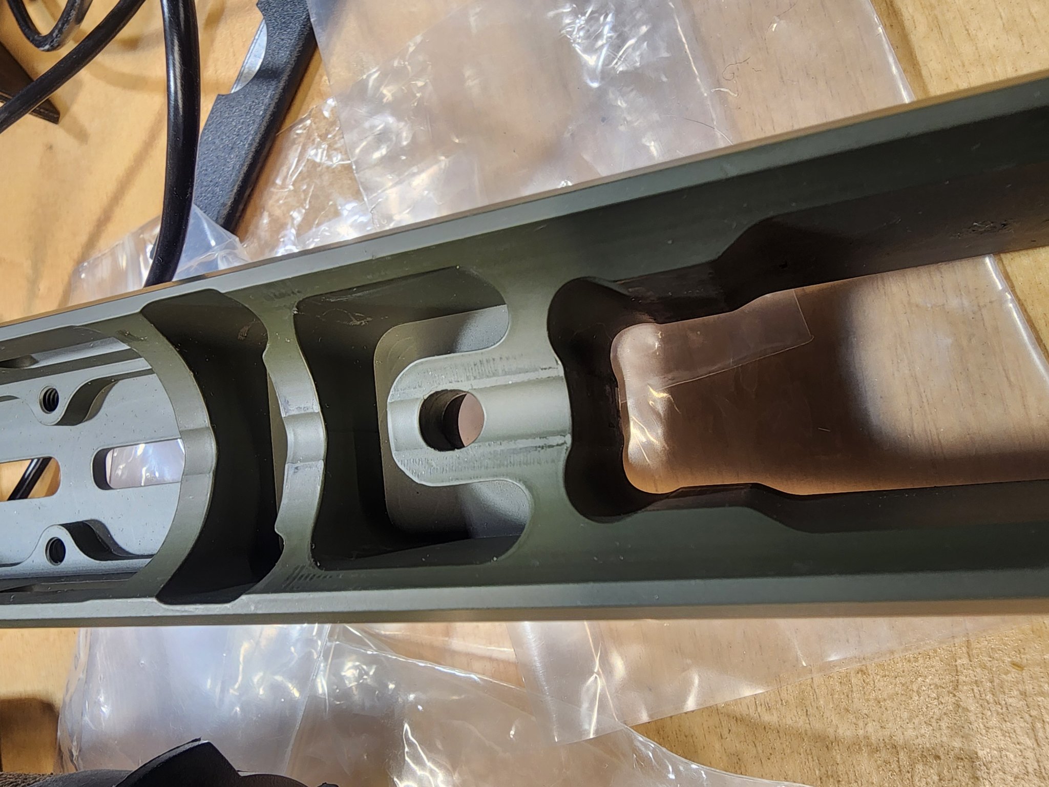

While I don't have a MCS on hand to get pics, I do know that most chassis will have some kind of v-block setup for holding the action in place. The action screws will then pull the action down into the v-block to secure it. I've attached a profile picture of the bottom of the skltn Ti action. You can see the same round profile is maintained along the entire length of the action. The only lightening cuts that are on the bottom are the cuts around the trigger pins. This portion is irrelevant to mounting because nothing is designed to contact that region of the action. I've also attached pics of a XLR element MG and a matrix pro for v-block reference. Both of my skltn Ti's live in XLR element MG's at the moment.
Very helpful, thank you.
