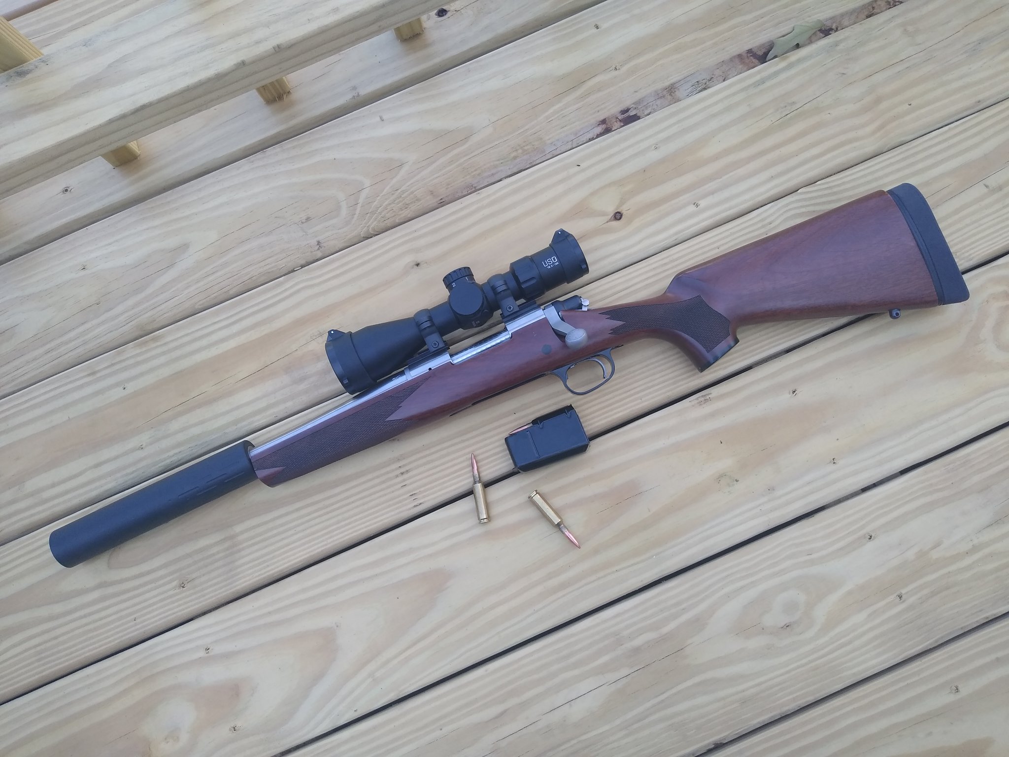

i have a 6xc boltaction with a 8" barrel, my plan was to use my Gemtech tracker with it, but... i chickened out and made the first shots with a YHM Resonator which i feel is build like a brickhouse and most likely to survive anything i throw at it.
so yes it did great, i consider it still hearing safe but.... the suppressor almost weights as much as the whole damn rifle, so im looking at the Gemtech again.

i havent shoot it without suppressor and am not planning to, but the suppressor contains the fireball completely and gets really hot after just 1 shot ( which is why i am worried that the Aluminum Gemtech might struggle
Here is the 8" barrel
I'm betting you will see some serious baffle erosion, but that's probably a non-issue if it's a low volume hunting rifle.
