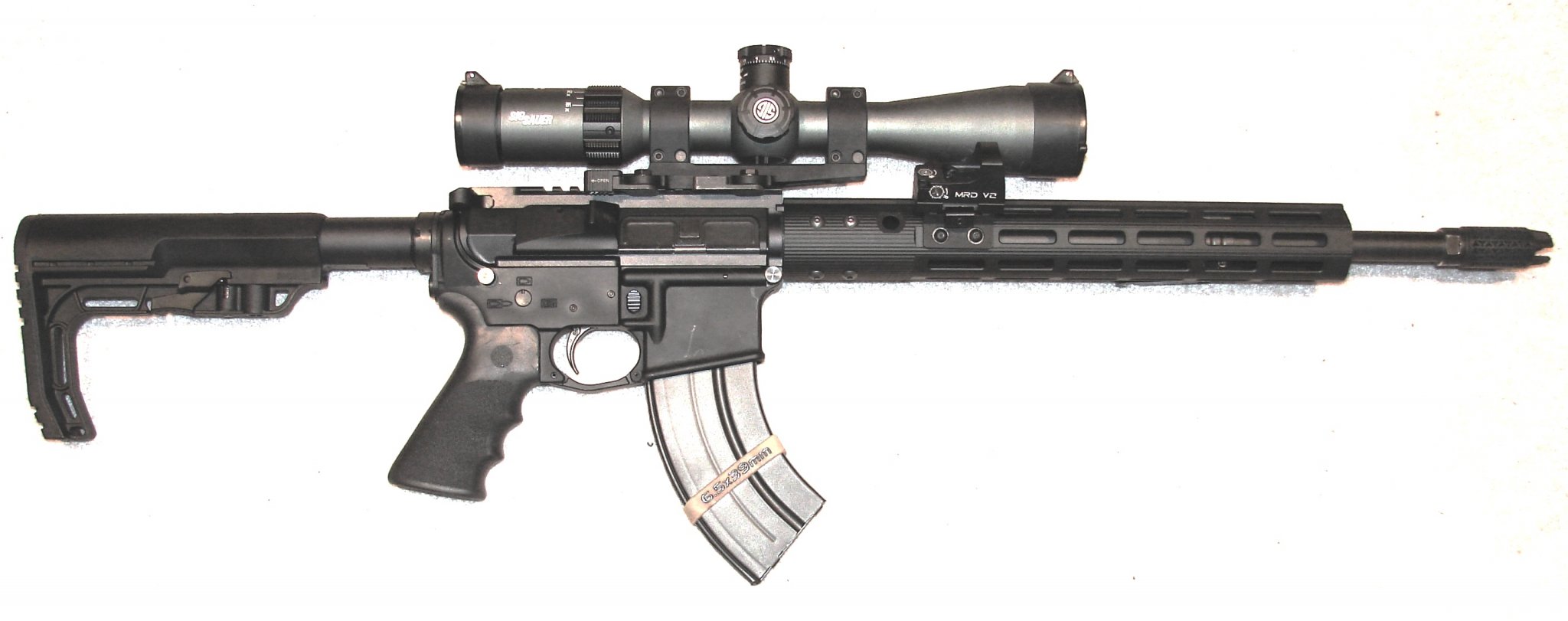

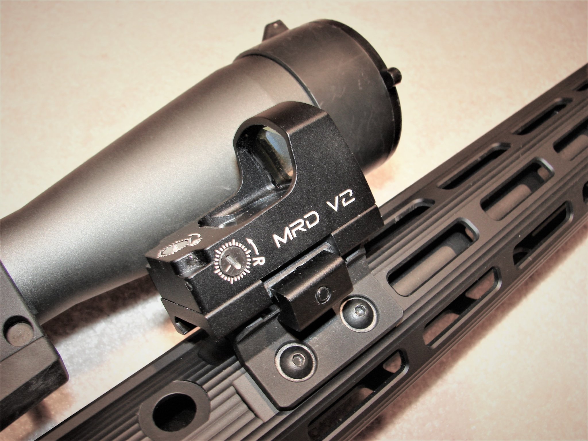

I have a 16" Criterion barrel 6.5G purposed as a long-gun that I recently installed an Atibal MRD V2 RDS for CQB utilizing a Magpul offset 1:00 mount.
I zeroed the Atibal at 25 meters with Wolf 100g steel case, bench-rested and canted 45-degrees, resulting in a .75" group. I then switched to Hornady Black and the POI with 3 rounds using the same zero as for the Wolf was 5.5"L and 2.5"H, also while bench-rested. I re-zeroed the Atibal with the remaining Hornady Black (about $6 later) and had a .5" group at 25 meters. I ran out of Wolf steel case to re-check POI with the zero set for the Hornady Black.
Is it possible for POI to shift 5.5"L and 2.5"H between the 2 different rounds, only at 25 meters?! My concern is if the Atibal is losing zero .
