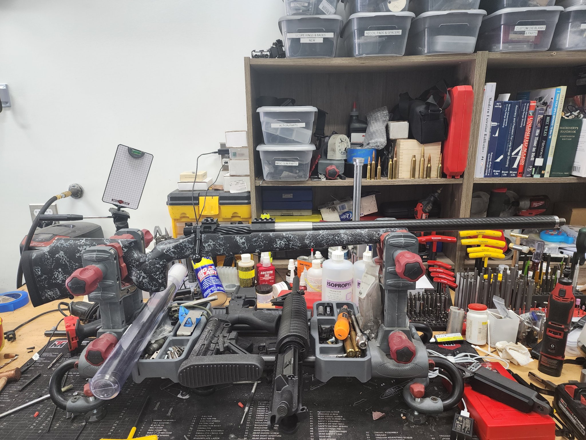

Took the plunge and ordered one of PVAs new osprey carbon barrels in 6.5mm for a lightweight 6.5 PRC. Josh was very helpful and I wound up ordering a 23 inch barrel in the competition contour as that's the only one they are currently doing...it tapers to .99 at 26 inches and should be right at 3lbs or a little under at 23 inches finished. Want the option of running a suppressor and my 300 Omega only adds 5.5 inches to the length. Good thing is the barrel can be cut down farther which was a main selling point for me and my gunsmith...the blanks come in 26 but can be cut down to 18 inches. The action is a Kelbly Nanook and the stock a McMillan carbon. BDL floorplate and Trigger Tech Diamond trigger...more to come...hopefully the barrel comes next week as they have them in stock and say a 4 day turnaround on blanks.
My osprey 22 cal blank was chambered in 22cr, shoots excellent at 18". I'm not a fan of chopping barrels that far short of original blank length due to runout concerns, but this one turned out great. Interested in trying a prefit from Josh.
Reactions: 30Hart
Received the blank in a timely manner. Looks good and the 23 inch blank weighs 3lbs 3oz in 6.5mm already threaded on the muzzle. should be close to 3lbs or 3lbs 1oz after skimming the back end, chambering and threading. I have everything for the build so just waiting on the smith now.
Barrel on the action, be done soon
