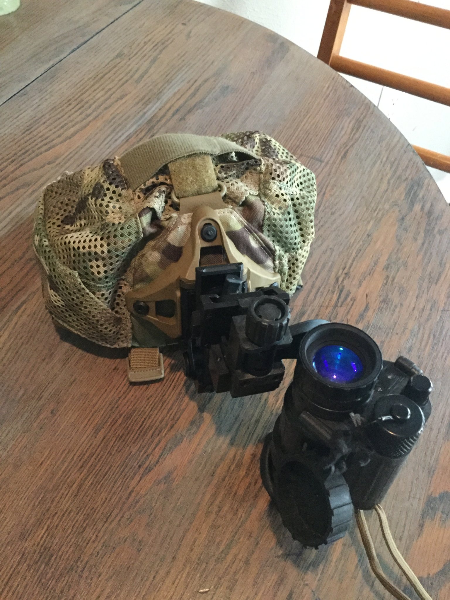

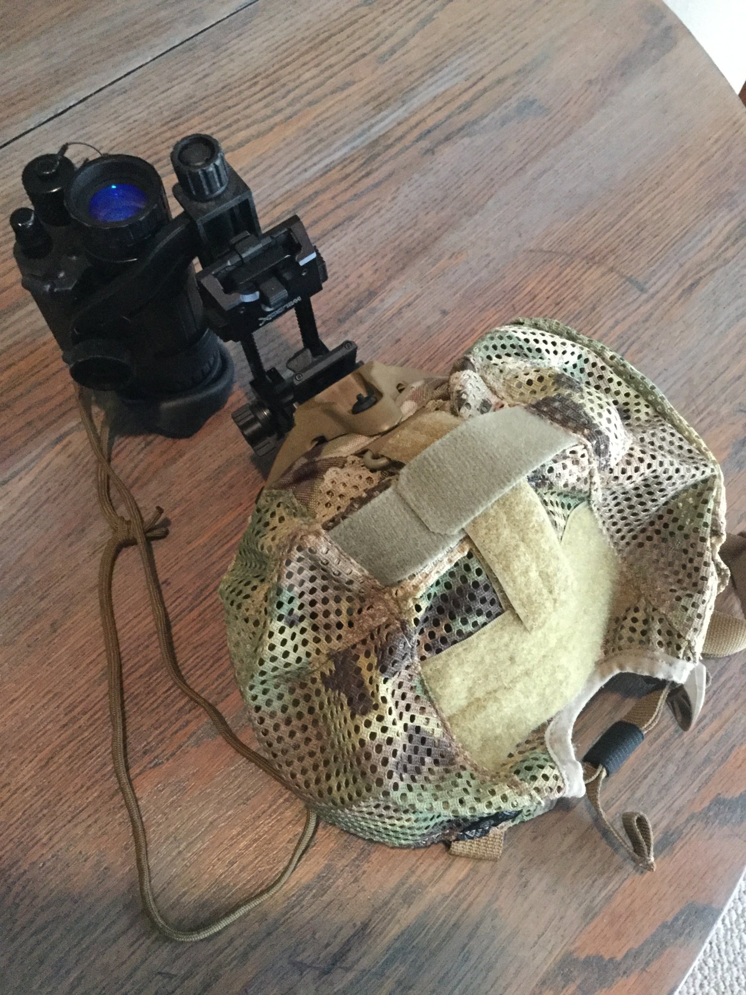

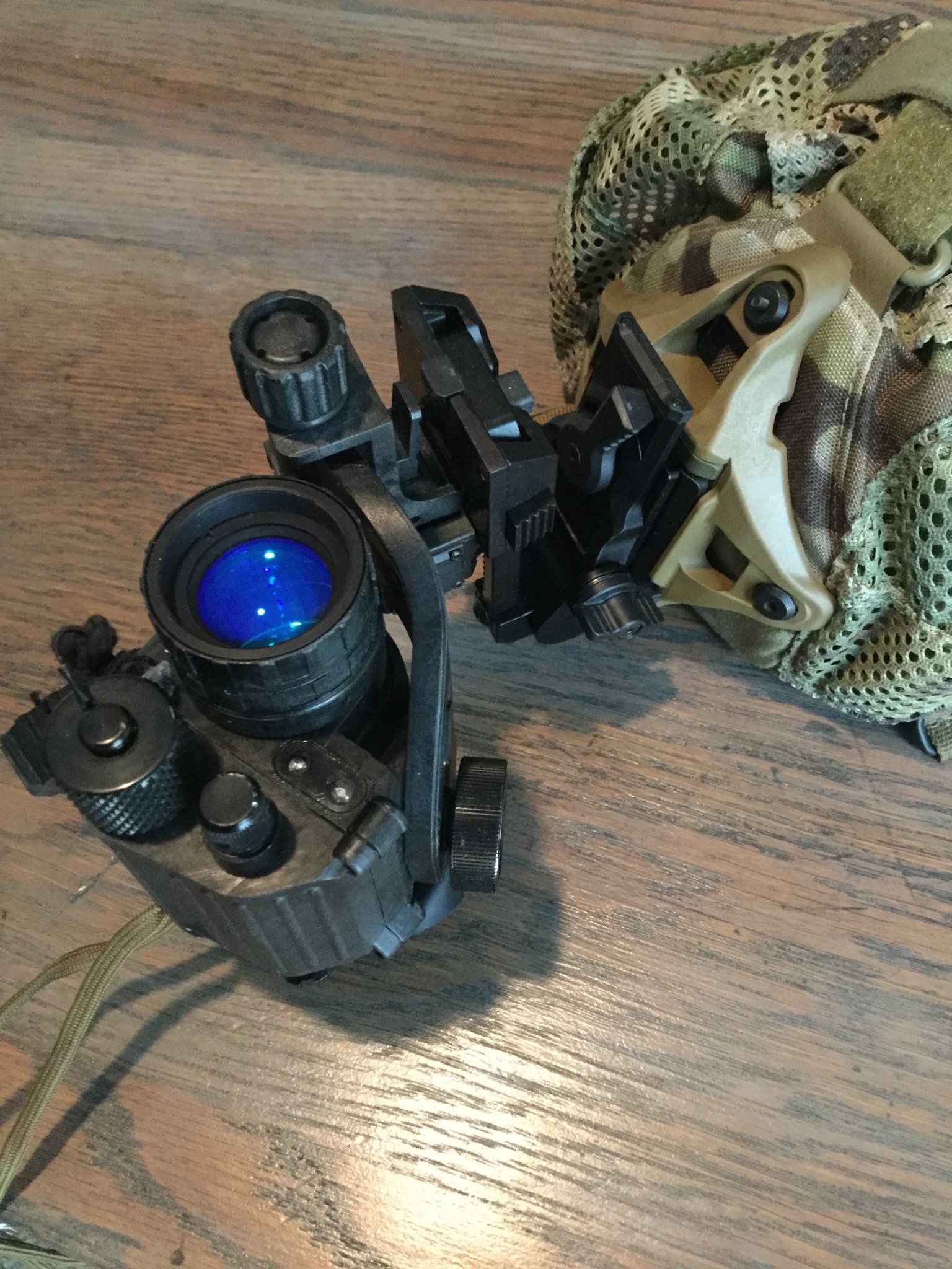

I use a Wilcox shroud and a Rhino II mount with a counterweight in the back. Very comfortable and plenty of adjustment. If you’re on a tighter budget I would recommend them. If I had more to spend I would go with the Wilcox
I used this as a primary for a long time and now as a backup/spare. Still the most comfortable setup I've used.
I used a Wilcox 3 hole shroud and a Wilcox G11 with my nightcap. The EOD counterweight was pretty much a must have. I sold the nightcap because the chin strap was severely off center with no way to adjust. Other than that it was comfortable.
Love mine with Wilcox shroud and G11 mount with GI bayonet works well, the Velcro adjustments take a bit to get right but you can make it so that you don’t have to have a counterweight which keeps it low profile and light to pack as an EDC set up or have in a response bag for LE
