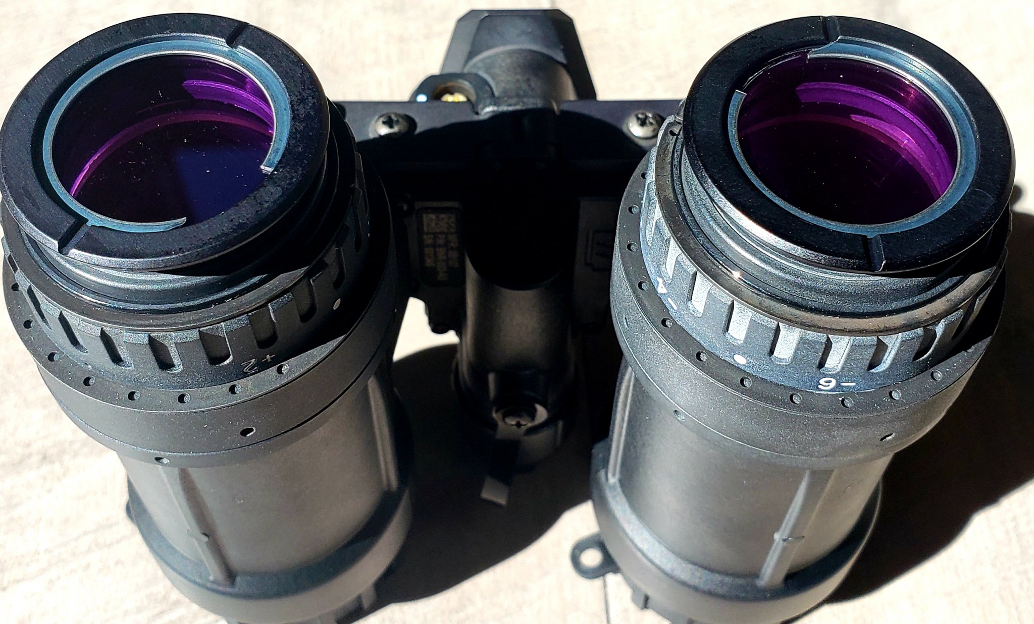

    I have also replaced my plastic amber Wilcox with a purple-ish one that is closer to what you want. Not listed on their industry-oriented website, but available from https://isquarednightvision.com/ (which has a certificate issue today but is safe) or I can get you Pete Lesbo's contact information directly if they don't respond through the website shortly.
    Here's what mine looks like. It even screws it securely. There's a Wilcox amber filter in the woods somewhere because they just pop on... and off.

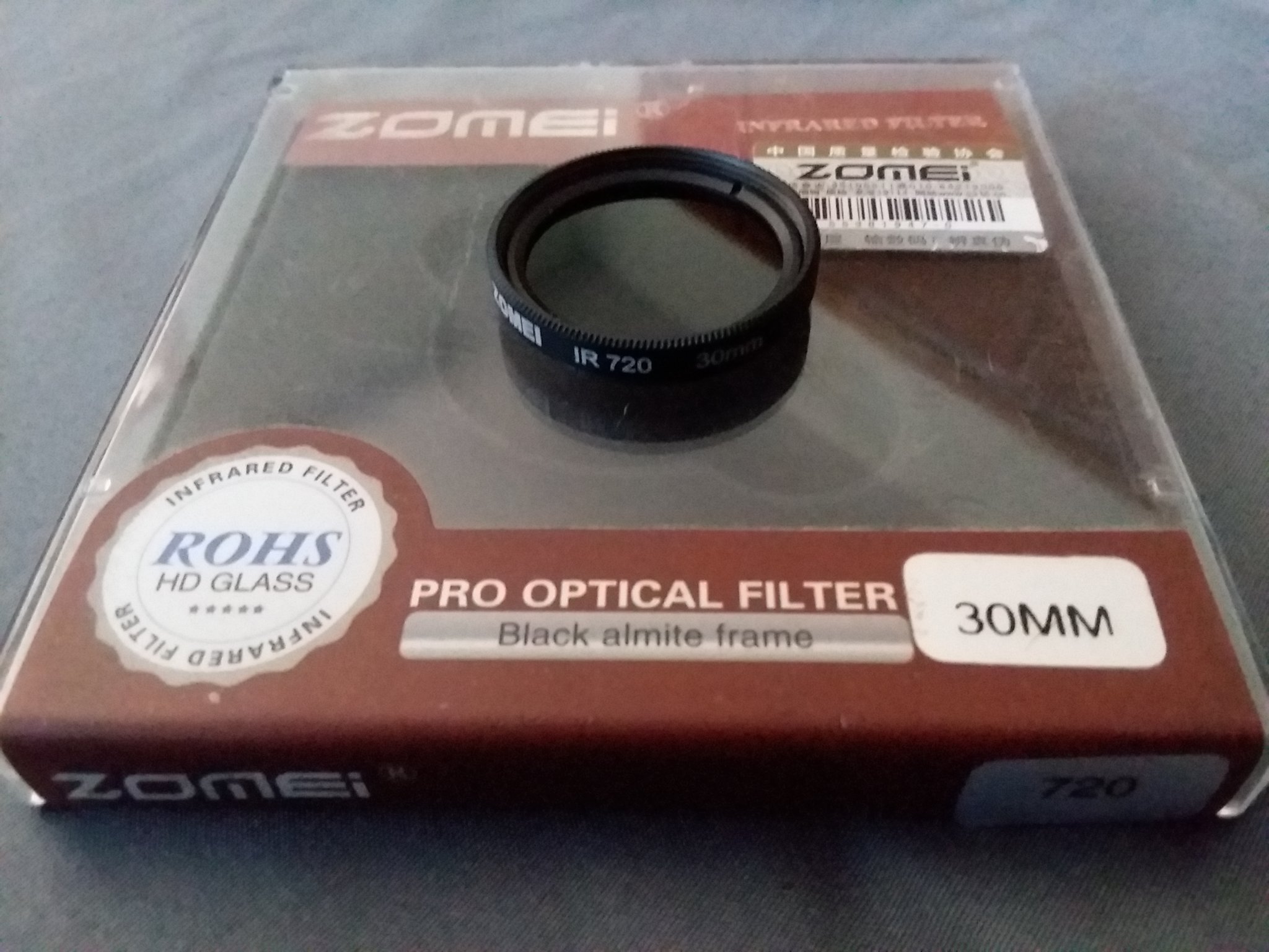

    I always grab them off the 720's ebay and order them, and I have given to friends who don't have . I was told about them several years back and I always use them as a sacrificial lens also .
    I just never take the 720 off the Obj. . There is just nothing better than a 720nm to cool off a full moon in a grass field or take the edge off when you got some industrial or rural ambient in the outskirts that fucking with your scanning .
    I run yellow tints on the Occular that I got off Arron F. years back . he had a good idea and printed a sweet plastic housing back then to hold color lens's and screw in to ocular .
    Yup, I actually got the tip about the 720s from Aaron who attributed the tip to you.
    And I got one of Aaron's filters. In hindsight, I should've got 50 of them ! :D
    720 to the 760nm cut-off range ? . I would not know, Unless I was just doing a close compare sidexside @ night .
    the fine tech./photo geek stuff not my forte . but 720 probably the sweet spot ( my guess ) .
    And another 'just a guess ?' You probably see ok @ night you need to cut-off (light color frequencies) anywhere below 800nm .
    with all the digital computer editing for Pic's. now. the fine art of Filters on film probably just a lost art . But someone with photo. formal training is the person to talk to . But normally you using these ( nm filters) for 'daylight' photo. and basically that what you doing is cutting of frequency ranges of color/light .
    So, does the Isquared' purplish filter create a similar effect when attached on the ocular side to create a white phosphorish look? Do you have any pictures filtered and unfiltered you can share?

    It looks like the LIF filter is a green blocking notch filter that approximately blocks wavelengths from 515-560nm. This is based on an old ARFCOM post. So I would guess that there is a small chance that there are commercial manufacturers/camera filters that are available. Problem is finding them.
    A couple of people posted in this thread about the differences between a Zomei IR760 and the IR720 filters. I'm sure if the IR filters do this but I also understand some filters block out the red dots making a red dot scope useless.
