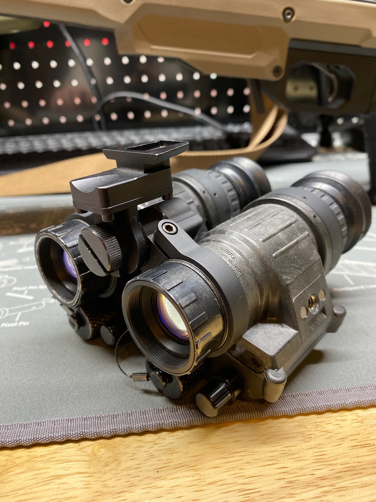

I have a buddy wanting to trade me a PVS14 w no spec sheet. He is pretty noobish with NV as well and got this off a friend of a friend. Looks very nice with great image(no blems) green phosphorus but I know absolutley nothing about night vision or what to look for in them. It will just be for shtf situations and an occasional night shoot nothing serious so not really wanting to spend 3k on a setup
All in all id be into it for about 1600 bucks(1k cash and 600 trade)
Also comes with skullcrusher and helmet mount
Is there anything I should look for myself when checking it out? Is it worth it? He said he believes its an omni V but he isn't even sure on that
It would just be for one of the ones pictured not both

So I did as you said. In pitch black it wasn't hardly fuzzy at all unless I turned the brightness all the way up then it was decently fuzzy
With IR I could do the letter test with no issues at all
Street lights had bloom to them but not really sure what a lot compared to a little is since I've never looked through nv before but I would say little to medium as it didn't take up the whole view or anything like that
Also no hum what so ever that I could hear
