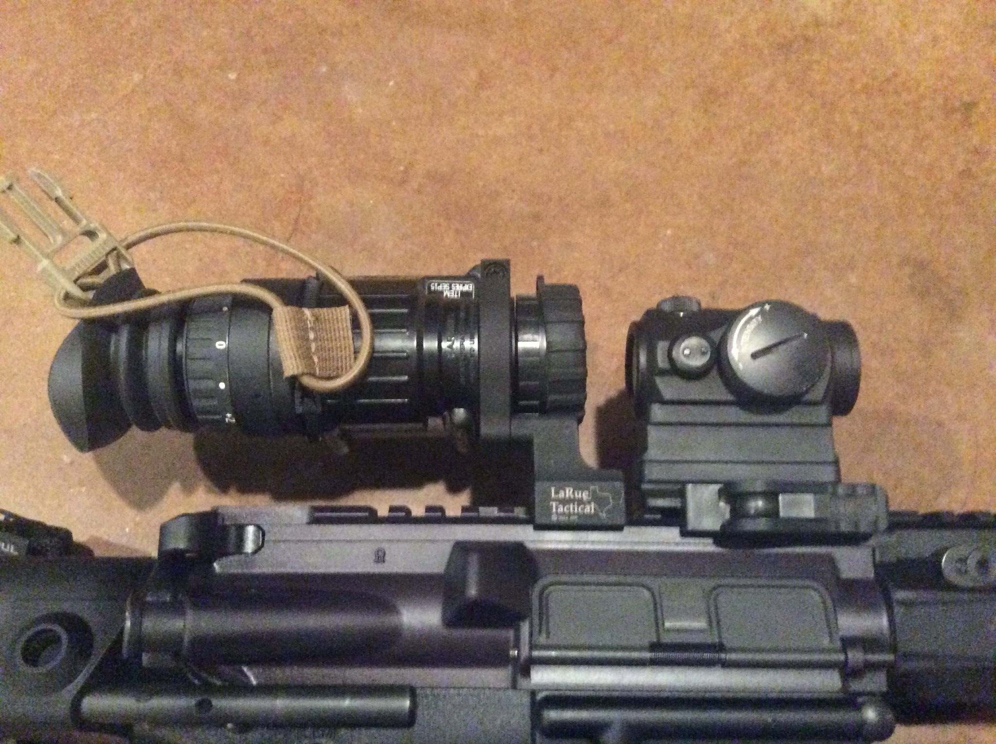

I have a Larue mount for a 14, but it is designed to go behind an aimpoint. That is far from good too, but back in the day, people didn't know what they didn't know.

If you wanna put it in the back and go to a red dot, I have a Larue QD mount for the PVS 14 and a QD riser base for a red dot. The go together, the mount is small and stays on the PVS 14 and fits a small piece of rail in the back. EoTech or an MRO w/co-witness base (the middle one) or any sight with the dot at standard co-witness height will work. With an EoTech, it's about the closest you can get to a 1x NV sight. Just make sure the red dot has a NV setting because even 1 is too bright.
