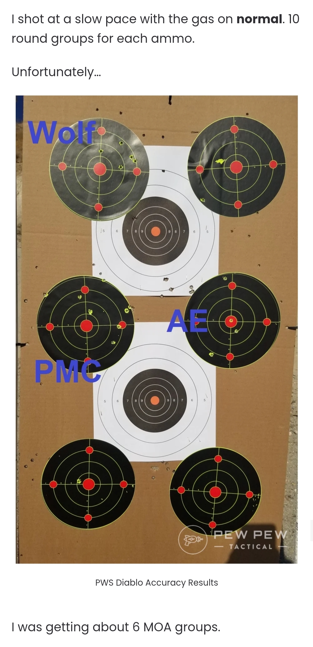

I've been having inconsistent accuracy with my PWS diablo. It range from 5" to 7" spread at 100 yards.
Ammo I used Golden Tiger, Barnaul and Belom.
Sometimes it would shoot to consecutive rounds side by side then on the third and fourth it would fly to extreme right or left it seems I can't to get it to group tighter.

So it's inherent to my pws Diablo to have such big MOA.
I was watching the YouTube and those guys are shooting 1.5 to 2 MOA with same ammo as I have.

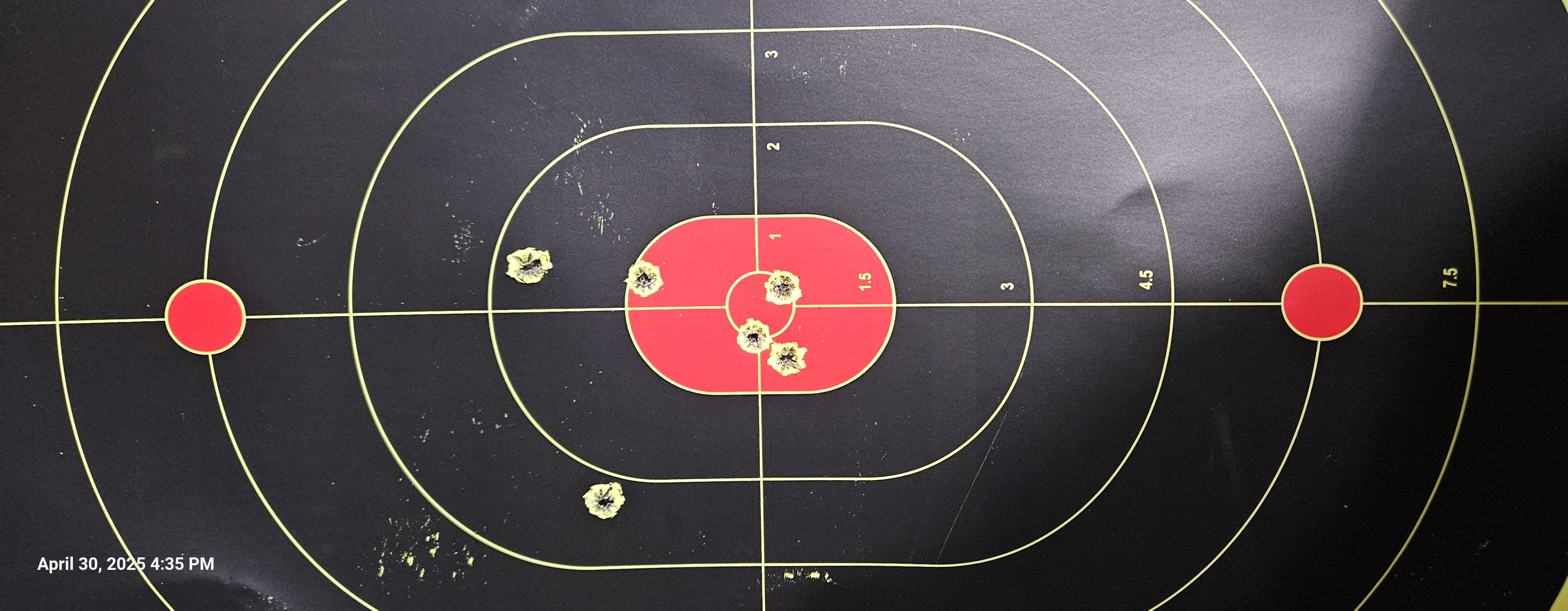

As it turn out when I swap out my PWS Diablo's sandman L suppressor with YHM resonator my grouping has become 2 MOA instead of 6 MOA consistently. I do not understand why that was the case.
The Sandman muzzle brake torque to factory spec but I was shooting all over the place.
I thought all suppressor will improve the accuracy of any rifle. I guess its not.
Reactions: Ernest 5.56
I found out its not the suppressor but rather the muzzle brake. When I install the flash hider (with suppressor thread) on my Sandman L it turns out be accurate. Made 2" grouping at 100 yards. I fired 4 shots with my red dot with magnifier. The 5th outlying shot was done with my laser aiming module. Don't know why muzzle brake would cause the inaccuracy. Ammo used was the golden tiger on a PWS Diablo 7.5" barrel with suppressor.
