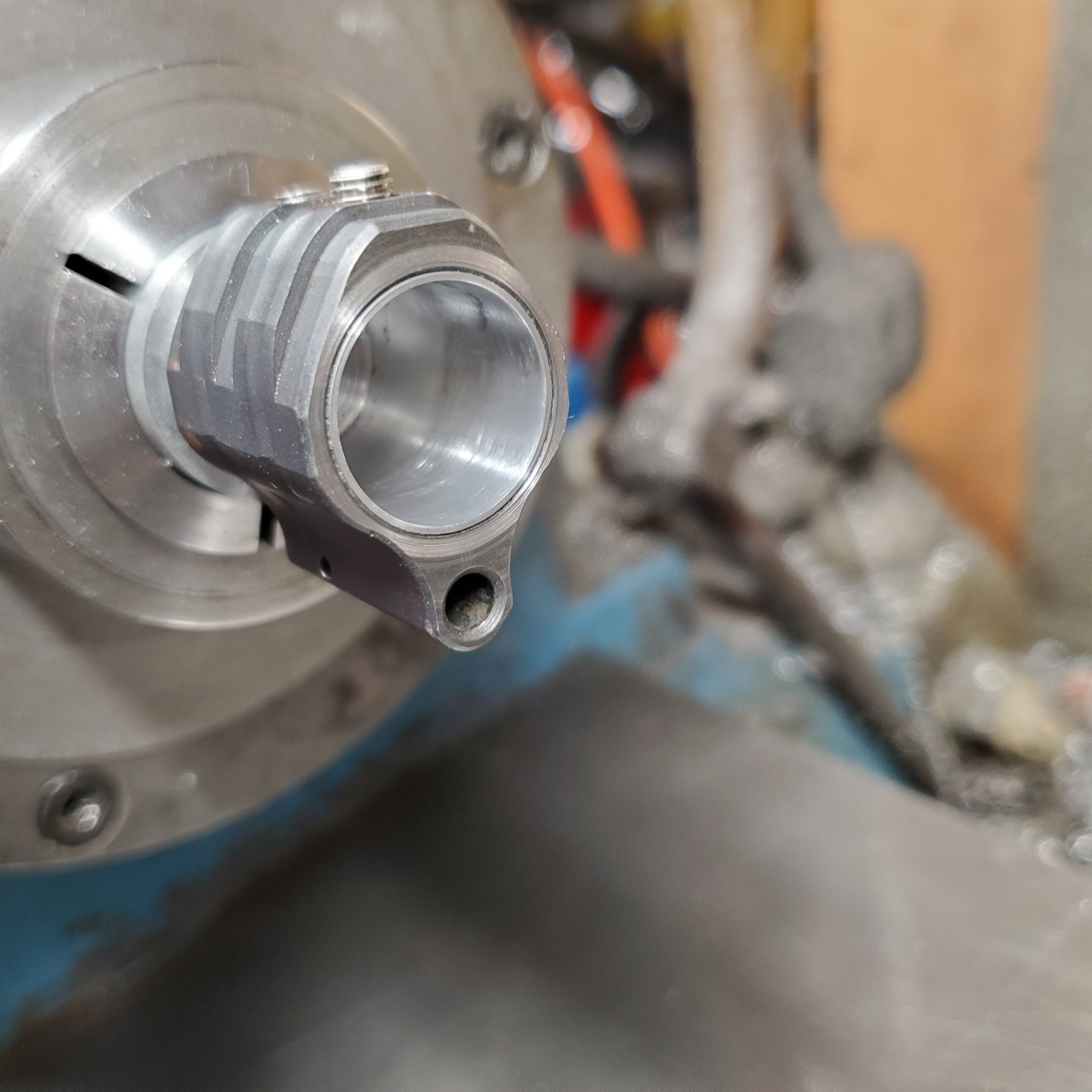

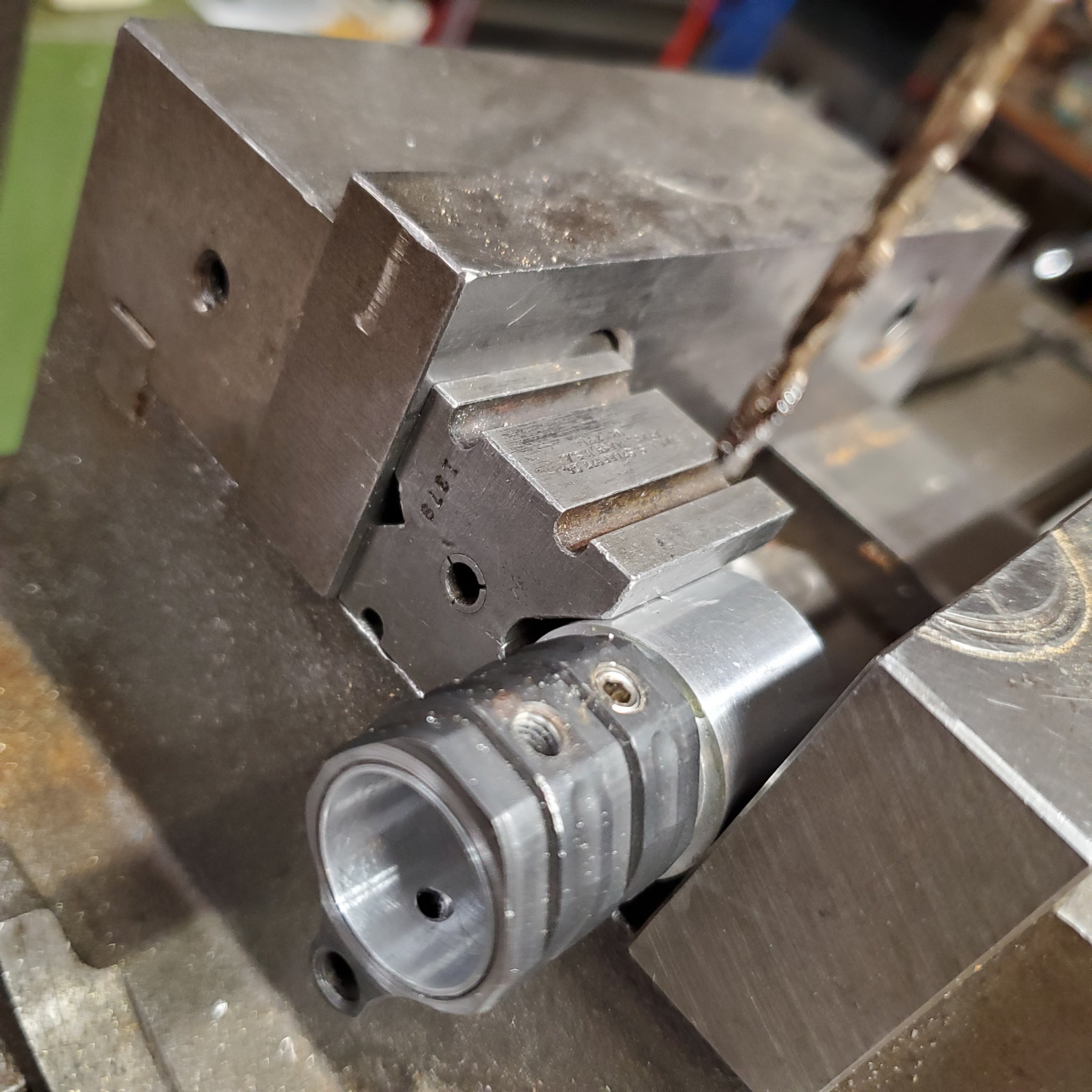

    Any machinist/ gunsmith can replicate anything in metal. Turn a gas journal to any diameter ya want and bush or bore out any gas block ya want. Here is a .708" gas block dia the only one like it in the world, with a matching gas journal, cause that's where the Rem 700 used barrel cleaned up from fluting to make an ar 15 barrel, in obsolete 30RAR caliber, which works great and 1/2 " shooter.
    A barrel can be profiled to any shape that's safe and usable.
    Today's CNC it is just a simple program change.
    Easy to do... for any machinist.
