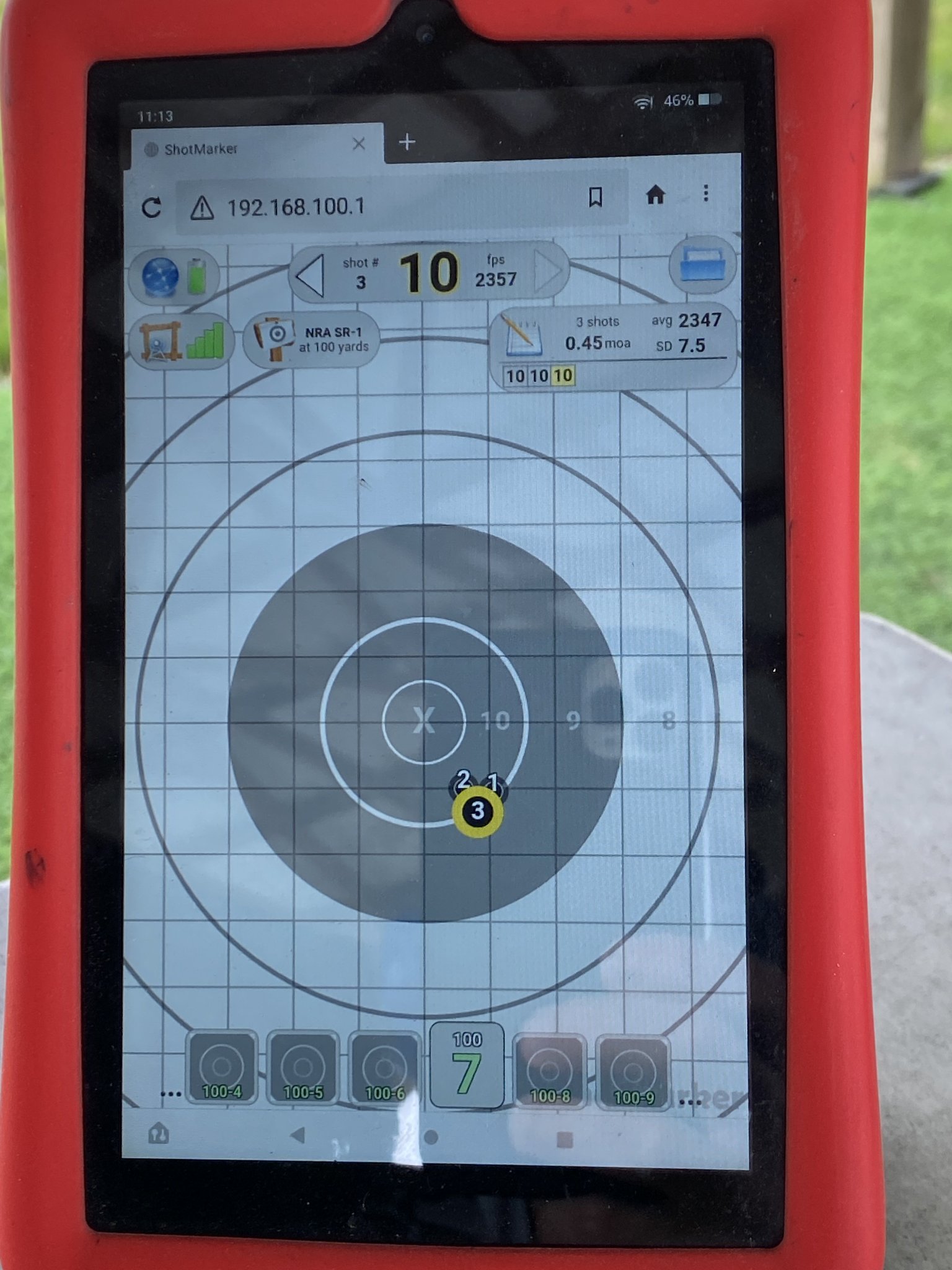

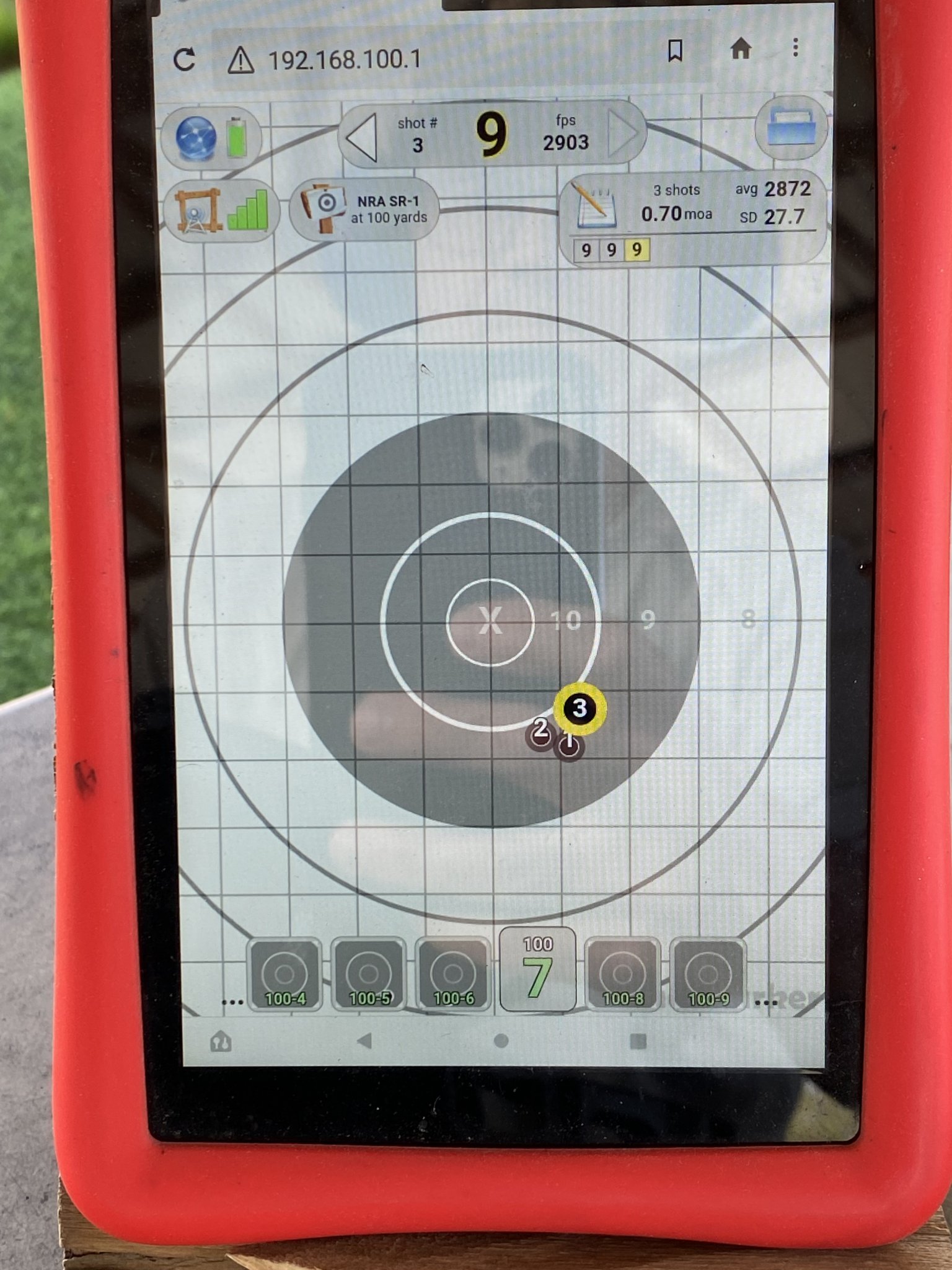

I picked up a slightly used 16" Proof Carbon barrel and 15 inch handguard for my 300 Blk Mini Fix pistol recently off the SH marketplace. I could not find much information on the net about this combo and accuracy so thought I would provide some feedback. As only "20 rounds fired through barrel" per the ad, I thought it might be a lemon. In fact, it is probably the easiest barrel I have ever had regarding load development!
As you will see, these are three round groups, which are a bit suspect in isolation. When all the three round groups shoot well, a pattern of performance emerges despite the three round per charge weight limitation.
77 TMK, 77 SMK, and 53 Vmax loads were shot. N140 was used for the 77gr weight loads. N133 was used for the 53gr Vmax.
Starting with the 77 SMK at 100 yards:
The 77 TMK at 100 yards:
The 53 Vmax at 100 yards, note how the shots for 77 SMK/77 TMK/53 Vmax are essentially within 1/2 minute of the same point of impact for the same point of aim:

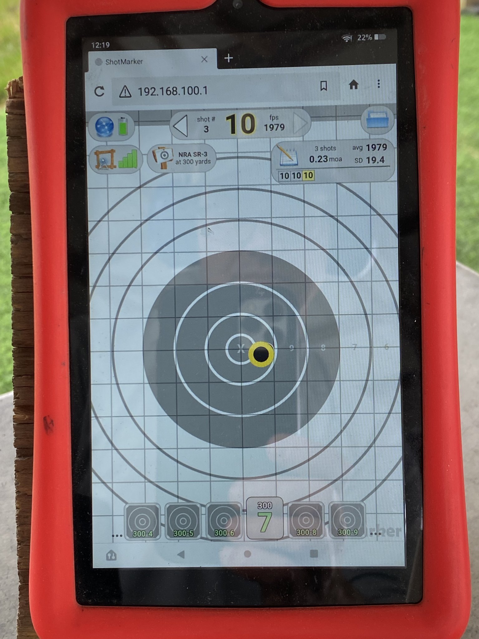

The 77 TMK at 300 yards:

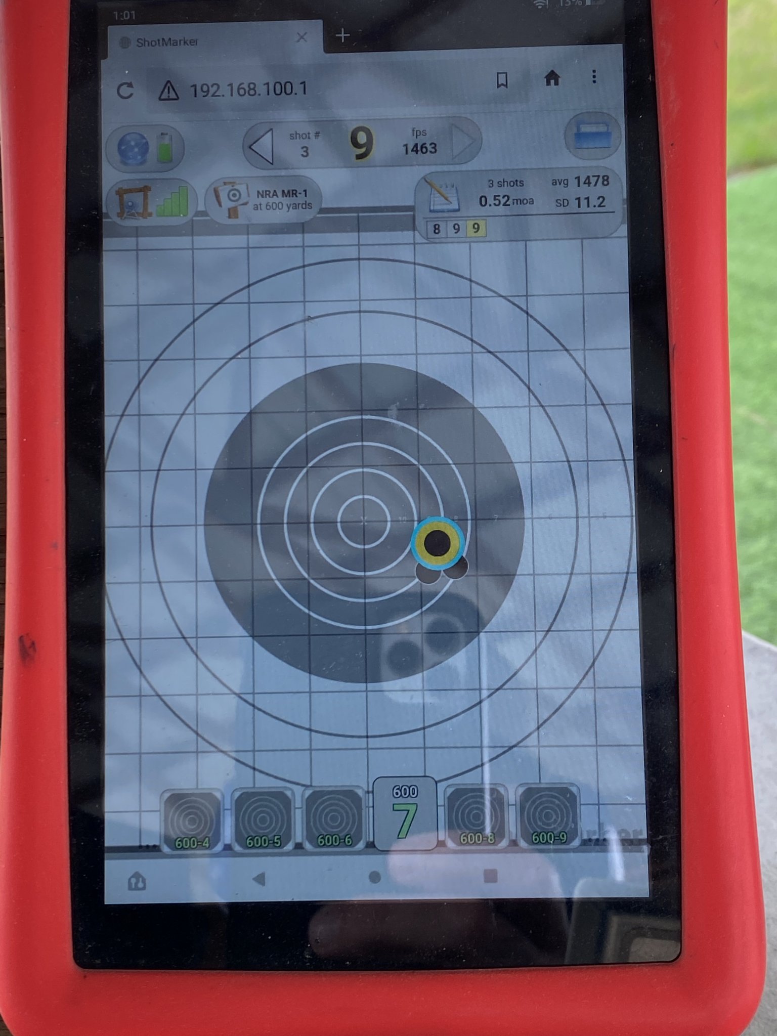

The 77 TMK at 600 yards:

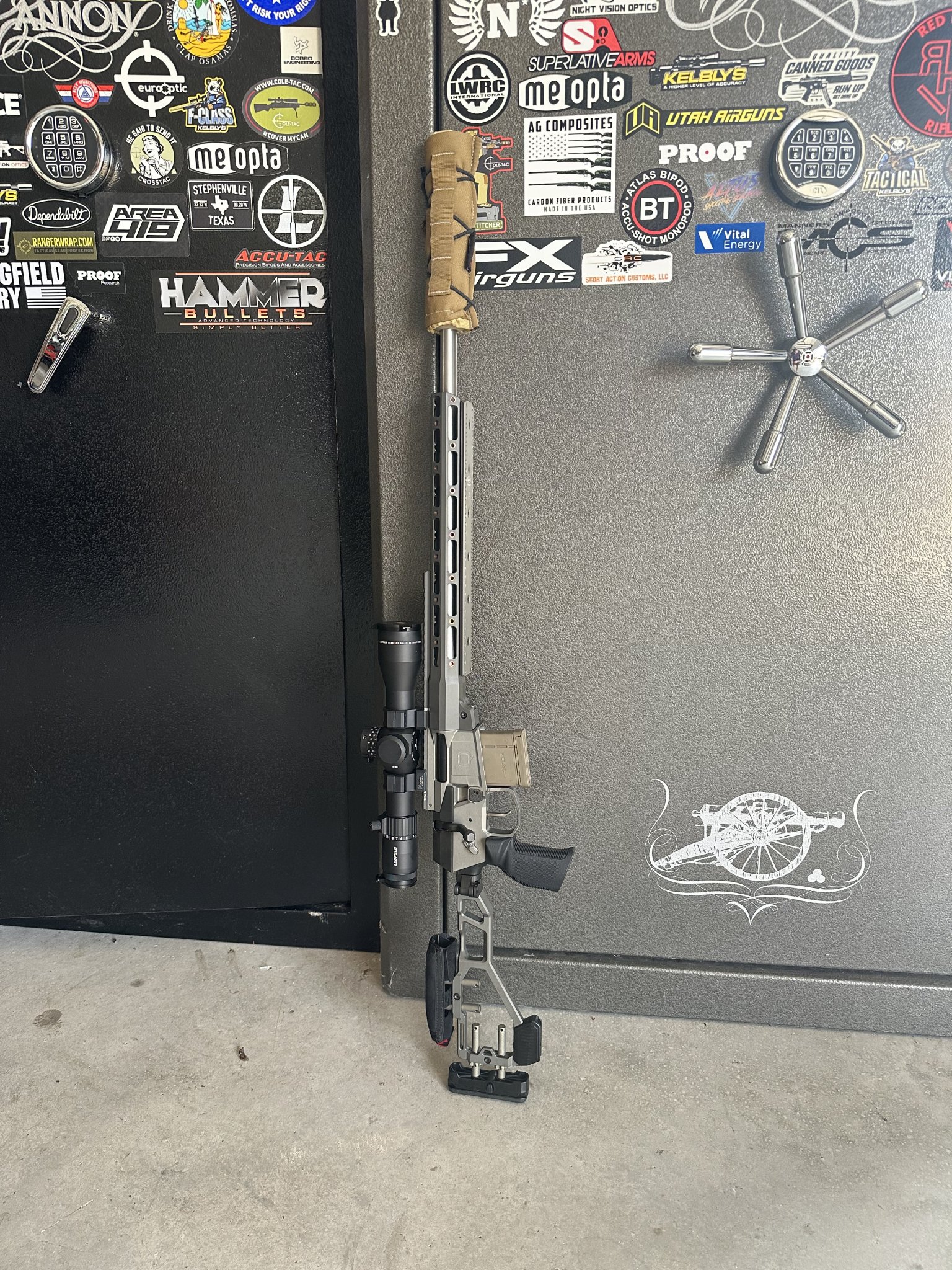

As cool as a Fix is, a custom is the way to go IMO. I found a custom in a HNT26 much more enjoyable to shoot than my Fix, it weighed the same with a proof CF, it could be swapped between magnum, standard, and 223 BF cartridges, and no playing games trying to get acc’s like a butt pad that didn’t suck or a bolt knob. Running AICS pattern mags as opposed to AR pattern has its benefits too. Swapping barrels is also easier on a custom. Cost is basically a wash as well. It’s far less to do the custom when you consider you have to have two rifles to do 223 and 308 size with the Fix.
So my advice would be to get an impact or an origin, drop it in a MDT HNT26 or XLR Element, and get a couple barrels.

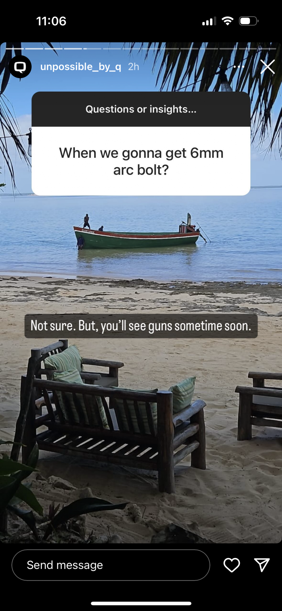

We have an update on this.
Q has made some slight improvements to the Mini Fix bolt that prevents them from mass producing 6 ARC bolts that will work with every mini fix bolt assembly on the market. The alternative was to offer complete bolt assembly. Due to that cost the 6 ARC mini fix will be complete rifles built by Q with proof research carbon 6 ARC 16.5" barrels and will be available through us.
Reactions: bachelorjack
Will we be able to purchase 556 bolts?
