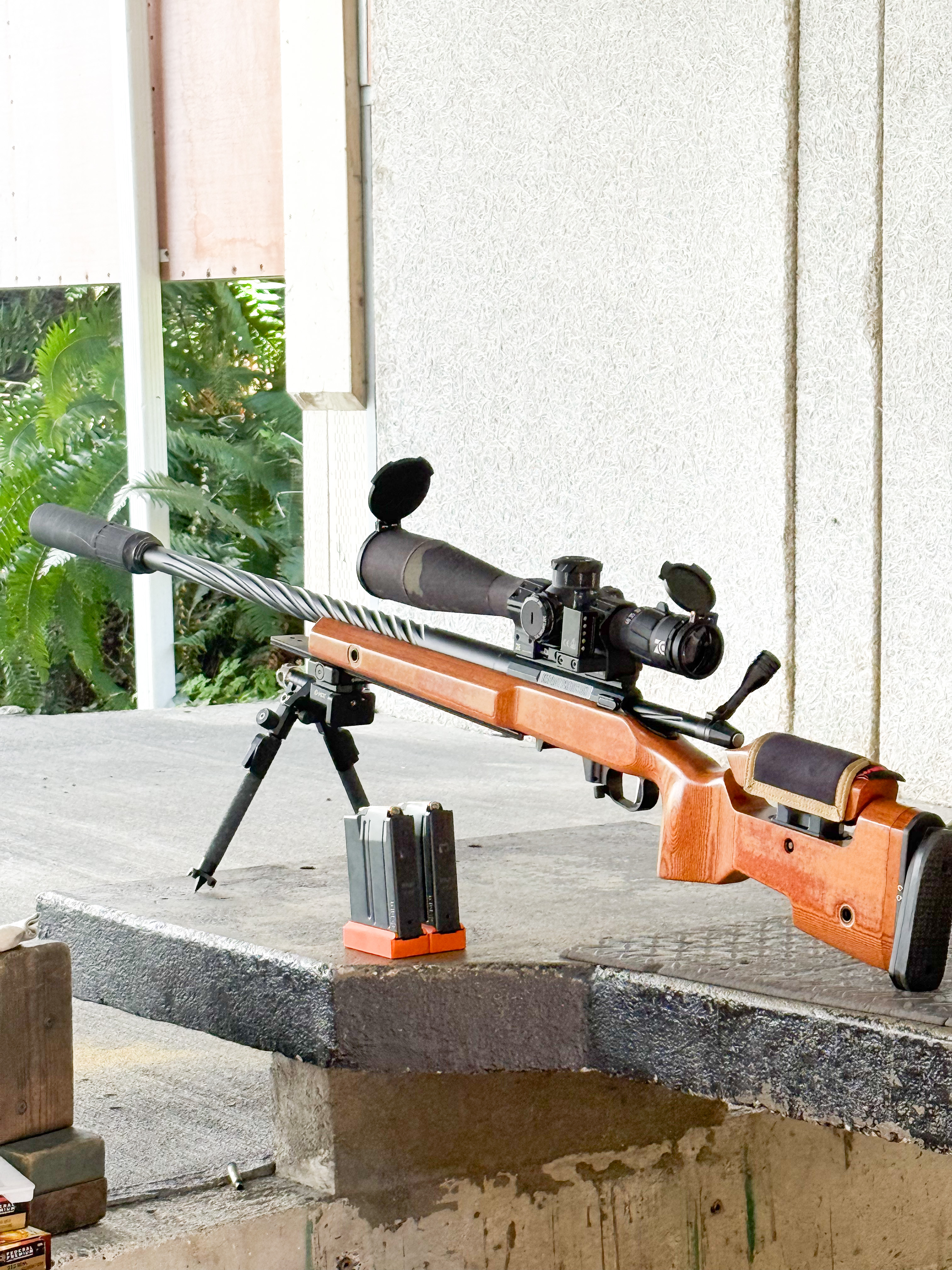

I've been swapping barrels on a TL3 from .223 to 6Dasher to 308 for years. You don't need some sort of grub screw barrel retention system. Have a smith cut some wrench flats a'la AI style in the muzzle end of your barrel and use a crescent wrench to torque the barrel while the gun is still assembled. Screw the barrel on by hand, then sit the butt on the ground muzzle up, trap the body of the rifle with your knees and apply torque on the flats with the wrench. A barrel chested healthy corn fed American will be able to apply about 40 - 50 ft/lbs of torque this way. And the specific amount of torque doesn't matter. There is no effect to accuracy or return to zero. Once the shoulder hits the action face, the barrel can't tell how much it's torqued. I used to use a torque wrench but realized after a while, when the adjustment on the bottom of the wrench slipped, it didn't matter. No need to disassemble anything. Don't fret over your action screws. The real key to making your own switch barrel gun is tooless bolt disassembly and swappable bolt faces. I had closed cell foam custom cut for a 1750 that has a spare barrel channel, inserts for additional bolt faces, and multiple magazine inserts. You can take .223 Accurate mag AICS mags, and standard AICS mags, a 223 barrel, and a 223 bolt face with you to the range and swap the barrels right there in the field.
What you will find as the real challenge is managing two zeros on one scope. Locking turrets and holdover reticles work well for this application.
I have a few origins I swap between 223, 223ai, 6.8spc, and 6 dasher on. I leave the action mounted in the chassis and leave scope mounted.
Clamp barrel in vise.
Use action wrench to break it free.
Screw action, chassis assembly off barrel.
Place vertical and hand thread new barrel on being careful with the recoil lug and pin.
Place back into barrel vise and torque.
Takes longer to round up the tools than to actually swap the barrels.
With all that said, an action with built in recoil lug would make it easier, but the tl3 wasn’t worth the extra cheddar to me
