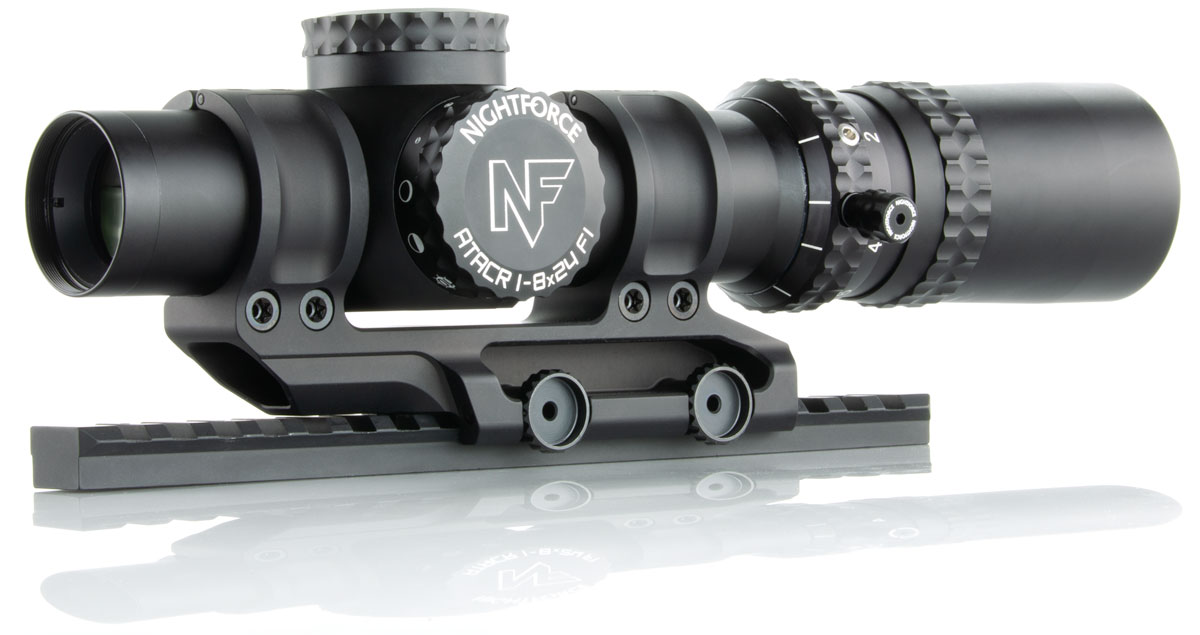

I like Scalarworks as well, but it's not a true QD imo, it uses a thumbwheel system and not a lever system. Midwest has a few lever QD ones that look decent for about $170 or so, much cheaper than the Scalarworks mount. For moving around thermal I would prefer a lever system as a bottom line.
