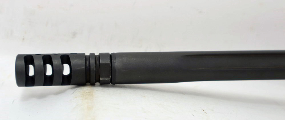

Did it have a threaded barrel?
@gc700 Here ya go!
Probably a re-stocked LTR. Never seen a factory 700 with any model of mcmillan stock. MC3 was not in production in 2012. Id treat it like any Remington. It was made as cheaply as possible, and you’d probably be better off with a Tikka or Bergara anyway.

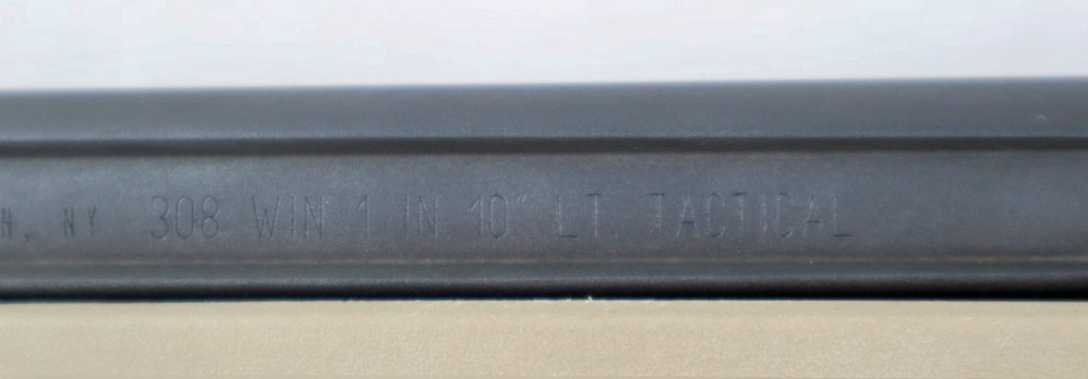

@Supersubes Here's a picture for you. The rifle is identified inside one of the barrel flutes. Does this help?

It's a Remington 700 LTR .308 Win that was probably dropped into an aftermarket stock. You can tell by the flutes on the barrel. It was probably threaded by a gunsmith, as those were never offered with threads, to my knowledge.
The LT. Tactical stands for Light Tactical...Hence the name "LTR"... or Light Tactical Rifle.
Sold a pile of them back in the day. They're typically known for being extremely good shooters out of the box. I wouldn't pay over about $750-850 used in the McMillan stock. Less than that if it's not a McMillan or Manners, or other high-end brand stock.

Going back to the 2012-ish time frame....the only factory 700's with a threaded muzzle was AAC-SD model. And I don't think they were out till 2014-ish. And 700's with 1:10 twist stamping were the AAC-SD 308's and the LTR's. A 2012 stamp really limits any potential for what it could be. Remington wasn't interested indoing threaded muzzles till they were bought out under that conglomerate.

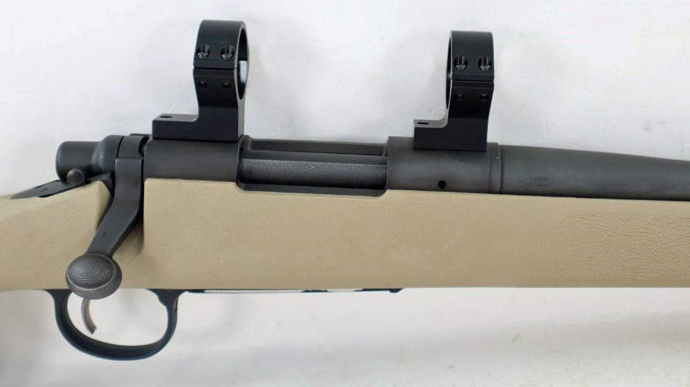

@reelserious @Haney Here is a R/H side view. Sorry that the barrel proof mark is not very legible.
This is a Lews Horton limited release SPS-LT Tactical in 1:10 twist and 20” barrel with tri-fluting. I’ve owned 2 of them (one threaded and one unthreaded. Both shit really well even in the SPS Varmint plastic factory stock. I put them both in new stocks. I sold the non-threaded version to get the threaded version.
Model numbers were 84206 and 84207 I believe.
I have the original model numbers from the original boxes at my house.
Quick search shows they may have started making more in the Hogue overmolded stock. Mine had the plastic varmint beaver tail stock with vents.
