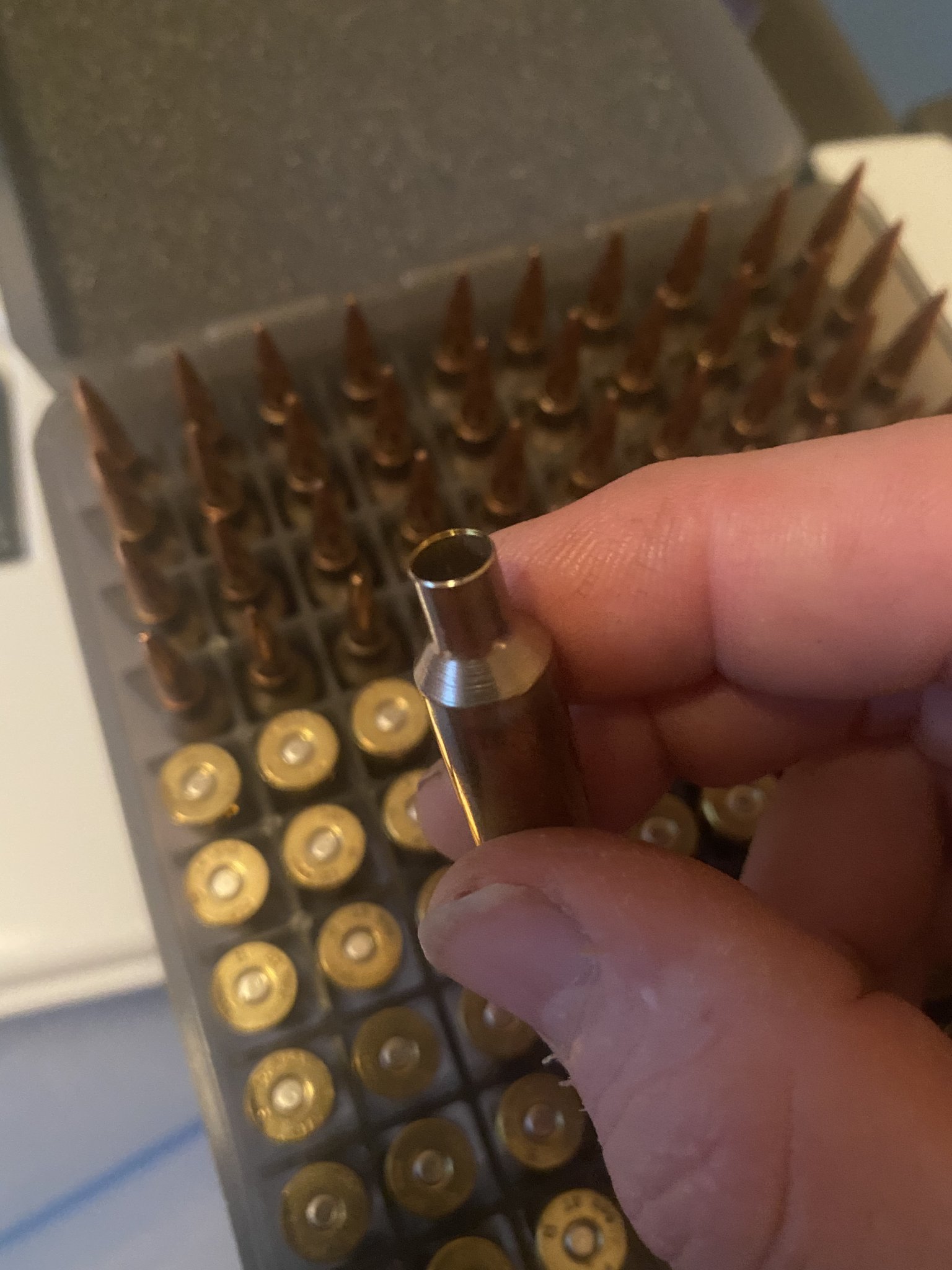

So I use a Gerardi power Trimmer to chamfer and deburr , I also have a Lyman case prep station where I also put a little more of a chamfer and deburr on some of my cases , I noticed when I’m puttting my bullets into my cases that the ones I’ll do the extra chamfer and deburr , there’s not as much neck tension, so what I did is re-anneal those cases and the neck tension was back to normal so is it a bad thing to anneal twice when reloading and I think I’m just gonna stop the second chamfer and deburr because I think it’s not needed obviously, The reason I did the second chamfer and deburr was one of my calibers on my Girard power trimmer was not set up correctly.
Thanks guys and Happy New Year!!!!

He said that some manufactures don’t anneal good enough, the force feels like It does when I only chamfer and deburr once, when I chamfer and deburr twice I can literally push in the bullet into the case by hand after I seat the bullet, it takes some forced to do it but I can do it, Normally I can’t so that’s why I annealed it the second time and now I can’t push it in by hand after the bullets seated
They all look like they did before as far as them being deformed

So I loaded 80 rounds to practice with this way, do I need to unload them all and start over or do you guys think that these rounds will be OK for practice
We're talking a few thousands of an inch deformation. Not something you can see.
Are you going to take advice from people who know more than you or are you going to argue?
