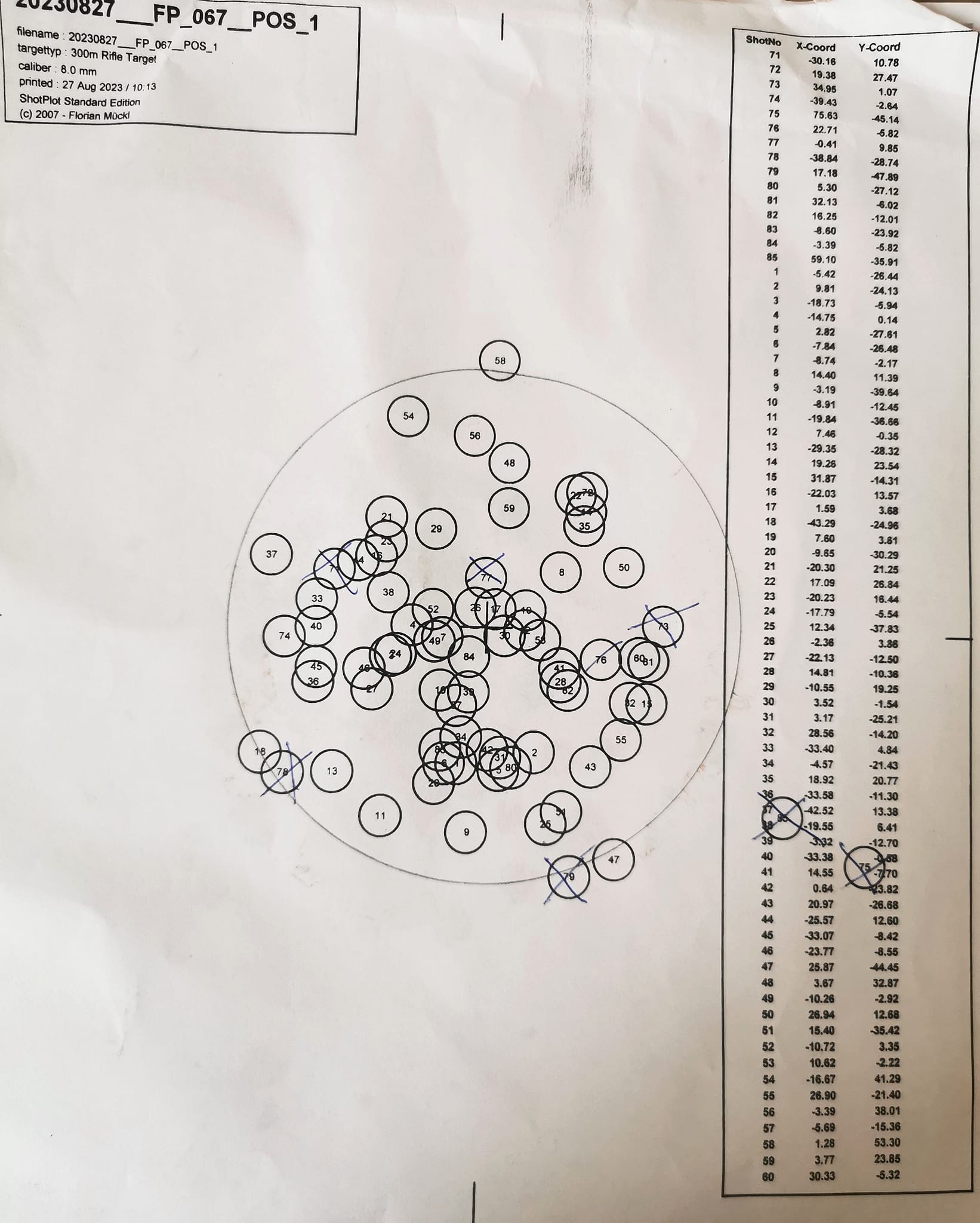

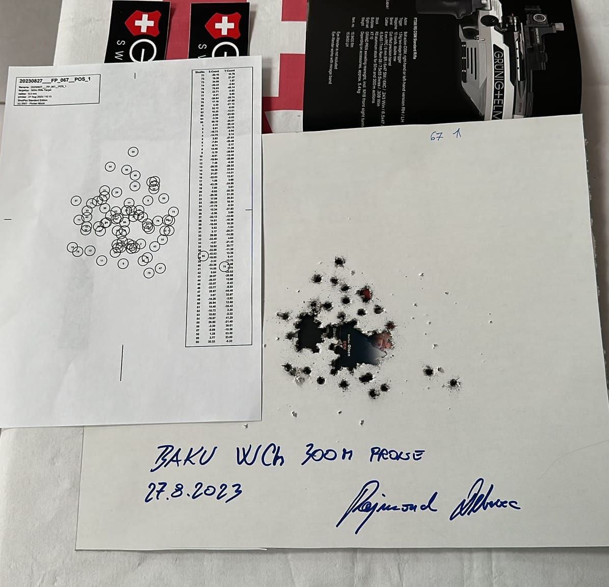

Good friend Rajmond of mine shot this couple of days ago
60rds (+15 or so sighters marked 71-85) at 300m prone ,off hand .sling diopter and with factory ammo (Norma 6BR)
New 300M prone world record for 60rds (6x10)
*circle is 10cm , 1moa is 87.3mm at 300m , so most of the 60+rd group is well under 1moa
Crossed over shots are sighters in the 6x10 course of fire

What is the barrel contour? Are these fired in relatively one long 70-80rnd string? What is the translation here to the OP question?
these are 6x 10 rd strings shot probably over well north of an hour, at around round per minute for each string , it still had to be a barrel ,ammo shooter combo to hold consistent POI
Relatively skinny, Palma like contour of a 300m free rifle , diopter and sling

I don't disagree. I just want to know the takeaway from your posting of this as it relates to the OP's question. Because I'd like to know too.
