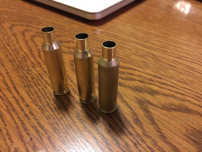

Heres 3 that I neck turned tonight, I did find out that I have a small donut though I'm able to push through it on the turning mandrel. I suspect once I anneal and use my carbide mandrel to set neck tension it should push it out.
Anyways, how do these cases look? Unfortunately I only have a 30 degree cutter for right now. Should I go a little farther into the shoulder or no?

Far left looks excellent bud !!
On the other 2, make sure your just kissing the shoulder. It looks like you used light pressure which makes the best necks. If your trim length is a thou off, go ahead and set it to cut your longer cases and eyeball/feel them at the junction.
If you already have donuts you will be reaming them as it will increase. I normally trim with a giraud, but I have the wilson trimmer that I use to ream with. If your expander is not pushing it out resizing won't get rid of it either.
I would seat bullets in those to see it they chamber correctly, then stop by the range to see if they will shoot ok.
Are you using a ball end mic to measure your necks ?
Unfortunately there's going to be some variation until after the first firing and I can properly trim them to a uniform length. I'm using the Sinclair neck thickness gage, those 3 are all at 0.0145" on the dot. I did not anneal the cases before I formed them so after I anneal them I suspect the donut will get pushed out instead of springing back like it did.
Some of them chamber really tightly in my bolt action so no matter what I'm going to have to resize them again after annealing, not to mention the neck tension isn't currently enough as it's .001" from the expander mandrel and I will be firing these in my AR-10.
I'm really hoping to avoid reaming as that's just one more set of tools I have to buy!
