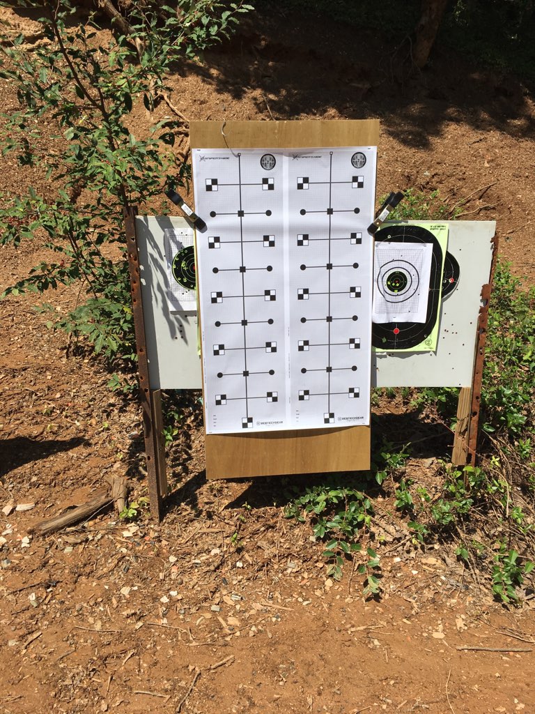

    I went to the range today with the Sniper Hide scope tracking targets purchased from Box to Bench. Very nice quality targets. Heavy paper and very crisp and clear printing.
    Because we have these...ah, kind of crappy target boards at my local club, I bought a 2' x 4' piece of thin plywood at Home Depot and a handful of .99 spring clamps. Stapled the target to the plywood, clamped the plywood to the target board, and with a long level I got the vertical line....well, vertical.

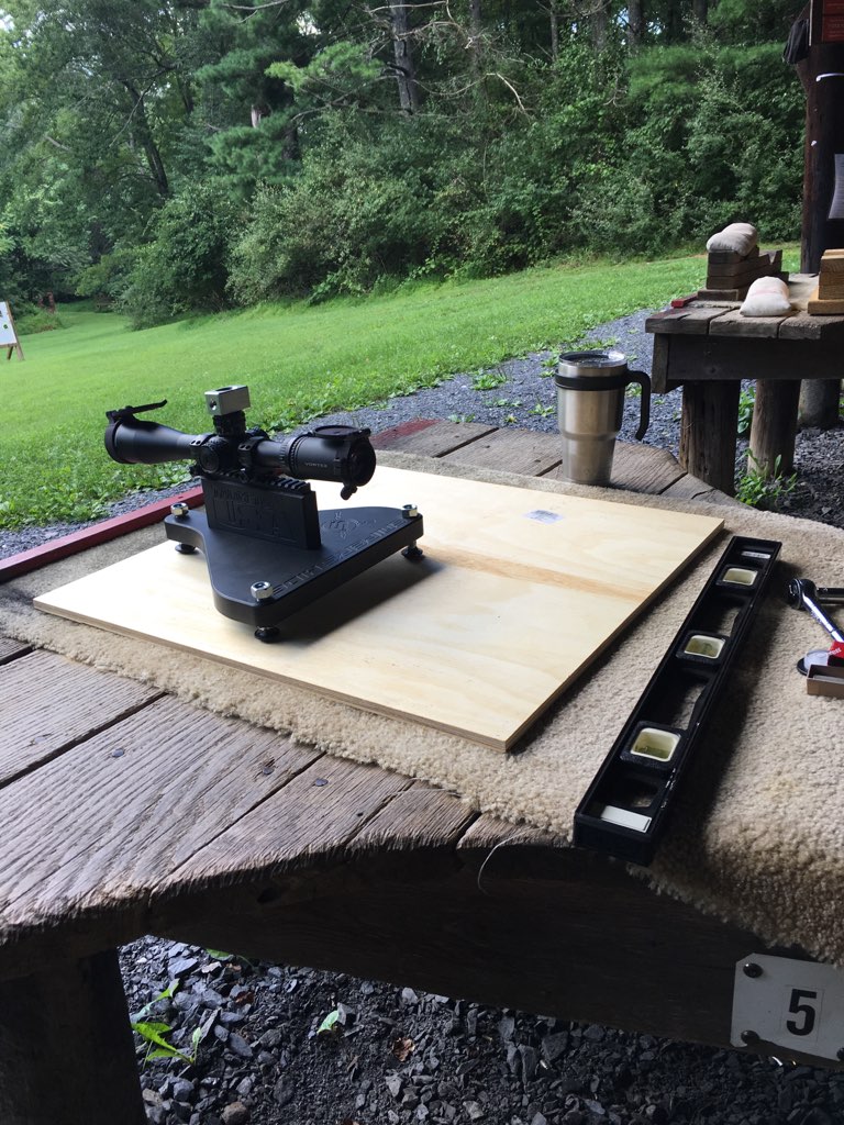

    Along with crappy target boards, this small club also has kind of crappy benches with old carpet that they nailed to the top. So, a 2' x 2' piece of thicker plywood was needed to give some stability to the test fixture.
    The test went wonderfully well. Took just a bit of fiddling around to get the fixture leveled (well, the scope leveled via the fixture) and on the proper zero mark. And from there it was very easy. I dialed up a mil at a time and checked and went up to 10 mils (most you can do with 36" target that I had) and it tracked straight down the line and was spot on for each mil. Returned to zero and damn, spot on again. Did this 4-5 times then did mil left and right at top, middle and bottom and again IMO the scope tracked perfectly.
