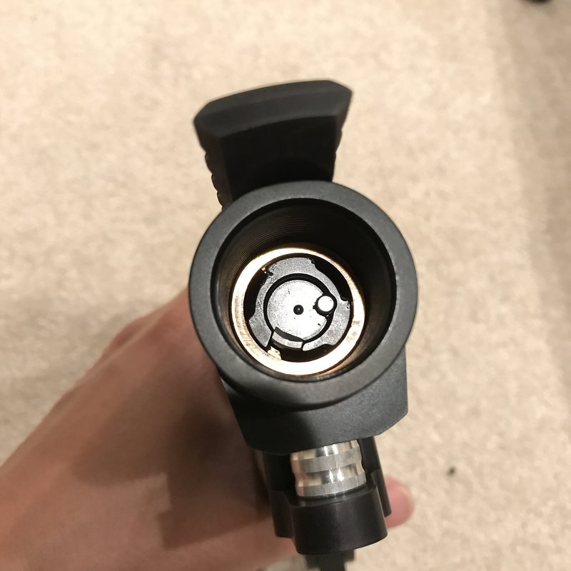

I was fortunate enough to snag one of GA Precision's 6 lug Tempest actions before OTM sold out. Upon inspecting the action, I noted the breach ring was losely floating in the receiver where the lugs would lock. My impression was that this piece was "pressed" in.
I'm wondering, how would my gunsmith barrel this action? I'd image the barrel would have to 1)thread in far enough until it contacts the breach ring to hold it from sliding forwards and 2) have a shoulder cut right where it meets the receiver face, simultaneously? I don't truely understand the concept of this breach ring and how its intended to work.

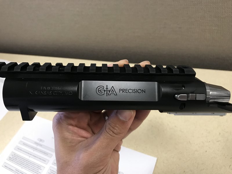

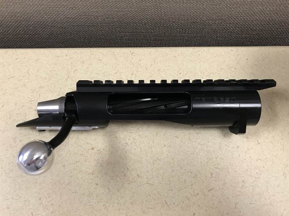

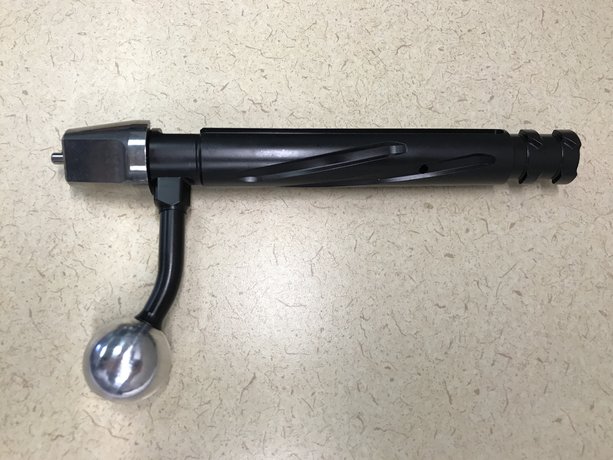

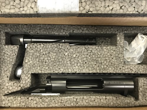

As a token of my appreciation, I've attached some photos of this beautifully designed and machined Tempest action.

Ga should have supplied a thread print with the action (mine had one). You'll notice that its a .001 window for tenon length (.949-.950). Very easy for the smith to set the tenon length after the shoulder is cut for proper barrel indexing on the action. I did my first tempest last week. No special challenges whatsoever.
Thanks for the replies!
Yes, I noticed the diagram included, but didnt know how to translate it. However, it makes better sense now that you've mentioned the window. Thanks Supersubes.
whats the purpose of the ring
Not sure what the most important purpose is from a design standpoint, but it allows for easier machining, easy replacement of the receiver lugs, and the ability to create the lugs out of a different material than the receiver body. The tempest breech ring looks pretty much identical to the AI breech ring.
