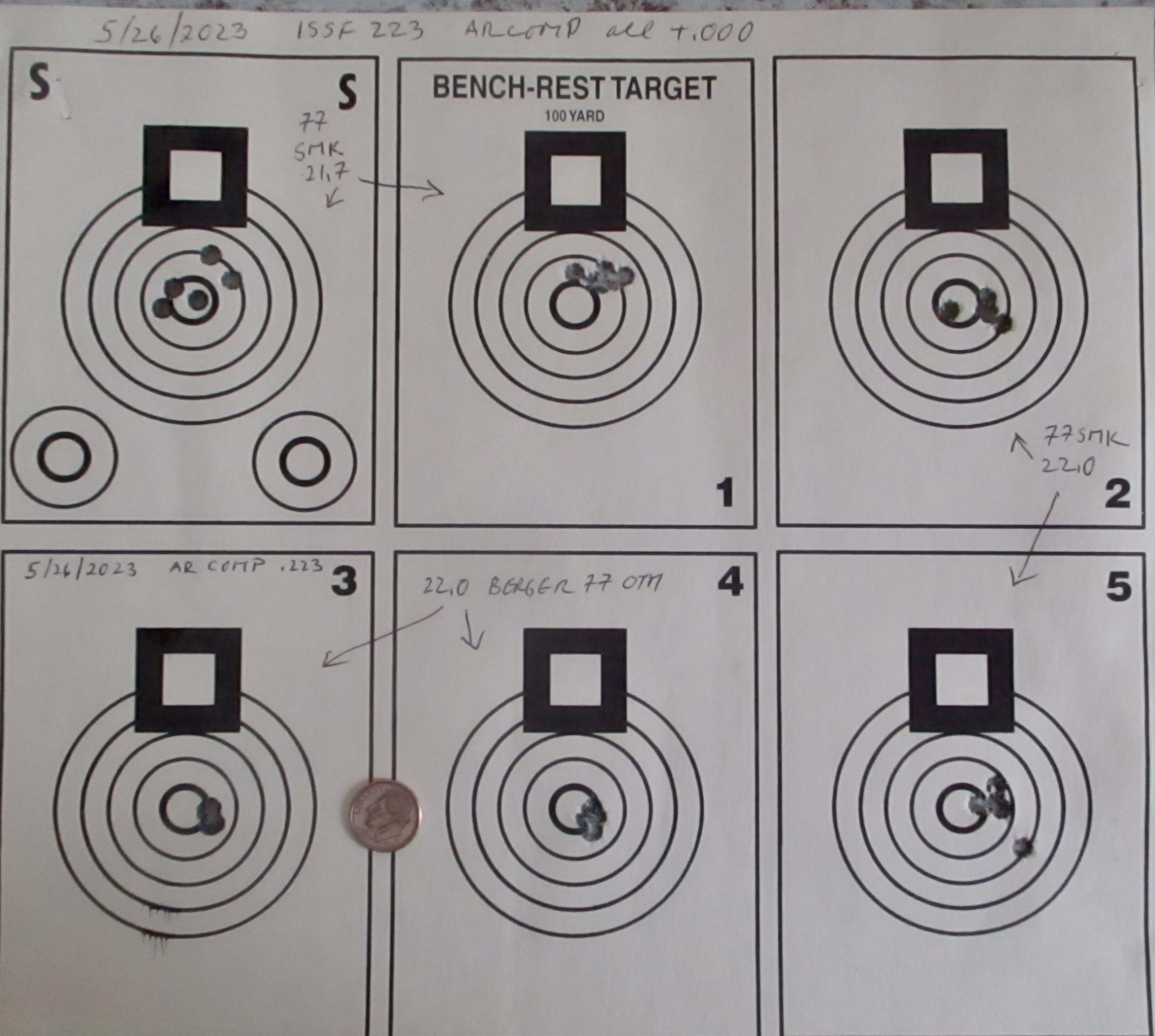

    Give Berger 77 OTMs a try. More accurate than 77 SMKs in my gas and bolt guns anyway. Four 5 shot groups at 100 yards with SMKs and two groups with OTMs on the bottom left:
