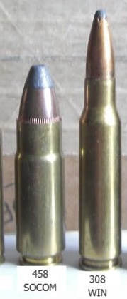

I am considering a project which entails reboring a 308 to 458 socom. I know case diameter wise, it’s a go. But the length of case is where I’m hung up. It looks like the case body/neck junction measures .4539” which next to the 458 socom case, it lines up with the mouth of the 458 socom (.458”) so it should work, I think? Currently waiting on a call back from Jesse at JES reboring so I will have a definite answer by then. But until them, I’m curious. Looking for anymore more competent in comprehending this than myself.

As to whether it's possible, you'll have to break out the calipers and find out. If the .458 SOCOM projectile is wider than the .308 Win case is at it's widest point, then I assume you could bore it and still be able to chamber it without having to do any cleanup work by cutting the threads back on the new barrel. If the .308 Win is wider, then you would be better off starting from scratch or spending $1,450 on one that is already worked and ready to drop in.
Good info, casing specs show the .458 is wider in all dimensions so I believe that shouldn’t be an issue. Thanks for the tips. I think width wise, it shouldn’t be an issue.

As a 'smith.... Ive built a few. 308 will work as a donor bolt face. You may potentially need to open up the internal feed lips to accept a WSM / SAUM style case, as on howa, rem700, few others. For after market rem700 footprint actions, many will not require such a mod, so does depend.
If you are using detatchable magazines, wsm again is a good choice, or potentially ar15 mags as thats what they were designed for. 30 round AR mag fits 10 rounds of socom.
The interaction of the bolt face to the rim is critical, as is the feed lip dimensions. They are VERY fussy to get to feed properly if you dont know about feeding dynamics and geometry.
14 twist works fine, however for heavy subs only, maybe a 10 or 12 twist. Ive done 720gr @990fps on 14t, so best look into that. Teppo-jutso designed it as 14t and subsonic.
Ejection off the bolt face can be a son of a bitch if you dont know about it. It will jam or pinch on the bolt face and the extractor wont want to let go. You need to relieve the bolt nose or the extractor itself, depending what type of extractor you have.
