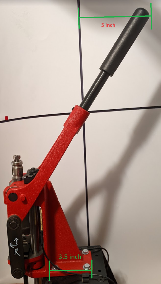

If you use a short handle and a throw limiter pin the handle will rest leaning toward the loader rather than the far wall -- more like this:.

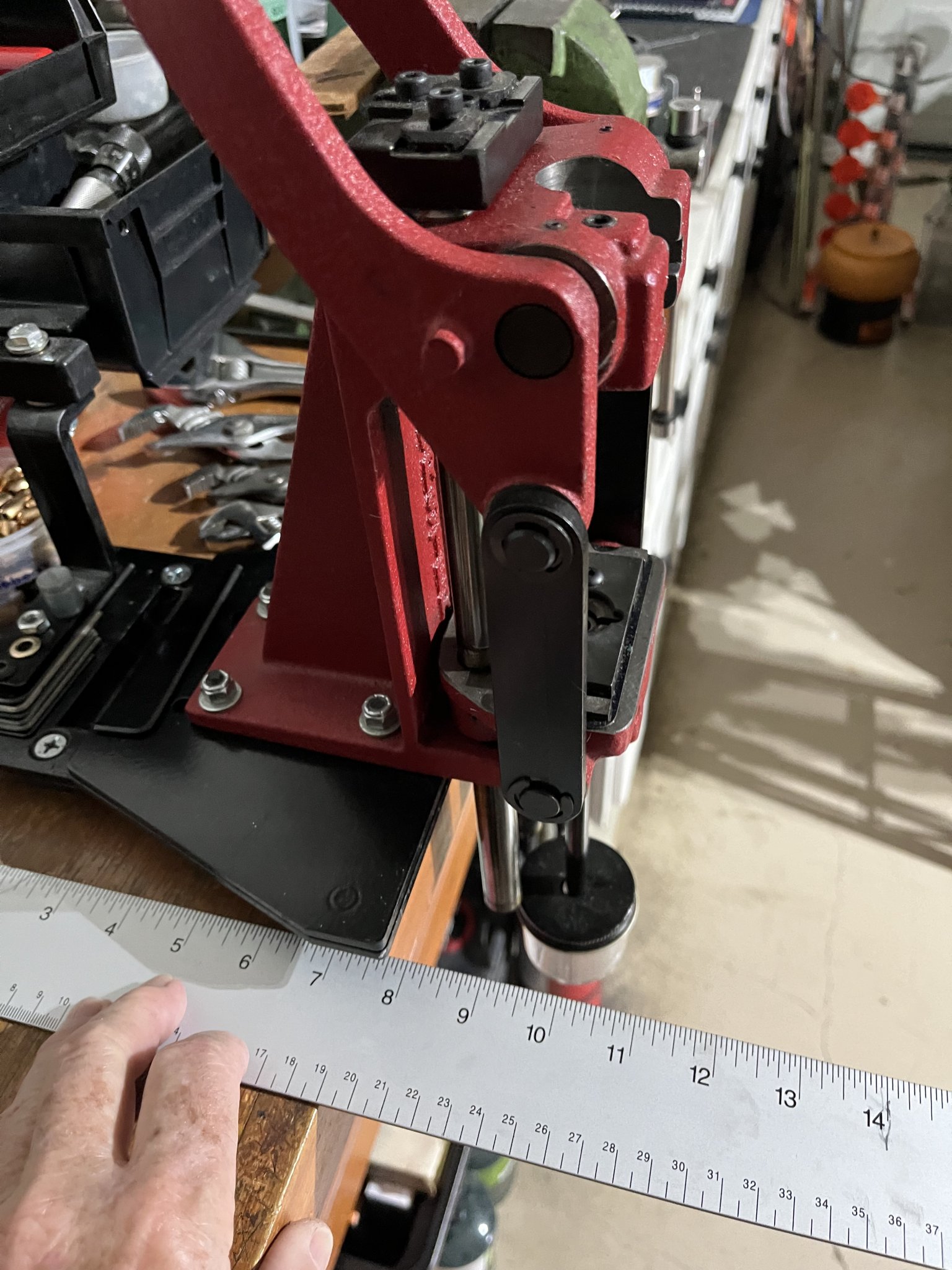

Rough measurements. Approximately 8.5" of bench required for standard handle length (if mounting directly to the bench). The standard Inline Fabrication Ultramount require a 11.5" depth of mounting space on the bench for the legs but, you'll need roughly 13.25 to 13.5" of depth in order to clear the standard length handle.
The Junior or Micro Ultramount will give you more room since it has an offset/overhang design as well as a smaller base footprint.
