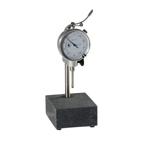

Are you talking about a headspace comparator guage used with a caliper or the general drop in type case guage ?
The latter I personally feel aren't much of a precise instrument unless you have a precision ground base and dial indicator to read them similar to the Sinclair bullet sorting fixture.
Something like this.
