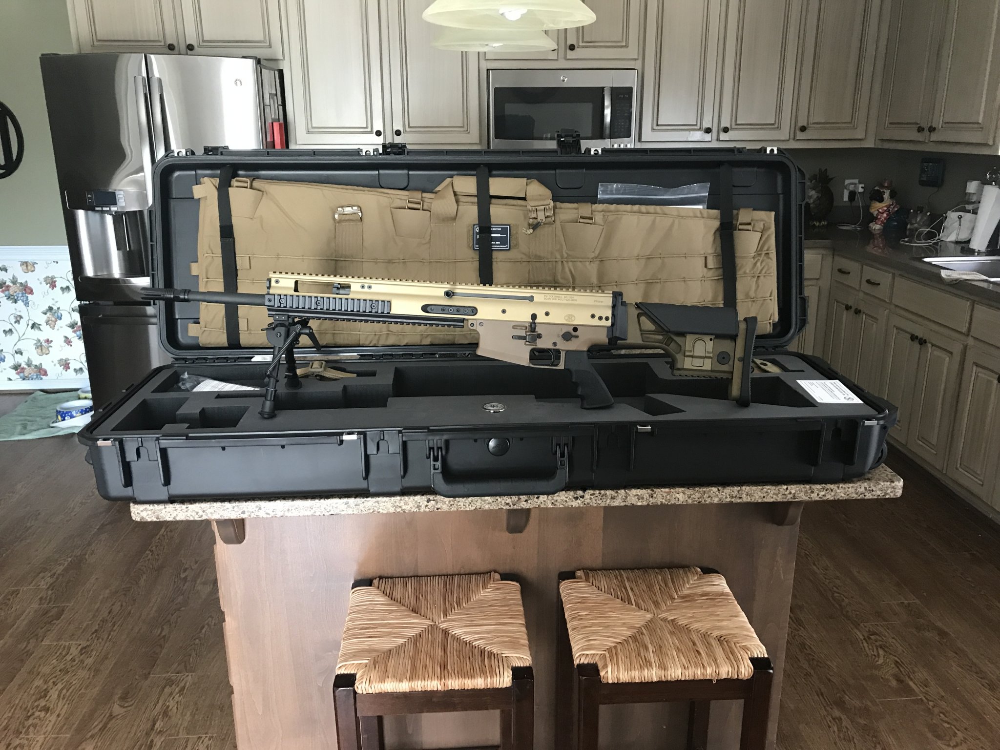

    I was one of the forty ones to obtain one of the newly released SCAR 20S. I don’t really have any experience in heavy caliber weapons this is a 7.62 x 51mm this is a little out of my wheel house. I am a retired Navy Chief Submarines, I am a weapons guy but like any good Chief knows when to turn to the real expert Shooters for a little help. Well having said all that, this weapon did not come with a scope. I am looking at a digital, but this heavyweight is not friendly to scopes, I don’t hunt I really don’t even go to the range that much. So I know I would expect y’all to go with an optics’s based but I really just want to be able to hit something at between 300/600 yards at a glance. Please share your opinions I am open to discussions. Thank All Of You For Your Service I know that if it were not for ruff men willing to hunt and take down our enemies with extreme violence this world would be a very different place, and I Salute you all.

    I know 308s eat optics and this one having a 20” barrel I was just looking for some advice for what could stand up to the recoil and not break the frame or the glass that’s all
    Honestly a 308 doesn’t have that much recoil especially in the platform you have. With a good quality muzzle brake it will be a pretty soft shooter actually. In your position I would look at the higher end Vortex optics. Vortex offers 40% off their retail prices to LE, Mil and vets. Several of the vendors here will honor that discount. If you want info on the vendors send me a PM and I will give you the info. Either a Gen2 Razor, a Gen1 Razor or an AMG if you want to try the keep the rifle lighter. The Razors are really nice optics but are by no means light weight. The AMG however is a little more manageable. To tell the truth a Vortex Viper PST is probably going to do everything you want and you could use the extra savings to buy ammo or go to a class to really learn how to use the scope. A class would really be a good investment. For starters you are going to have a lot of fun spending time with other individules with a passion for shooting. This will also give you the proper foundation to start from. I’m former military and had some pretty extensive marksmanship training at my unit. That being said I didn’t really understand long range shooting until I attended a 3 day class. By the end of the 3 days I was able to successfully make 1300yard hits with my first or second shot. After building that foundation it was a matter of getting out as much as I could and learning to read the wind. Anytime I see it is going to be windy which hasn’t been that often on the east coast I make a point to go to the range. Having a bad ass rifle is great but if you can’t hit anything with it what’s the point right.
    .308s in general do not eat optics. However, due to the mass of the large bolt carrier on a SCAR they have been known to damage a few of the lower end optics. This becomes an issue because that same large bolt carrier that reduces the recoil will actually slam home pretty hard after the recoil impulse. This forward momentum is what has damaged the cheaper optics in the past. Your high end optics have been built to handle recoil in both directions, the lower end optics will sometimes have a problem with this.
