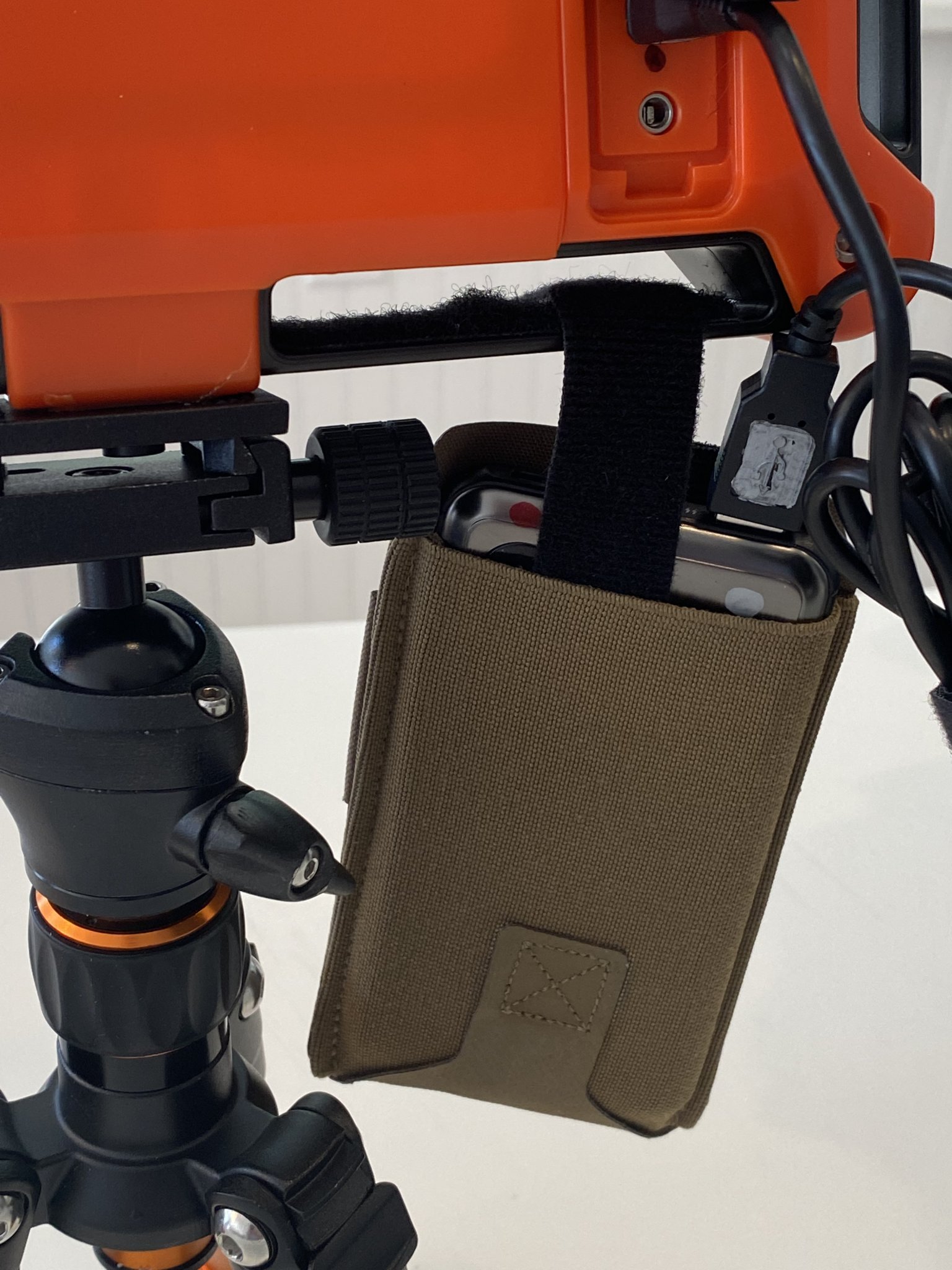

TIP: If using an external battery pack, secure it to the radar or the mount with velcro or straps etc. It falling is a great way to damage the the USB port or cable.

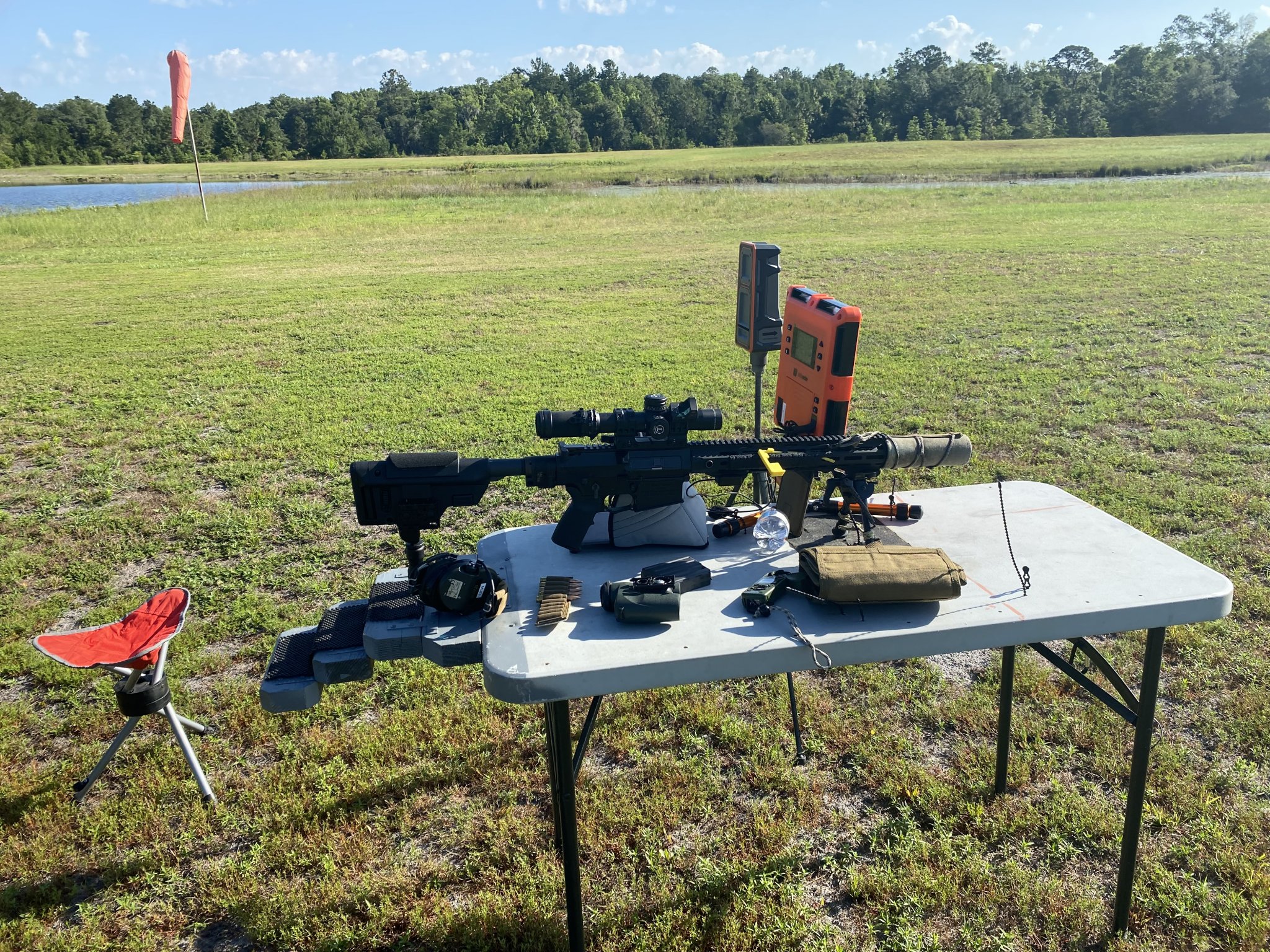

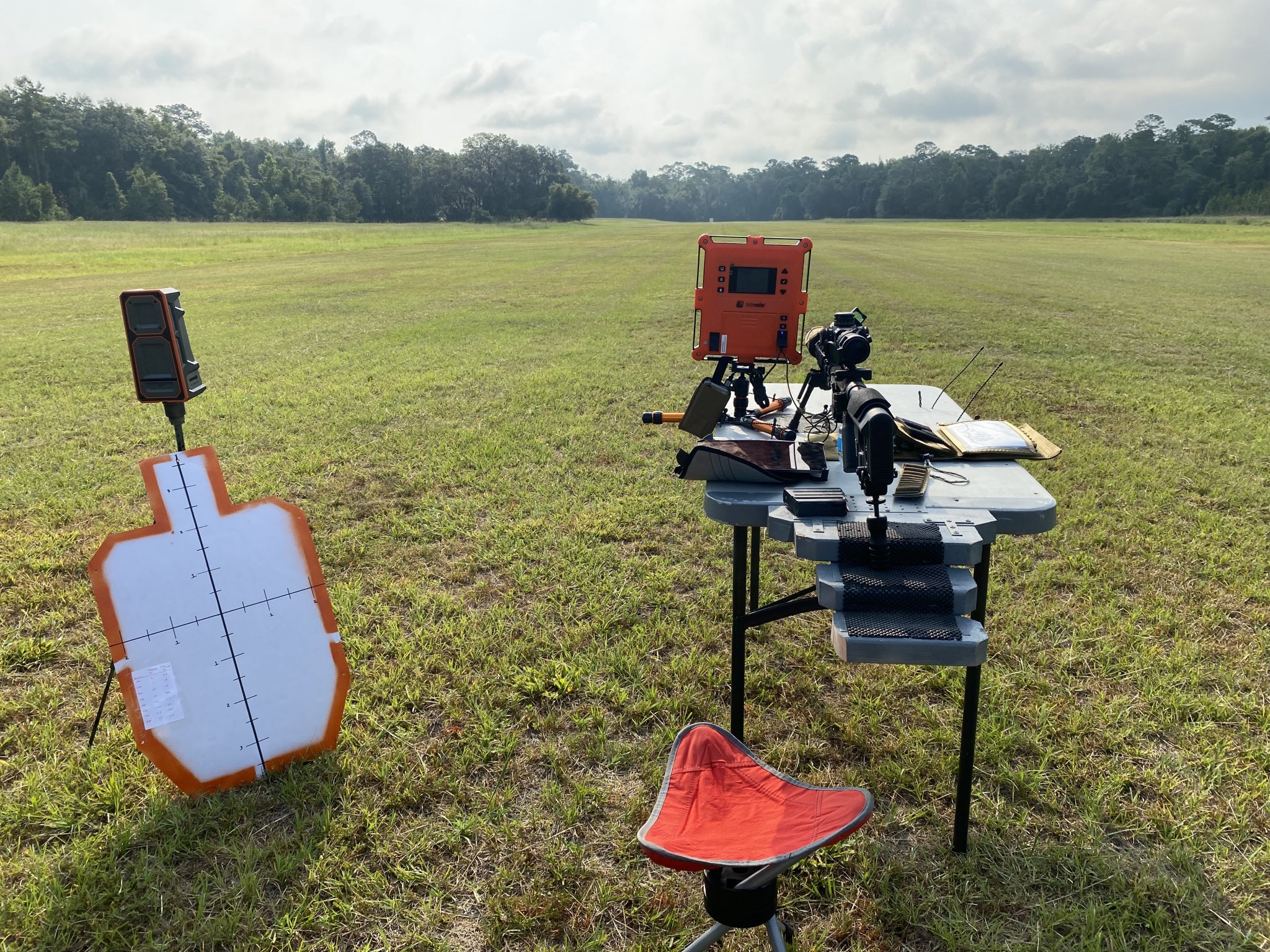

I’m not having any trouble using mine high and to the left as noted in the picture above. I just made sure it was aimed at my 25x15” IPSIC that was at 1000 yards.

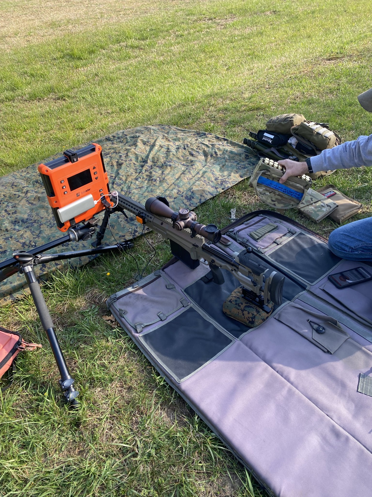

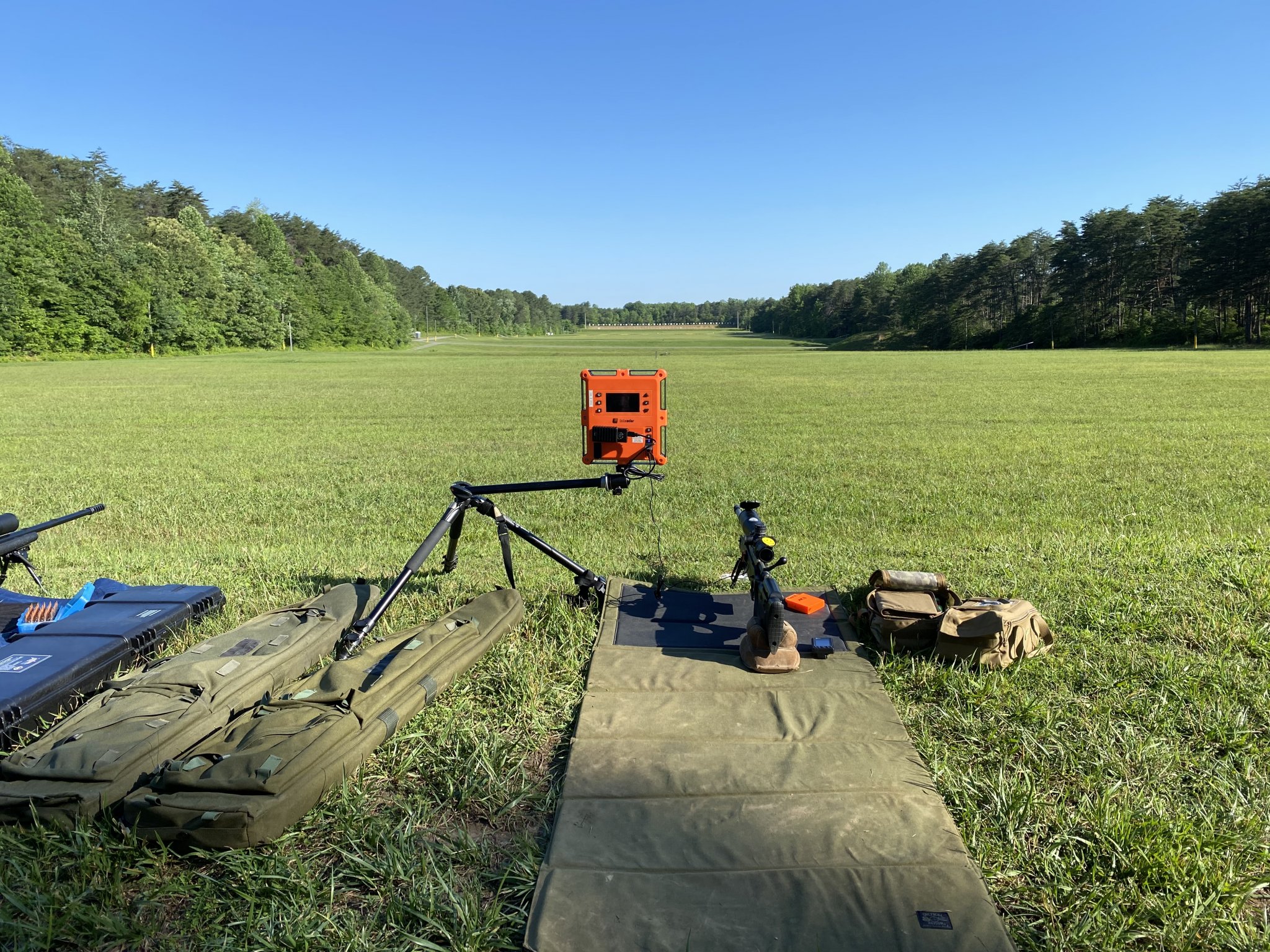

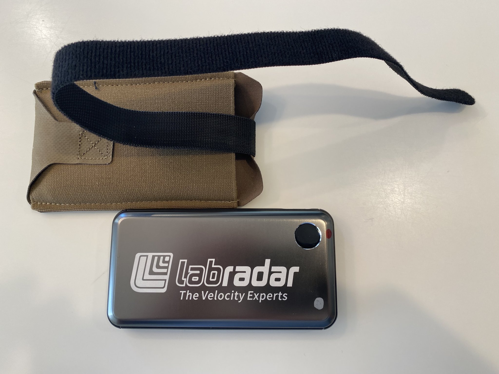

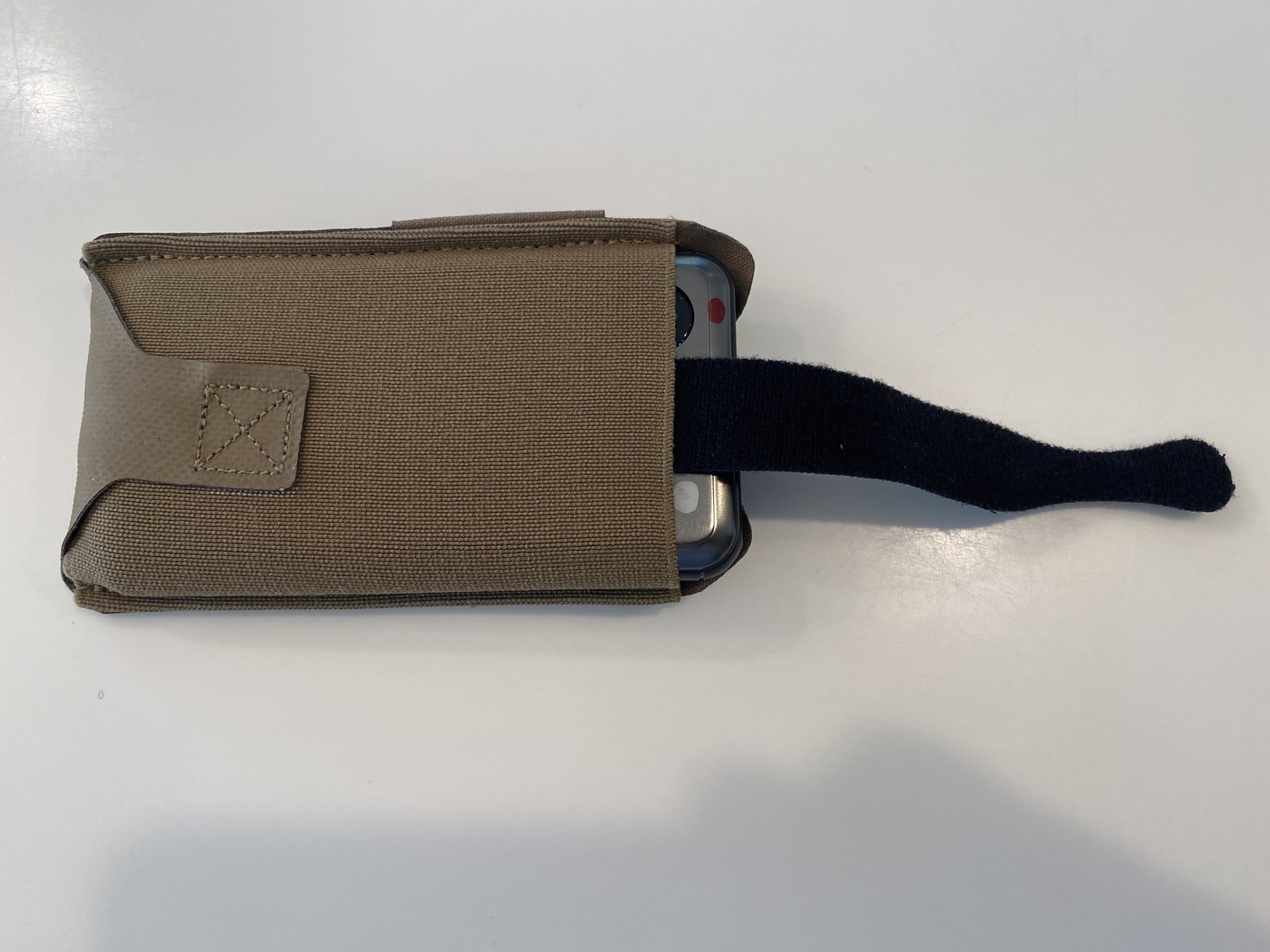

Using a JKL Precision trigger, LR sensitivity setting @ 5 for suppressed mode. Use a Blue Force Gear pouch with velcro attachments to the LR device. I make sure the LR device is square vertically to the ground as well as to the target.
