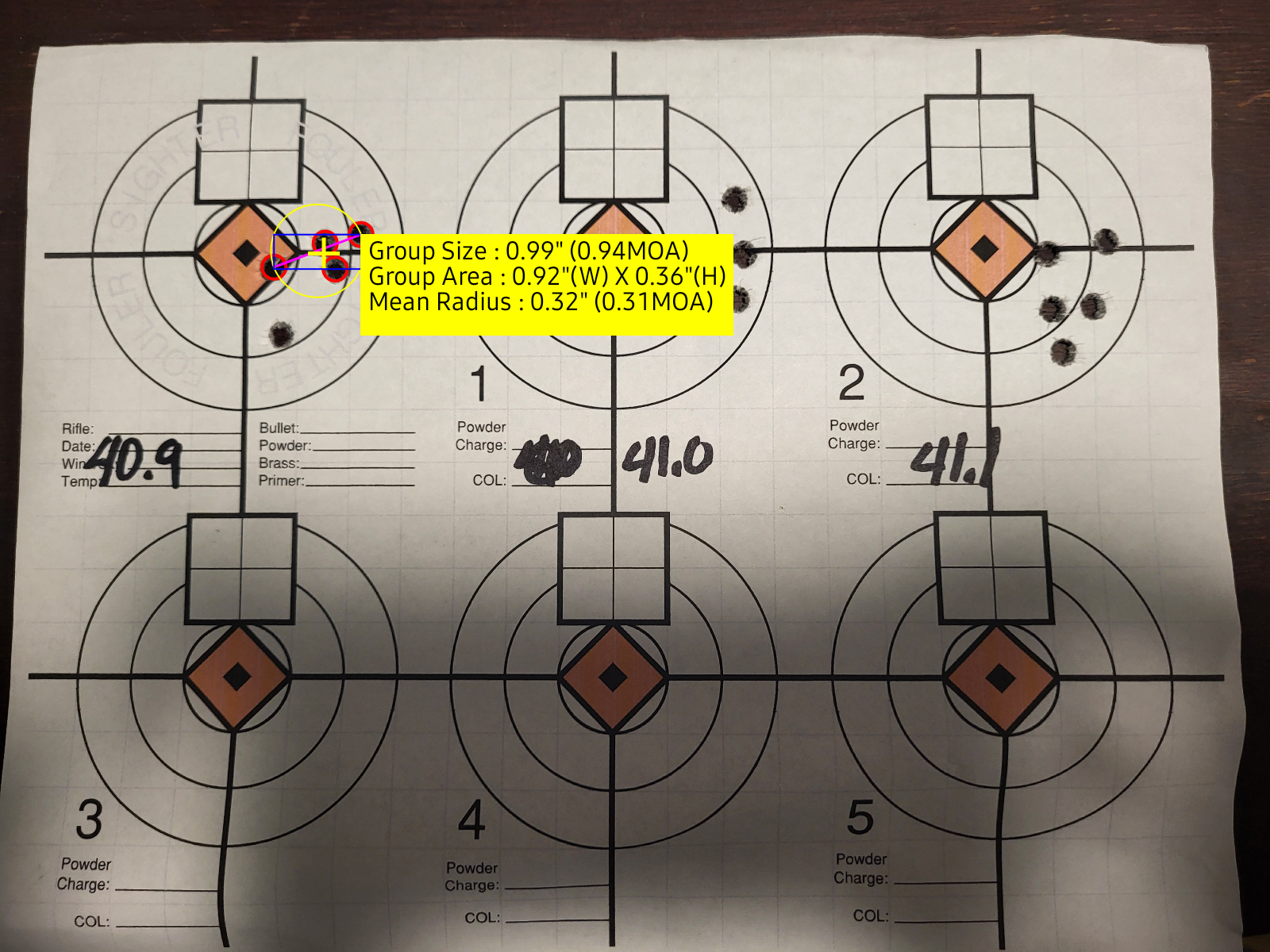

Been working on reloads for a 6.5CM.
First ill say I am still new with a lot of this and this is a hunting rifle. Not a precision rifle or a really super high end rifle either. But one that I do enjoy to shoot and hunt with.
Finally starting to get somewhere with help from one of the members here. Has been a huge help.
But I also have another question.
When you head to the range and start shooting. Do you start out cold. and record those groups.
Or do you run some sighters or foulers through the gun to get some heat in it before shooting groups for recording data?
The reason I ask is the 3 charge groups I shot last night all were somewhat consistant.
But the first group the first shot I made went low and opened the group up.
taking that one shot out the group and mean radius of the group would be much much smaller.
So just got me thinking if I should run this group again to see what it does if the rifle has some heat in it first.

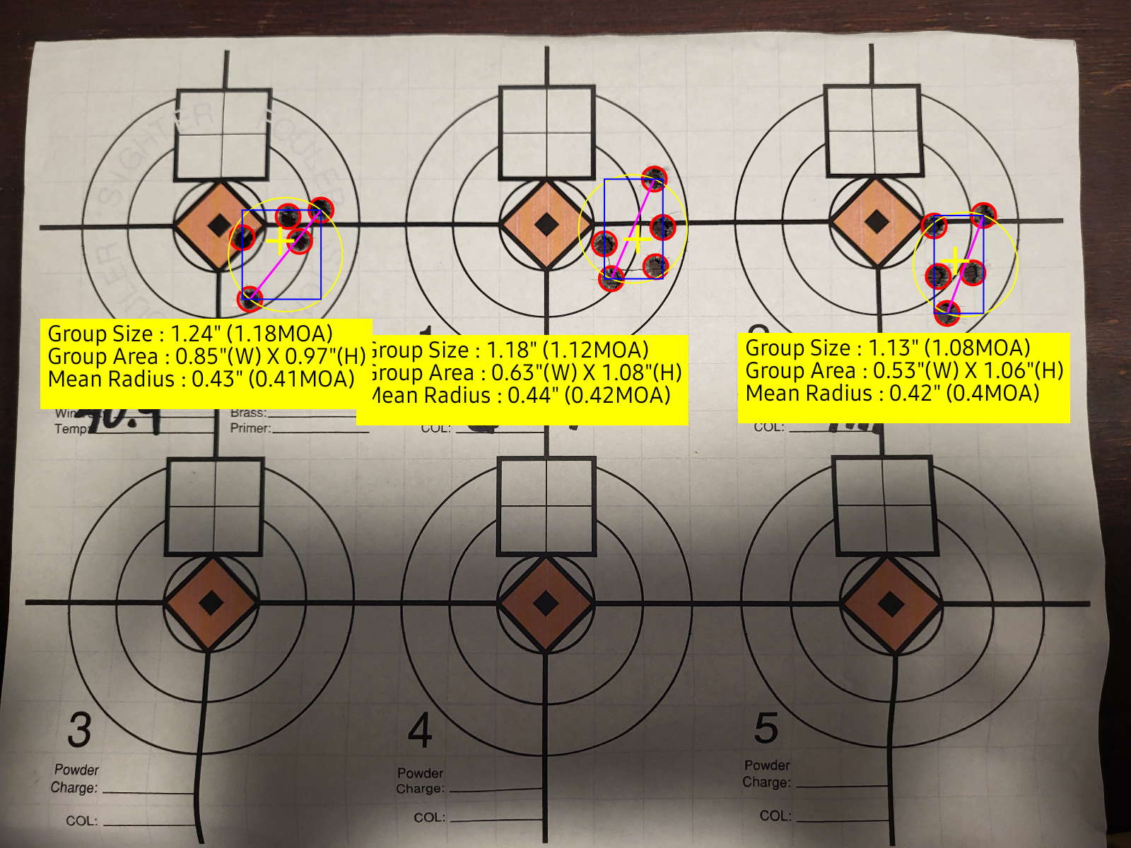

Here is my original target.
Here is the same target with the 1st target shot dropped. Which was the first shot made with the rifle cold.

Right now just trying to get a charge weight found so I can start working on seating depth tests to see if I can get a smaller group.
When the purpose of shooting the string is to determine velocity, SD, ES and trying to nail down an optimal charge and case configuration ... I use the top-3 outliers from seating bullets with my AMP Press as "barrel warmers". If I'm just plinking for fun, then I either don't measure velocity, or don't particularly care if there's an early shot variance. I've found that three shots is plenty to prep my barrel for accurate load development data.
Agree with rustyinbend, but if this is for hunting you also want to track what that first shot does. Some rifles/loads will have a repeatable difference on the first shot, and if that is your kill shot you want to know exactly where it will go. You can also try to work for a load and/or barrel treatment that does not do something different on the first shot.
Man, you went in .1gr charge increments. I'd fully expect your next group - if you repeated the test - to be just a touch over 1 MOA.
You have a fairly consistent load there, and that isn't a bad thing...other than it isn't giving you the accuracy you're after. It also testifies a bit to your own shooting consistency.
.1gr increments are a quarter of a single percent difference in charge weight for that cartridge. To expect significant difference in results with minute difference in inputs is a good way to expend extra ccomponents. Maybe try .75 - 1% increments (.3 - .4gr), and you'll be able to cover a much wider range of potential charges that work well in your rifle.
Or, you can keep it at 41.0, and try some seating depth tests if your happy with the velocity results from your initial test.
There's more than one way to be successful at this, which is why we argue in these forums all the time. I've just never had a "good" load that was a quarter percent away in charge weight from a mediocre load - hold up.
Reactions: Aftermath and R_A_W

That single low shot is perfectly within the normal dispersion one could expect within a 1 MOA load, especially when just a tenth or two more dropped one even lower.
