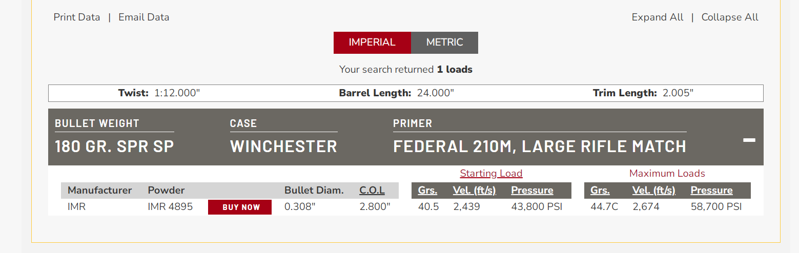

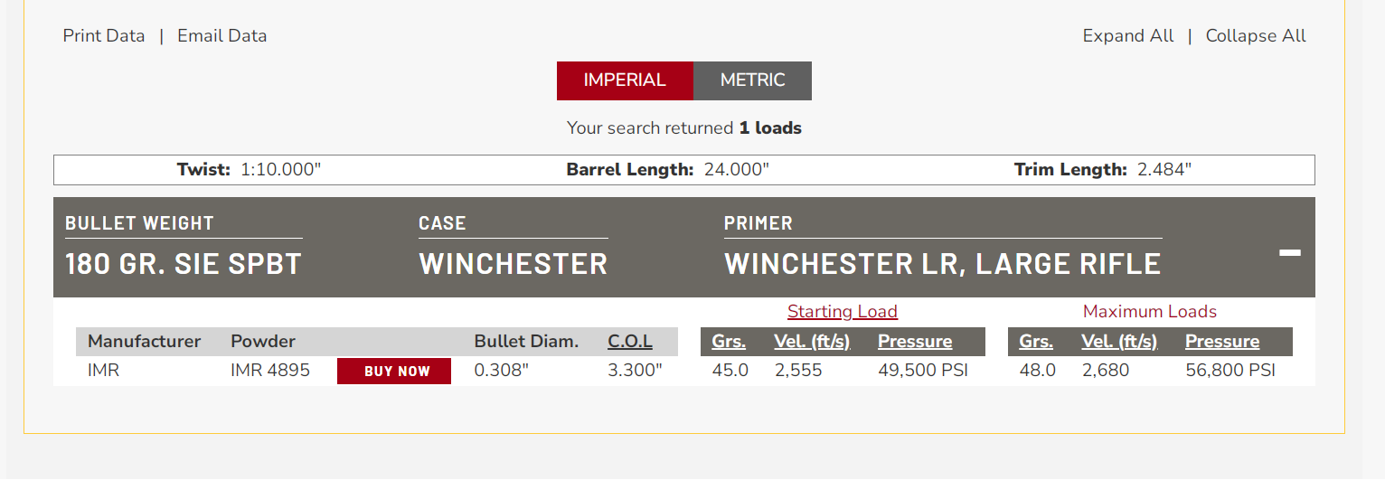

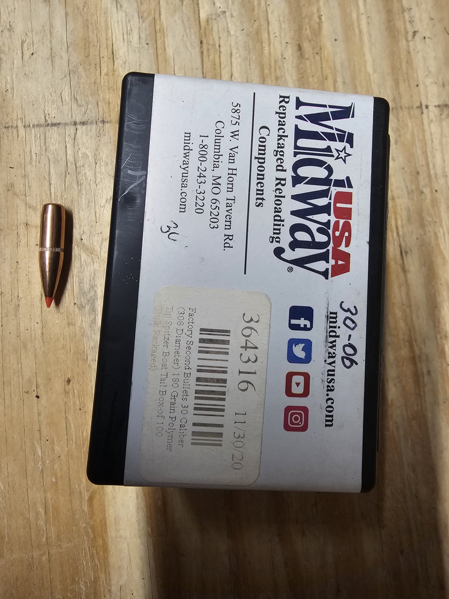

New to reloading; I picked up some 308 180 gr polymer Tip Spitzer Boat Tail factory seconds from MidwayUSA. Im looking at the loading data in my reloading book. As far as Rifle Data, would these particular bullets be referred to as SIE SPBT?

OP, find out what bullet/maker you have . Midway sells "lead free" seconds and jacketed bullet seconds , proper data is important .
I've used Nosler's load data a lot for 308 Win. It works well for cross referencing load data. But I don't count on a single source of data for an unknown bullet. I'll use three or four manauls. Since there are a few polymer tipped bullets 2nds on midway it would be better to narrow it down to which one he got and go from there. Just my 2 cents from the peanut gallery.It’s not bad advice.

Thanks againUse jacketed bullet load info , not for solid copper and you will be fine .
As mentoned it looks like a Hornady SST , tons of data out there for that bullet .Thanks again
I never noticed that , good catch . That changes everything .I saw "30-06" written on the box. Just to confirm are you loading for a 308 Winchester or 30-06? The title of the post threw me off.
Yeah, sorry. You are correct. 30.06. I was referring to the diameter.I never noticed that , good catch . That changes everything .
30-06 data , Sierra bullet .
