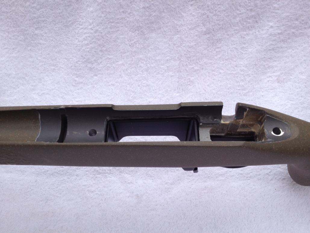

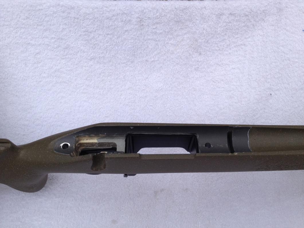

I want to thank all who responded to my questions. I took the advice given and am very pleased with the results. I bedded the action and pillars in one step then the next day bedded the bottom metal. No bubbles or wrinkles, I used devcon and kiwi as the release agent. The tips you guys offered made all the difference.
Was a bit concerned when at first the action did not release. Turned out the recoil lug was very snug and had to be massaged out with a mallet to the guide bolts. But again thanks for all the help.
Ok I took some pics with the phone cam. For my first attempt at bedding I can live with the results. I put some niks and scratches cleaning up with the rasp and dremel. Does not compare with what I have seen posted here but I think it was worth all the effort put in. Will get it to the range soon and test the results. Thanx again for the help!
