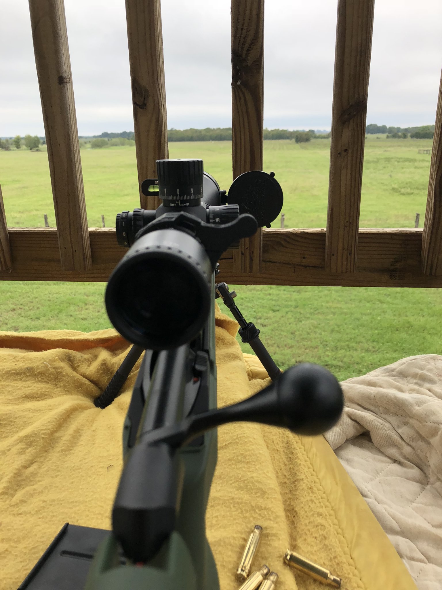

    New to longish range shooting. Yesterday was second time out to 600. First time was in October. Just figuring out how to set up apps and all that. But had a question.
    shooting in TX. 6.5 tikka CTR 24” shooting American gunner 140.
    In October my dope was the following:
    500 yards 3.4 mil
    600 was 4.4 mil
    Mild day with little wind.
    Yesterday
    500 yards 3.7
    600 yards 4.9 mil
    Windy and cold.
    500 yard delta was .3 mil
    600 yard delta was .5 mil.
    Wind was easy to account for but all day my old dope and old trued loads from October where low.
    Is this kinda change based on weather alone normal? Same lot of ammo. Same exact set up as before.
    Guessing not but I really do not know.
    Also have never held 1 mil for wind before and that was really cool.

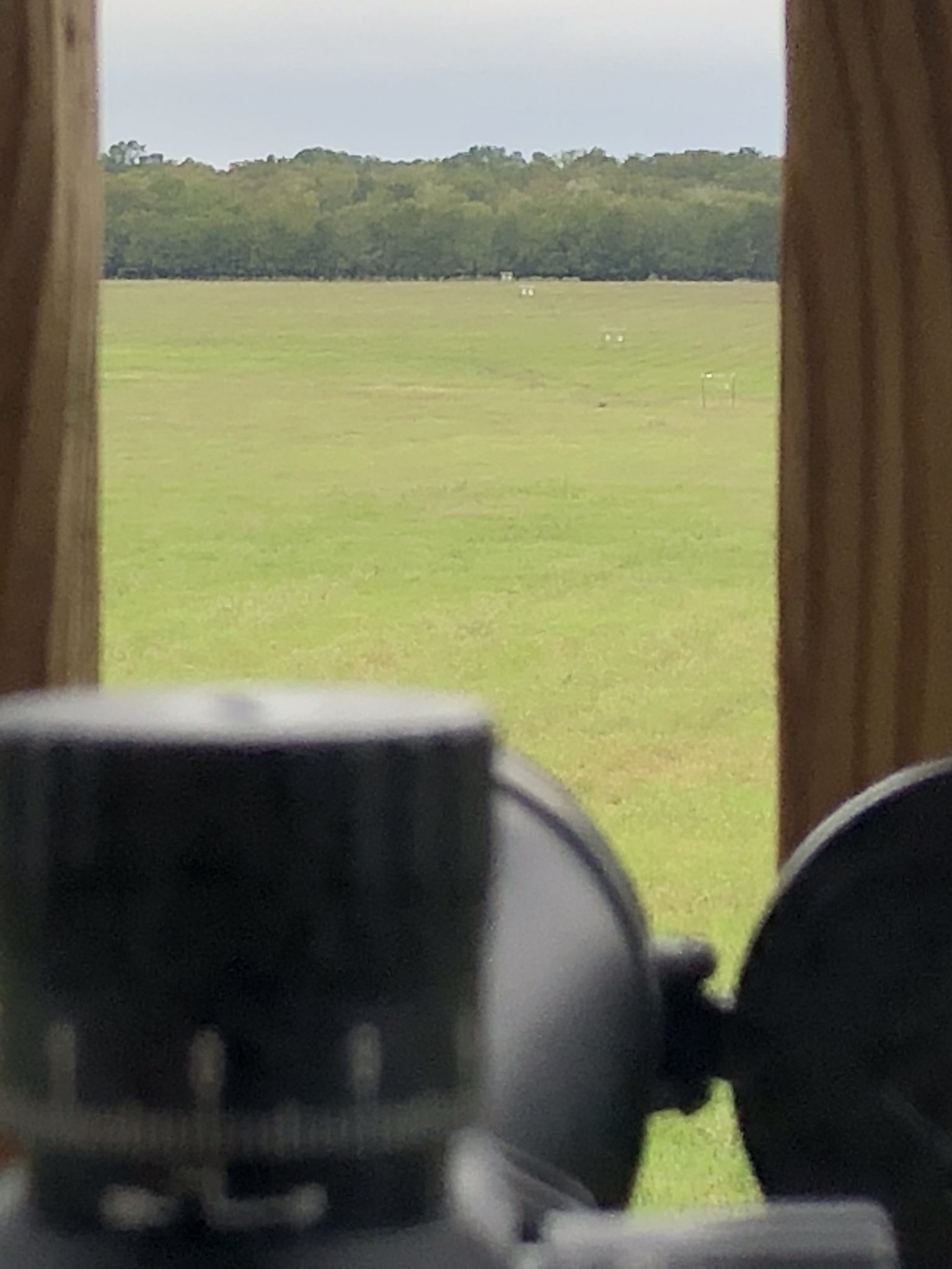

    Pic of range attached from October (no targets set up at 400). Range has targets from 200 to 600 at every 100. Shooting prone from second level porch. So am able to walk out to 600 figuring out wind and drop as I go.
