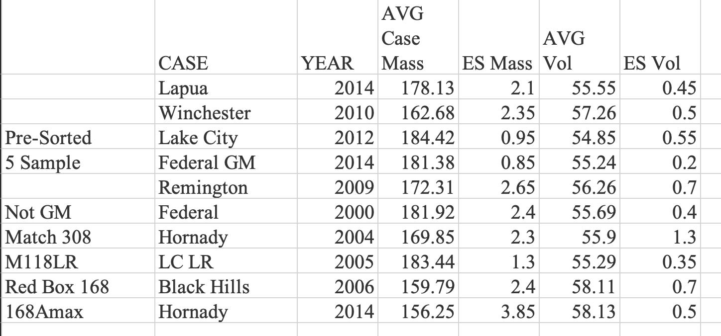

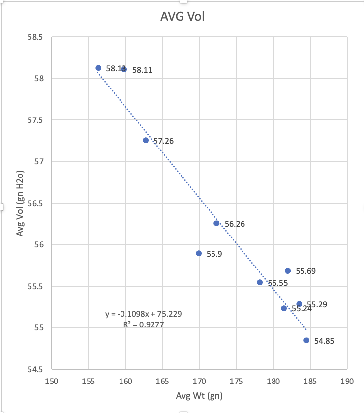

Since @straightshooter1 brought up weight sorting and there is a lot of recommendations and advice about not weight sorting I through this in. If you ar looking a real precision reloading for bench rest or F Class it isn't the most accurate way to sort. BUT when faced with trying to take a large bunch of Federal or really any other brand it is better than not sorting. There is a definite relationship between volume and weight. There is a variance due to the machining of the extractor grove and also the length of the case. There is also the possibility that the grade of brass is different between lots which have different densities.
The info below was obtained about 10 years ago and gives you some idea about the relationship of varying brass weight and volume. It was fired and resized then trimmed to all the same length.
Just to make a point about differences in case volumes from one lot to another, looking at this chart of various brands, note the difference between "Federal GM" and "Federal (Not GM). Just a few years back I called Federal and asked if there's a difference between their cases labeled "Gold Medal" and those that are not. He advised that they do not have separate production for GM brass or that there no sorting of brass that comes off the production line; they're all the same. Therefore, this chart shows how there can be a difference from lot to lot.

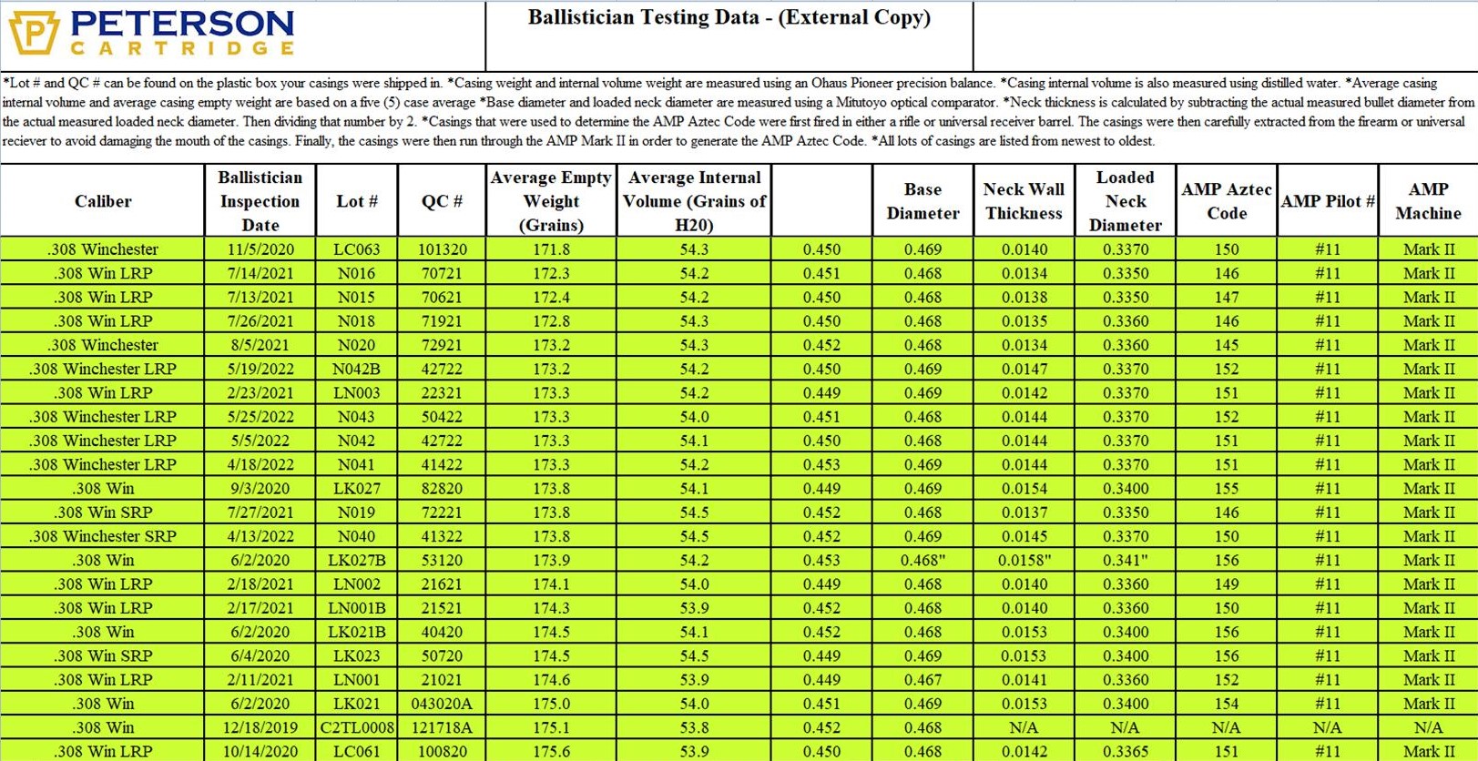

This difference in volume between lots can also be seen in data from Peterson Cartridge company's data:
