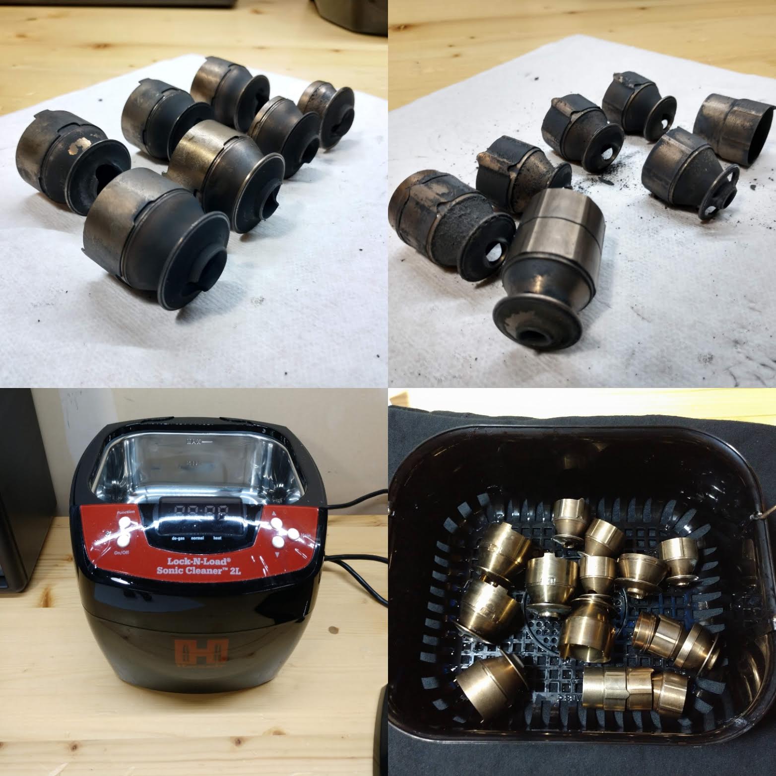

    I use an ultrasonic cleaner with a 50/50 mixture of distilled water and Zep purple cleaner. I run them for 15 minutes and then take them out to pick at the stubborn spots (they are mostly clean at this point), and then I run them for another 10 minutes to finish up. I let them dry and then coat them in white lithium grease before reassembly. The baffles shown below are from a Dead Air Ghost shooting 9mm and a Dead Air Mask shooting 22lr and 17hmr.
