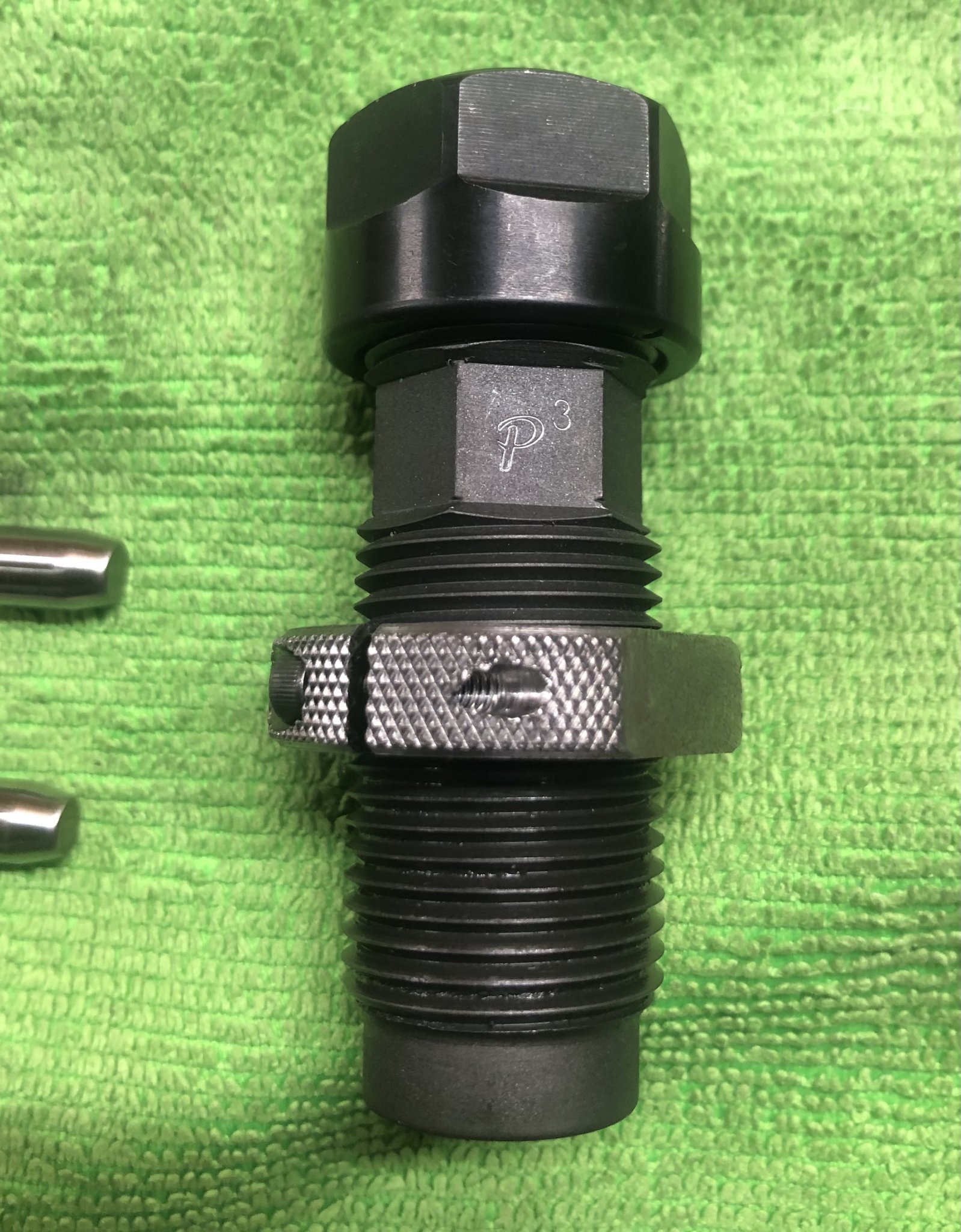

Question on pin gages vs. expander mandrels
rady
Sep 16, 2020
405
447
Never used pin gages before, so I'm curious about this product or others that may provide better results than expander mandrels?
Trying to make a decision on the 21st Century incremented expander mandels or other products similar to the above, so your opinions would really help out. What would be the best way to size the gage pins with regard to +/- 0.0002error for a particular caliber like 6.5 CM (0.264)?
Um…those are expander mandrels…he just specifies that he makes them using pin gauges that he modifies by tapering/polishing…don’t over think this. The linked set or the 21st century set will serve you well to expand case necks to desired dimensions. If you want a set of pin gauges for measurement purposes, buy pin gauges.
Will the 21st mandrel set(s) work in the Sinclair gen II expander body?
It has a mandrel but it’s actually a collet die. It sizes the brass down squeezing it to the mandrel. It’s not intended to open up brass that’s already been sized down like so many of the mandrel expanders do that get discussed these days.
I would pair this Porter collet die with a body die.
I guess I would need some clarification from porter….I didn’t read the description this way. I assumed the collets were being used to hold the mandrel…
at any rate, not sure about the Sinclair expander body working with 21st century mandrel…but, they have excellent CS so an email should answer that question.
I deleted it, youre right. too early for me I guess. I was conflating the porter and the larry willis together into some dumb abomination of imagination.
Reactions: supercorndogs
Pin gauges are shaped to gauge. Expander mandrels are shaped to expand. Use the correct tool for the job.
Ok..........So if I use the 21st to expand and pin gages to measure, do I go to the + or - side for the error in spec.'ing out the gages? Looking at McMaster Carr, they are pretty expensive (ZZ type). I could just use the cheaper tapered pins from the above vendor or is there a better/cheaper source?

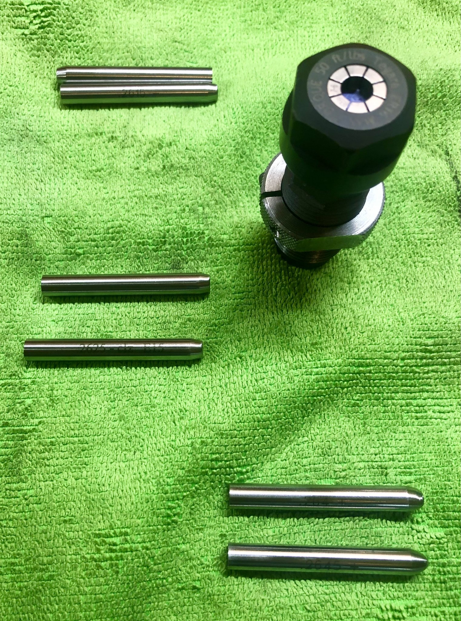

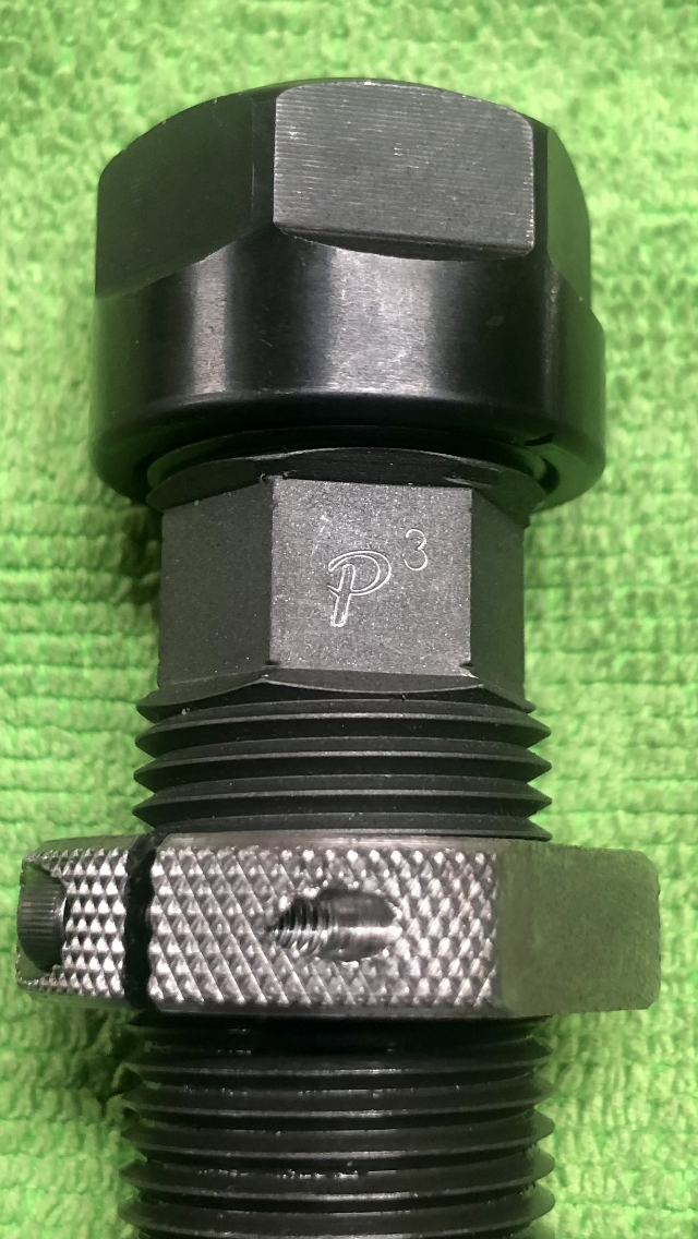

Porters die uses a collet to hold a modified a gauge pin to expand your necks, his setup allows you to choose a neck
tension outside of what a standard expander mandrel or turning mandrel would provide.

For the OP, buy the 21st century set of whatever you’re loading (6mm, 6.5, .308, etc).
Then get the pin gauges of the inside diameter/s you want. For example, I have .241 .2415 and .242.
Decide which inside diameter you want with your current batch of ammo, and experiment with mandrels until you get the desired fit on the pin gauge. That mandrel *should* work for the rest of that batch. Check every so often with pin gauge (or every one if you want to go ape shit) and make sure you’re still getting the desired fit.
Keep in mind, as brass is used (despite annealing at times) you may need a slightly different mandrel next time. For example, I’ve had to change from .242 to a .2425 after X amount of firings to retain the fitment I want on the chosen pin gauge.
Large issue I see with people loading ammo is they really don’t know what the ID of their brass actually is.
They either do math that doesn’t account for spring back or they account for too little/too much spring back. Or, they measure with calipers which won’t give you a good reading for something like this.
Pin gauges solve this. No math or anything else. If you want .241 ID for .002 “neck tension” then you try the mandrels around .241, .2415, .242 and see which one gives you the desired fit on the .241 pin gauge.
Test at range with brass that fits .241, .2415, .242 pin gauges and decide what to run. Now that becomes another comparator QC check. Use it to pick the proper mandrel next batch and to QC check.

After reading this i got the mandrel die from Porter Precision Products (P3, a company based in Lake Jackson Tx, close to Houston). Bought a set of low cost pin gauges from Amazon in 0.5 thou increments (0.0005”), and then shaped them (gradual taper) using a Dremel. The setup works really well, and very happy with it.
Can now accurate control neck ID, and compensate for springback differences as the brass ages, and get back to the same seating force as before when i switch from an old batch of Lapua brass (retired at 25 firings) to new Lapua brass (both from the same original box). Very easy to get speed and interference fit the same as before, keeping group size almost the same. [Had to adjust the powder charge by 0.1 gn, as the new batch is slightly thicker. The originally batch was weight sorted into two groups of 2 grains each.]
As said before, every mandrel/pin serves as a pin gauge for measuring via the and as an expander mandrel when clamped in the die. You don’t need to buy the super accurate pin gauges ($20), and the cheaper $5 versions work fine, just double check them with a micrometer to 0.1 thou accuracy, and write that on the pin with a permanent marker.
I am sure the 21’st Century set would work just as well, but if you run multiple calibers, the P3 mandrel die combined with low cost Amazon gauge pins is cheaper, and more flexible.
Reactions: Terp and rady
I figured out that the AMP machine (using the Aztec code) makes the neck soft enough that you cannot run anything more than 1.5-2 thou of interference fit without the bullet resizing the neck. Tested on 6.5 CM Lapua brass - neck turned to 12 thou.
Springback is about 0.5-0.7 thou with 12x fired Lapua brass, annealed every time, and worked as little as possible. Max seating force is 41 - 45 lbs with a 0.2620” mandrel (6.5 CM so 264 bullet diameter), but if you pull the bullet, the neck OD has gone up compared to prior to bullet seating. The bullet is clearly resizing the neck!
As an experiment, i tried different mandrels/pin gauges:
0.2640” mandrel: Mandrel is actually -0.2 thou below bullet diameter (0.2638”) according to the Hornady micrometer, which has been calibrated against an accurate gauge block. So “neck tension” is mostly due to brass springback in this case (about 0.7 thou). It gave fairly light but consistent seating force, and measured with the K&M arbor press, seating force varied between 12 and 16 lbs. That is consistent enough for 800 yard ammo. [Btw: At 2-4 lbs you can rotate the bullet by hand, which is a bad thing, not magazine safe, impractical.]
0.2635 Mandrel: At a nominal 0.5 thou below bullet diameter (actual measurement is 0.2634”) it gave seating force between 18 and 21 lbs. The actual interference fit is 0.7+0.6=1.3 thou due to 0.7 thou of springback. This ammo works fine in mag fed rifles. Accurate too, 0.4” groups.
0.2630: Mandrel is on order.
0.2625 Mandrel: Nominally 1.5 thou under bullet size gave 32 to 41 lbs during seating, which is high. Neck was resized by the Berger Hybrid bullet. Pin gauge that fits is the 0.2635 but it is slightly loose, i expect a 0.2630 gauge would have been a tight fit. [Waiting for this pin to arrive.] Pressure ring shows a bright “wear” mark (probably just some minor damage).
2.0 thou seems to be slightly beyond the highest amount of achievable neck tension / interference fit for 12x fired Lapua brass that is worked as little as possible and annealed every time. Seating force peaks at about 40-45 lbs, which is high but workable for hunting ammo. Too high for target ammo IMO. [Btw: At 60-80 lbs the seating stem will start to damage the bullet. Impractical.]
A mandrel 2.5 to 3.0 thou below bullet diameter would (maybe) work ok on old brass that has not been annealed in a long time. Have not tried that yet.
Porter Precision mandrel works well and i would recommend it. Fast friendly service too.
Probably no point in ordering pins below 2.5 or 3 thou smaller than your bullets.
