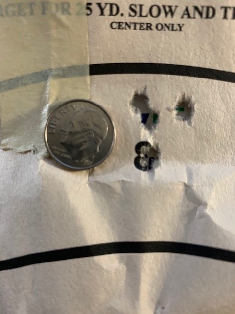

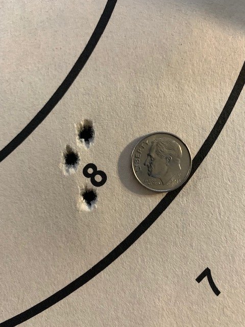

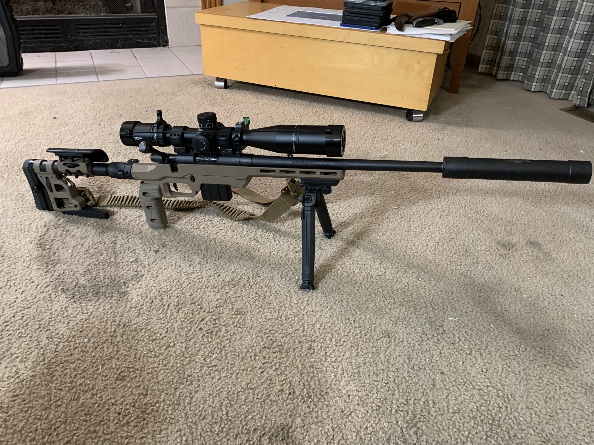

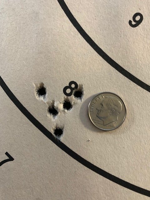

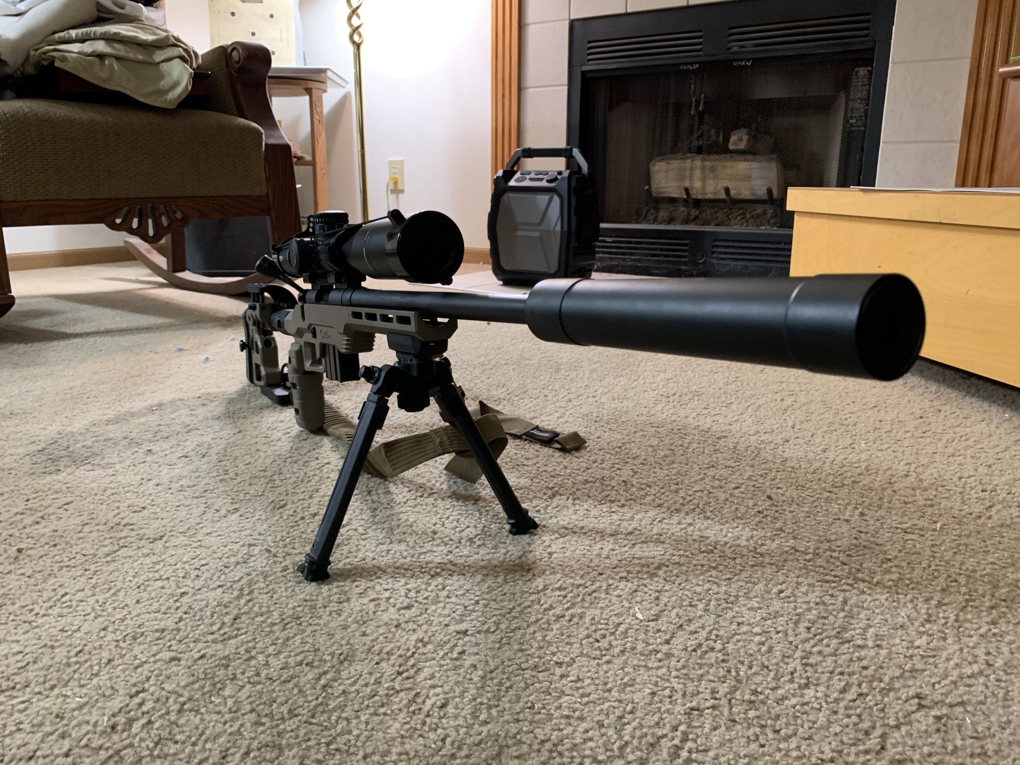

    I took the QB can out for a session today. It's mounted on a Mossberg MVP in 5.56MM. I shot it at 100 yards with some old Samson (IMI) 55 grain soft point ammunition. Prior to this, my groups with that rifle and another can with the same ammo could be twice as large.
    To say that I am impressed is an understatment.
