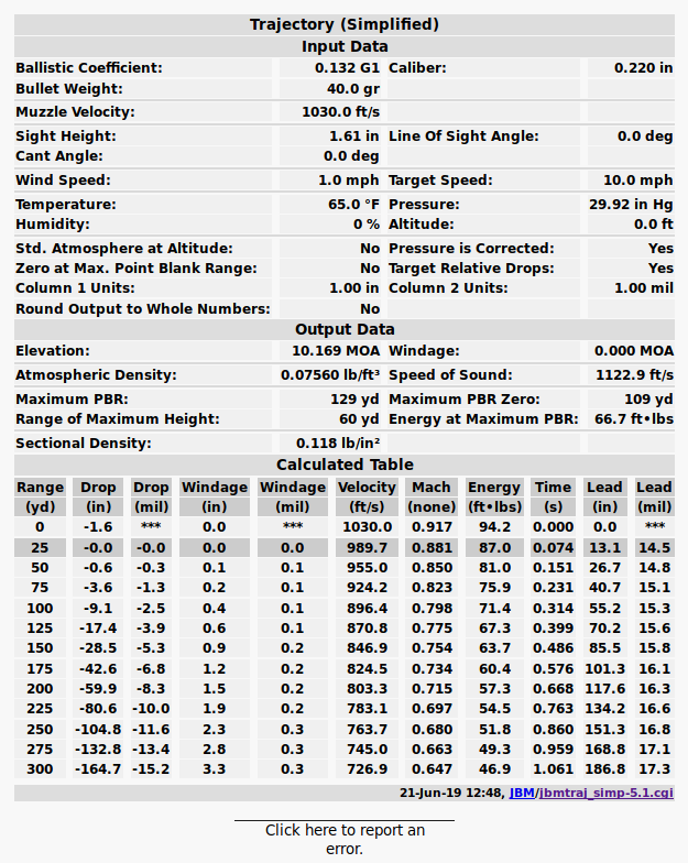

    The issue I had was not knowing the right BC... From SK's site, they had their SK Standard Plus as 0.172 which didn't fit any models. When I plugged in 0.132 which someone else was using, it was pretty spot on from what I noticed in real testing. 0.132 @ 1030 fps

    This is my JBM output using 0.132 and maps pretty well.
