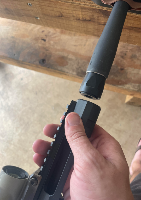

Here's the shitty part. Those PVA barrel nuts aren't going to work. The stock predator barrel width doesn't allow enough forward travel / threading over the barrel to expose the tennon threads for the receiver (pic attached). I don't want to reuse the stock barrel nuts as I have no accurate way of ensuring torque spec. Now the hunt is on for a ruger / tikka barrel nut that will accommodate a barrel diameter 1 1/8 inch some where around 1.1250.
