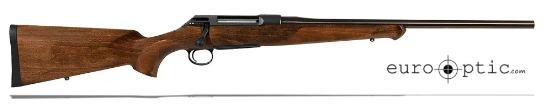

Take a look at this Sauer 100 Classic .222 Wood stock. Weight is 6.7 lbs + scope/rings should wind up 8-8.5lbs. This is a good looking rifle with a nice adjustable trigger for $950.00 If you buy one before Dec 31 you get a Minox 50% off coupon, so you can either add great glass to it at a large discount or sell the coupon.
I will give you $150 for the coupon if you don't want a Minox scope.
So at $800 for this, I doubt you could put something together for less.
Just PM me if you want to take me up on the offer.
https://www.eurooptic.com/Sauer-100-Classic-Beechwood-Stock-222-Rem.aspx
