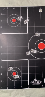

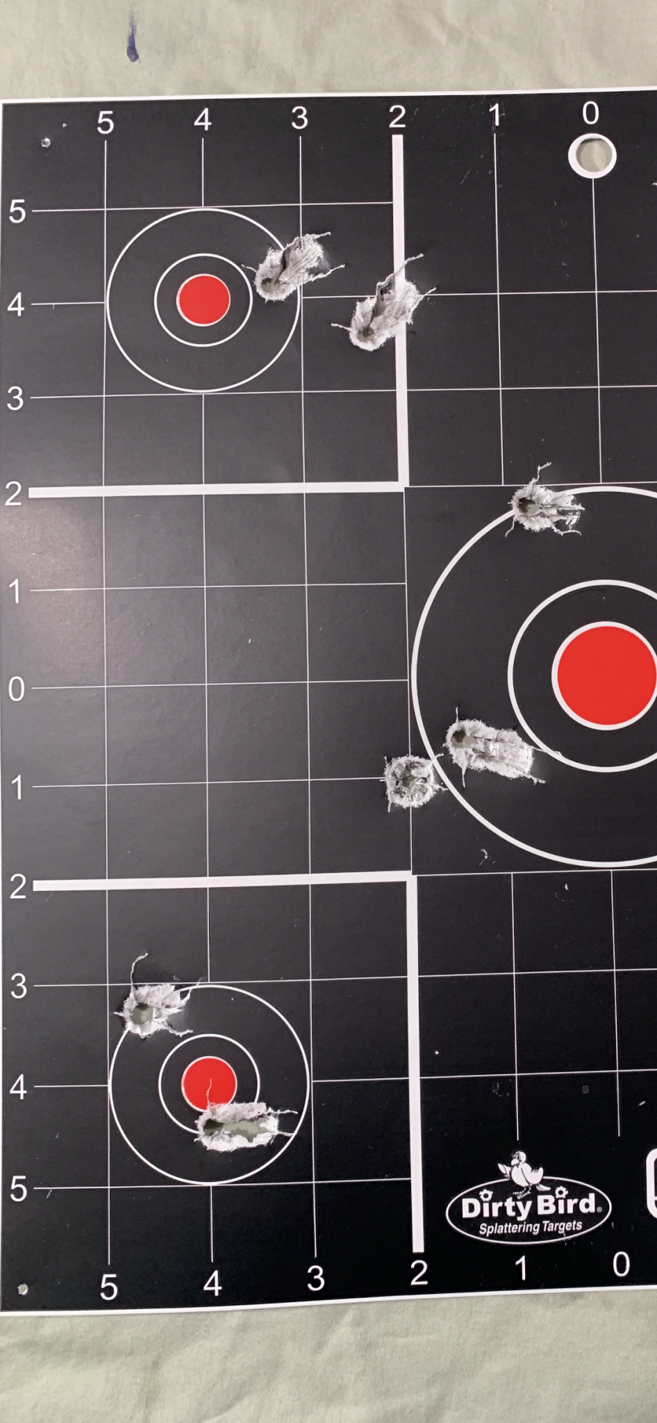

I have a 10” 1:16tw barrel 450 bushmaster bolt action. Ammo I have is some Black Butterfly Maker Bullets 425gr subsonic buzzsaw. Originally I sighted it in suppressed (maybe shot 20-30rounds) no problem.. Fully cleaned barrel.. Just took it out on its second trip. Shot it suppressed again and it was on target 7-8 shots. Then all over the place. I mean some on target, some on target 8-10” off from POA, some not even on paper.
Went to check target and what I’m seeing is the bullet keyholing on some impacts.

This keyholing was at 50yds by the way not 100yds. After I saw the target shown above I stopped shooting them and just shot supers. Weird though how they would keyhole after not doing so the first outing with it and the first couple shots of the day. Just coincidence and luck?
I think I have a better idea now (after a quick bit of reading). First off the barrel itself is really short for 1:16. You are getting just over half of a revolution at that barrel length.
The second problem is that's a 425 grain copper bullet which means it's substantially longer than any traditional bullets of the same weight class.
Longer bullets need more twist to make them work (generalization but for this conversation yes).
You are basically working from both directions. Only half of a revolution to start with and a much longer bullet.
Typically you want at least one full revolution to ensure stability. It's not a 100% or nothing proposal but one revolution is a guideline.
