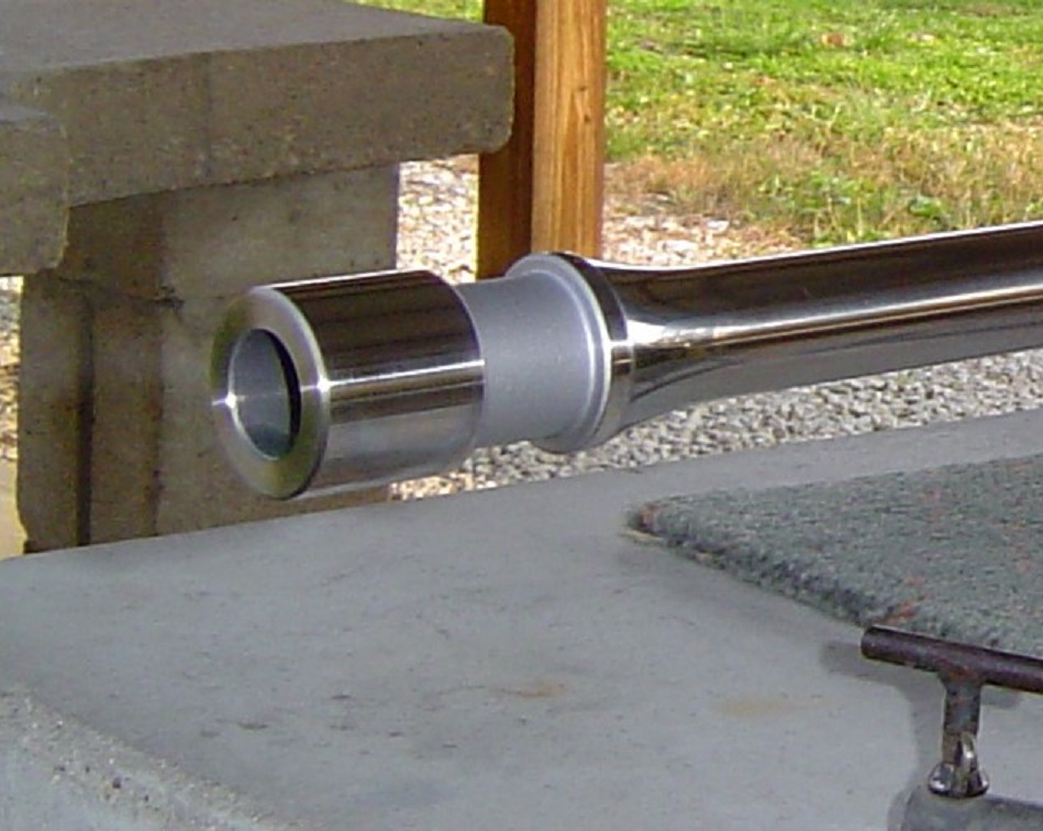

You guys running tuners, do you remove the tuner when you clean your barrel? I have been leery of the thought, and leave mine on.
EC V2, I think by leaving it on, this last cleaning may have bit me in the ass.
I take my Harrell tuner off and clean it everytime I clean my rifle. Have had no problems at all.

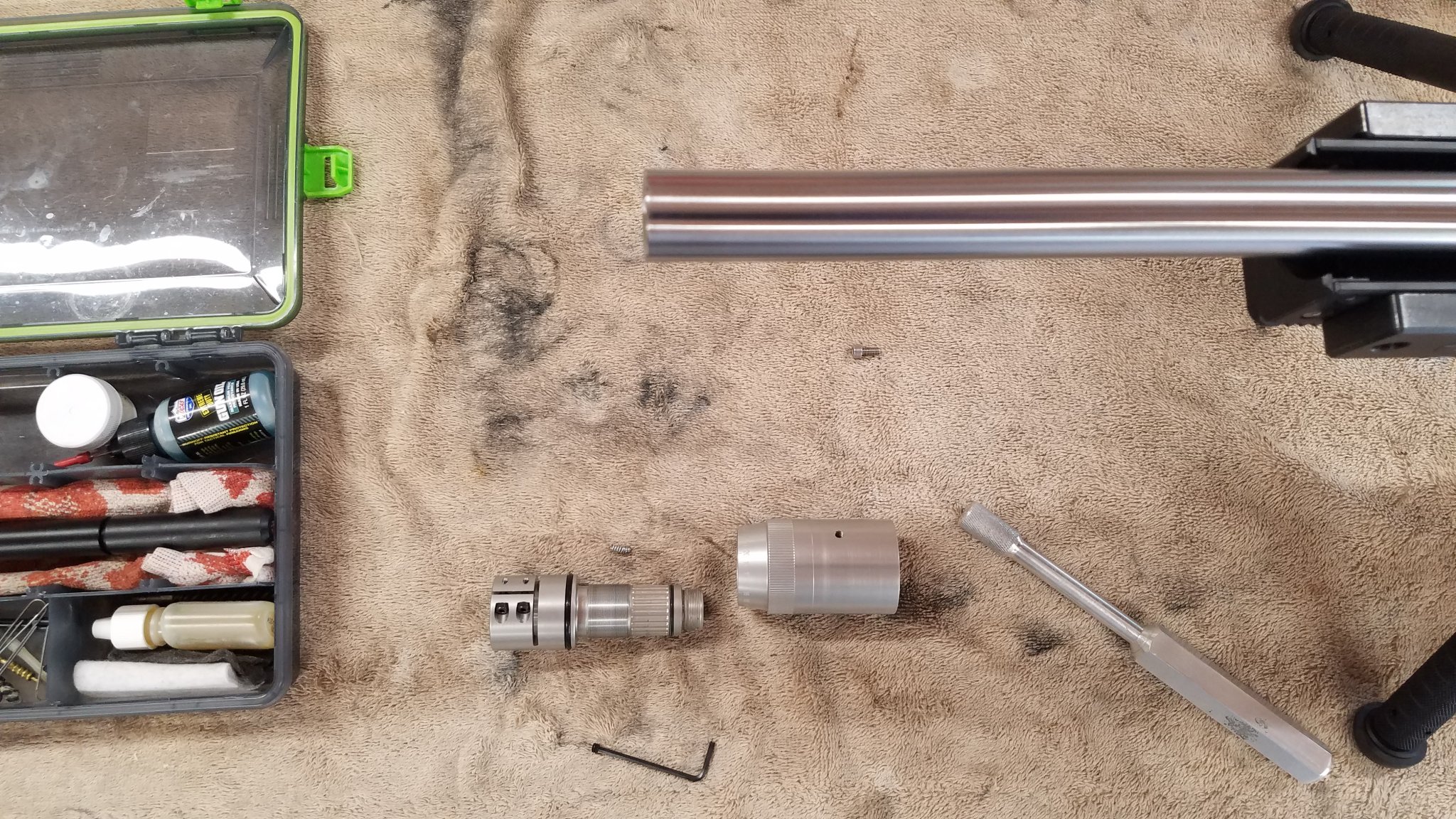

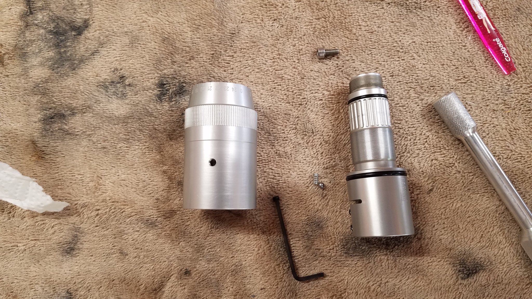

Today was rifle cleaning day. Took my Harrell tuner off and even took it apart to see what it looks like inside.
When I say repeatable....I mean very very repeatable. :cool:

All I have to do is spin mine off with 1 1/16" wrench, I just need to do it and remove the doubt.
What exactly are threads for at the front of the adapter?

The forward threads are often present to add additional weights.

Only place I've seen the add on weights and tubes for the Harrell offered:

As others have said, the threads are for weights and tubes.

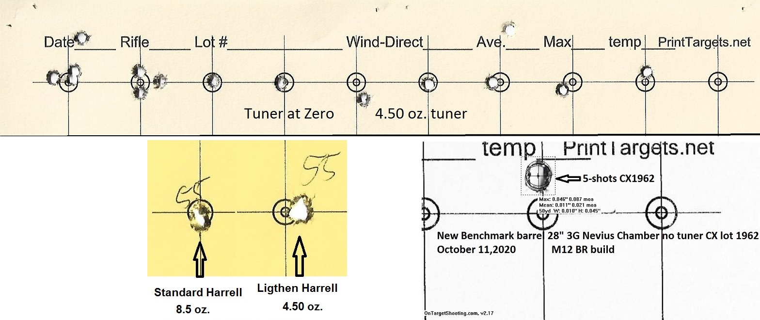

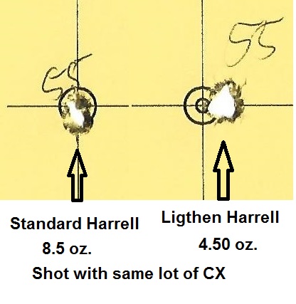

I remove material from the main tuner body or outer barrel of tuner. My reason for doing this is to help the barrel achieve the highest peak in its upward movement. I believe in bullet exit timing when tuning and I want exit to be at the highest point. I also believe in having the correct amount of weight and no more to achieve this. I based this on how ir50/50 sporters can shoot with a fixed weight on the barrel.
Here is what the tuner looks like after being modified. tuner pictured weighs about 4.5 oz. other picture is of an ir50/50 sporter barrel.
Lee
p.s I edited what I do to the tuner as may it have been misunderstood, I was removing material from the rifle barrel; I meant the outer barrel of the tuner.
Lee
Mr Lee,
Thanks for the pictures!! I'm following what you're saying. Am I correct in thinking a lighter/thinner barrel requires a lighter weighted tuner?

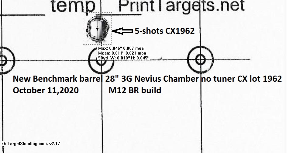

You're welcome. on barrel profiles it doesn't always follow that one or the other means more or less weight. I determine by seeing how it shoots bare barrel. with known good ammo shooting bare barrel will give me two things how it shoots and the natural POI height. knowing the natural POI height IMO is going to help you find a tuner setting with correct exit timing which will give near same or even higher POI.
Here is an example. 5 shot group no tuner POA was centered on the bull below. so, the goal with a tuner is to find a setting that will closely match the natural height of the POI of the bare barrel group. now comparison of shots with a 4.50 oz. tuner set at zero notice the obvious dropped shots as this is not the setting for this barrel. then an interesting comparison of a standard weight tuner and the 4.50 oz. tuner same setting of 55 with same lot of CX shot on the same day. notice the standard weight group is lower and the lighter tuner is higher and closer to the bare barrel group in height. and the most important thing is the lite tuner group is right of POA. the shots are following the natural flight path of the right-hand TW barrel. this is the most important as it tells me exit timing is correct.
anyway, this is how I determine tuner weight. FYI, most weigh in the 4.3-4.6 oz. range regardless of barrel profile.

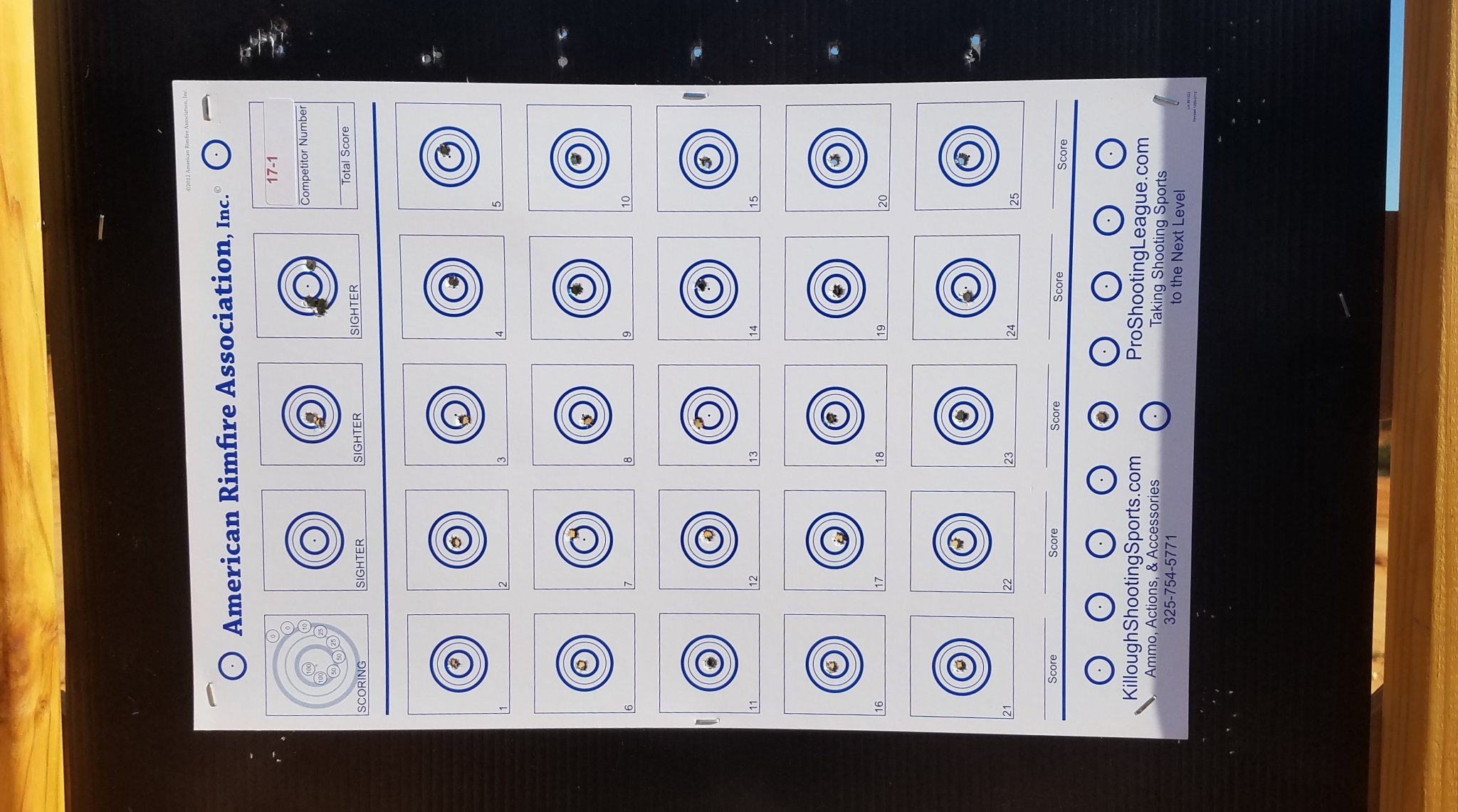

Just wanted to do a follow up on the repeatability of my tuner. As y'all saw, Monday was rifle cleaning day. I took my tuner apart and cleaned it, mostly wanted to see what it looked like inside.
Yesterday I shot our local ARA match. We had the #1 shooter in our state making a visit so I dug into my closet and pulled out a little bit of ammo I was saving for hard times. Up to this point I had only shot ten rounds of said ammo and was very pleased. Used the same tuner setting I've had since tuning my rifle.
Long story short, It shot good for me. I didn't do this ammo justice when the wind started swirling but managed to pull a win over our #1 shooter so I'll take it. I knew the wind was my only chance at a win. We started out with a 3 to 5 mph wind and went into a 5 to 10 mph very switchy breeze.
My final scores were 2250-9X, 2150-10X, 1925-7X, 1825-4X.

Great shooting! for me I have to travel to shoot ARA. so, if there is wind or conditions not usually present, I feel it equalizes any home range advantage.
I just replied to your message, and I have to ask. you sure you want to try another method? looks like your rifle is shooting pretty good.
