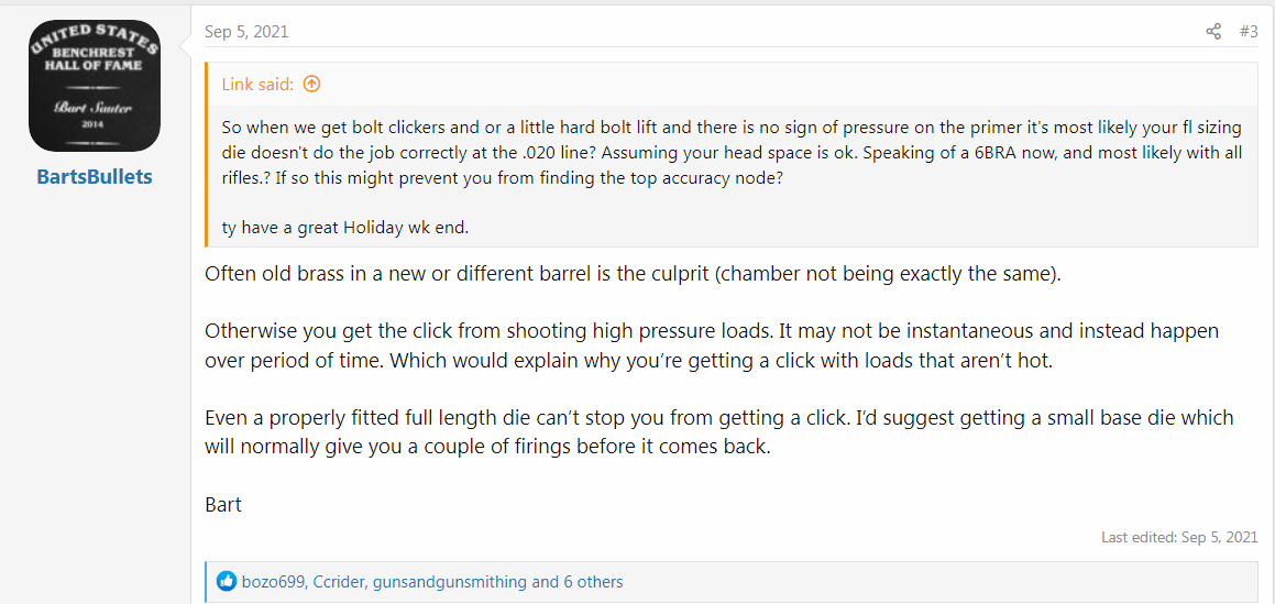

MPA chambers tend to be tight, and the Hornady die is not ideal.

Tight chamber and Hornady die are likely the issue . If you made it that many firings without clickers it's not terrible , but not ideal .

My experience has been that tight (match) chambers allow you to shoot factory match ammo (often sized on the small side, to fit all chambers) surprisingly well. But if you buy premium brass and hand load, that is not optimal, as you lose top end speed, and thicker/stronger brass tend to develop clickers, because the standard FL dies are not fully compatible with the tight chamber.

Quoting a man that knows what he is talking about .
Bart is spot-on with his reply.
