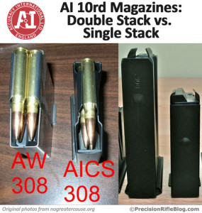

does someone have a few pictures they can share that explain the differences?
The AE takes any AICS pattern mag, which has a staggered stack and single feed(5 or 10 rd). The AX takes the double stack double feed mags(10 rd only). The aics mags should function in the AX.
Snap a pic of the mags. Preferably like the pics are above
The double stack 10 rounder like on the far left above is for AW/AT rifles. The AX is the same design but with a small lip in the front. Those work for the AX and ATX/ATXC rifles
No idea what the AE uses off the top of my head but there’s threads here discussing differences in depth if you search
5/10 round AICS mags suck compared to the legit AI double stack mags.
A 10 round AW/AX double stack mag will be the same size as the AICS 5 round mag
This might help:
