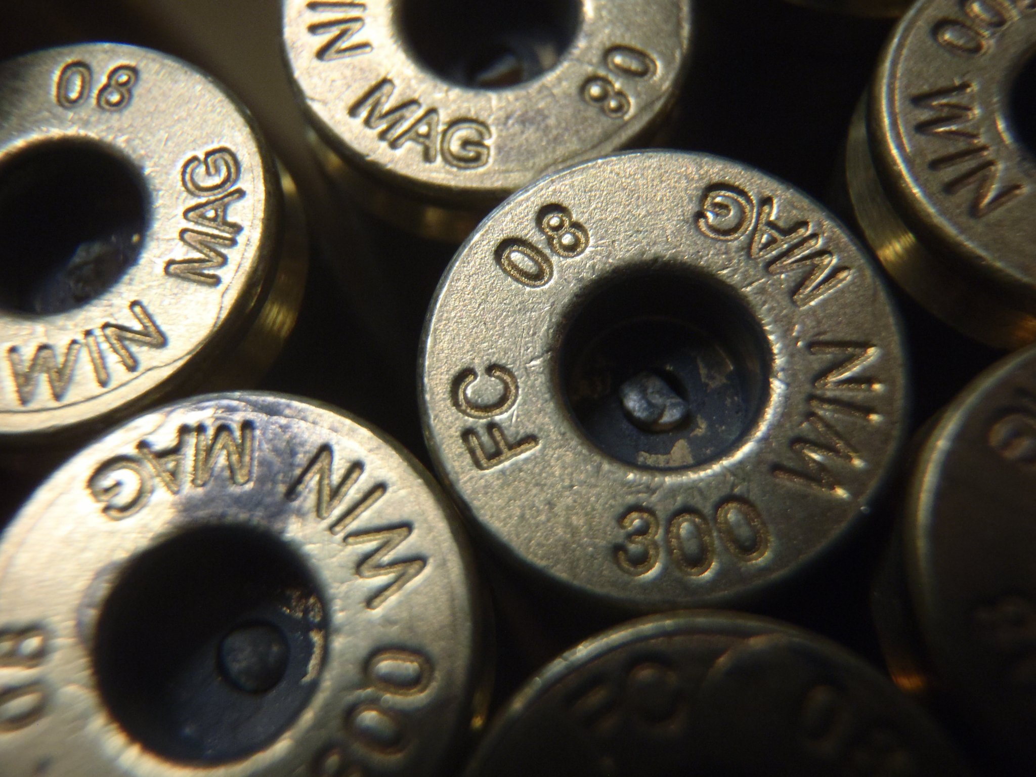

Recently came across a box of 400 pieces of FC 08 300WM brass I bought at least 10 years ago. After sizing with a Redding body die it will not chamber. I will need to buy a Larry Willis collet die to use this brass in a normal 300WM chamber. Out of curiosity I measured a few pieces of this brass and found that they must have been fired in a very loose chamber with most of the body some 3.5 thousandths larger in diameter than the SAAMI max allowable spec. No indication of over-pressure was found with the primer pocket, base or belt diameter.
Just above the belt the brass measures 0.518". Allowing .001" for spring back the chamber probably is something like 0.519" in diameter. SAAMI spec for that spot is 0.5136" with a tolerance of +.002" and I found the same amount of oversize at .2" below the shoulder. The base of the shoulder was in spec.

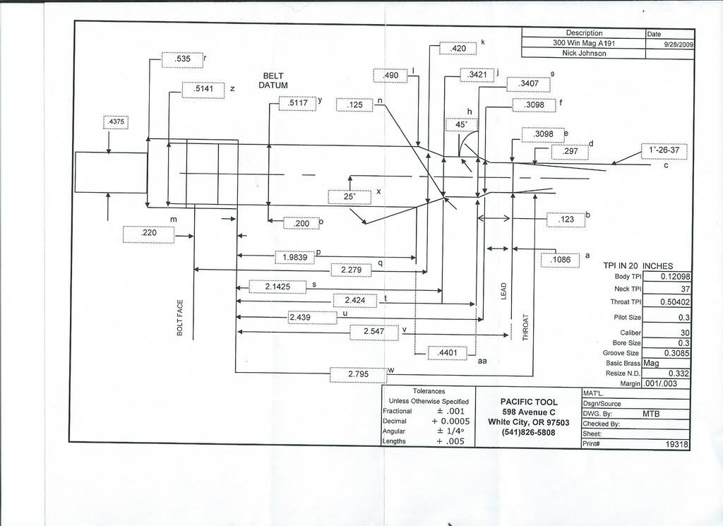

I have that same print. All the information I have found is that this is the exact A191 chamber reamer that was used on the military sniper weapons. The Z dimension .5141 in the top right corner would have to be something like .519 in the chambers these 400 rounds were fired in.

It can depend on when the gun was built and which chamber spec was used…..
I know for fact that at least 3 different reamers have been used…
Saami min spec
The A191 reamer
And Saami spec. +.002” size on diameters! Or what I call a production chamber spec.
Ask me how I know? We’ve made bolt gun barrels and ammunition test barrels in all 3! I was shocked when I was told we needed to make some barrels in the +.002” production chamber spec. That and the Saami spec are horrible when it comes to accuracy. The gun might shoot great…. And it might shoot poorly. It’s the luck of the draw.
As a guess it sounds like the OP has the chamber that is +.002” bigger on diameters if your sizing die won’t size it down properly. Or your sizing die isn’t made correctly or the die can’t adjust down far enough. If you can’t adjust it down far enough take .010” off the shell holder so you have some more adjustment. Wouldn’t be the first time I’ve seen this.

The brass I have must have been fired in chambers at least 0.005" over the saami print diameter. That is why I asked about fat chambers and any modifications that may have been made to some of the rifles. No one here has even heard about those chambers?

What’s the background on the box you bought? Surplus? Range pickup? Any idea where they came from?
