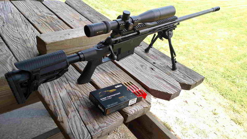

Your 2 savages are great rifles. Had a rem 700p in 300WM (is was a sub-moa in the .8 moa range), Sold and got Savage, better rifle in my eyes. Have 6.5, 300 WM, and 338 Lapua. All are sub-moa, with the 300WM shooting .3 when I do my part. I admit I reload, so factory ammo may be an issue.
Only thing I changes is added rail for Atlas Bi-pod and went to Luth MBA-3 over the FAB G-shock for better cheek fit.
The 300WM is my favorite.

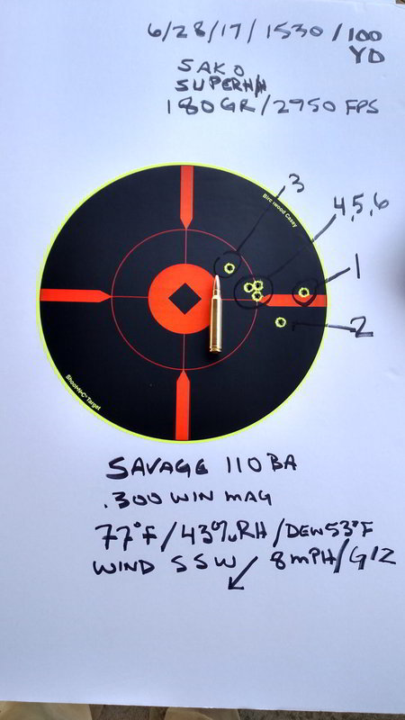

So these are the first 6 rounds through the fatory Savage 110BA Stealth, .300WM, fired for the first time today. Down to about just a tit under 1 MOA. During the range testing, the stock collapsed and the scope, even though torqued properly, moved 6mm forward. I admit that this is a superb rifle for me at my abilities, but the damn AR furniture is getting tossed in the garbage for a MDT or PRS stock. Ammo was 180gr game rounds with blunt (flat) tips. No ballistic ammo was available when I wne t shopping. Will probably run better with something similar to 178gr Hornady ELD or Superformance.
I think that the guy behind the scope is still the biggest variable. Need more training and practice.
