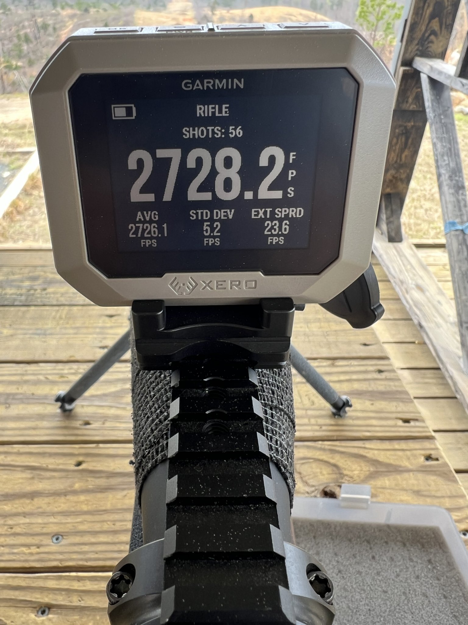

I went with one of Austin Orgains CRB 28” barrels with 1:7.5 twist. Using Alpha 25gt brass with 135 bergers and 36.6 g of H4350. Gets me around 2726 fps. I’m using the SAC modular sizing die with a 281 bushing and 255 mandrel (which is recommended by Alpha). Picture attached is from working on setting up data out to 1275 yards on my kestrel. 56 shots total with sd of 5 and es of 23. Can’t ask for much more than that. I shot my 1st PRS match a couple of weeks ago and was really able to see my hits and misses a lot better running the heavier bullet and slower speed than I was able to see shooting my 6gt. The small amount of increased recoil is not really noticeable during shooting stages. So far I’m loving the 25gt and plan to stick with this caliber for a while.

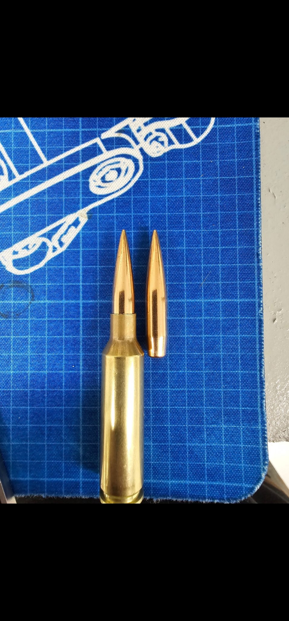

What freebore has been working with the 135s? I see alpha offers 150 or 180 only. My 25 CM has a short freebore and works well but the bullet is stuffed in there to the NeckScreenshot_20240411_140824_Photos.jpg shoulder junction.
What freebore has been working with the 135s? I see alpha offers 150 or 180 only. My 25 CM has a short freebore and works well but the bullet is stuffed in there to the NeckView attachment 8394338 shoulder junction.
I went with the 180fb reamer as I generally start at 30k in load dev and work further back. I shoot the 135 35k off in my 25cm, which has 150k freebore.
